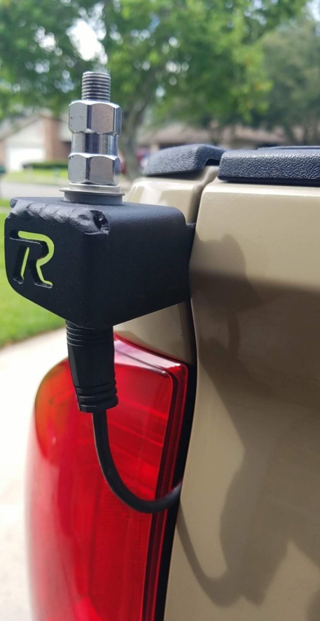

    Im planning on putting a cb radio in my truck after going out wheelin over the weekend with friends. I already ordered and received a Uniden Pro520xl. Im needing to order an antenna/cable, mount, and supposedly some type of connector. Im looking at the Rago Fabrication mount (pictured below). I'm completely new to these but I absolutely hate the style of wire that's used in the picture below. From what I understand there is a lower profile cable/connector I can use. Im not exactly sure if it will work or not. I was hoping someone could point me in the right direction.

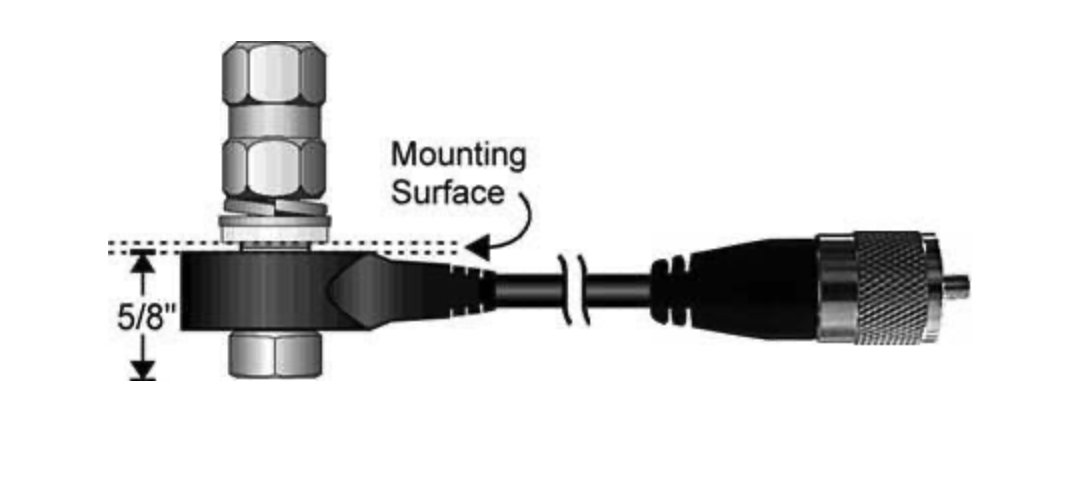

    This is kind of what I was thinking. Im not sure if this style of wire will work with my cb radio and/or Rago bed mount.Screen Shot 2020-10-19 at 10.32.38 PM.jpg

    If you do this yourself be careful as it's not hard to ruin your radio. CB's are nothing like regular AM FM radios and their antenna and cable requirements are extremely important. I had a radio shop install mine - they had an SWR meter and took longer than I thought it would take to get it done correctly. These decisions are not based on cosmetics but on functionality and not destroying your radio.

    You might not like the looks of the setup in the 1st pic but you'll fare much better with it over time then with the FIRERING that you show in the 2nd pic. Take it from someone who's been there! And like VeeSix alluded to, a SWR meter is necessary for an efficient
    CB setup.

    @MikeyD.25 curious why fire ring not as good as good ol coax connector? I just put a fire ring on due to clearance issue (mine is on the hood in a ditch light bracket).

    The fire rings have a very weak connection between the ring part and the wire. Ive owned 2 of them, and both have had the sheathing break right by the ring part exposing bare wires. I still use the fire rings because they fit so well, but its something to keep in mind.

    Don't mean to nit pick but I would have filled the end of that weld.....

    thanks for the heads up! I’ll keep an eye on mine!

    It happens right at the "reinforced" rubbery area. Next time I have to replace mine (probably after winter) I am going to put a few layers of shrink tube over that area to try to beef it up a little more.
    EDIT: this may or may not just be a cold climate issue
