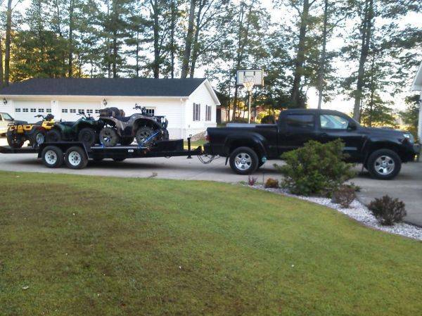

    ^THAT TRAILER WEIGHS 3000 EMPTY! ADD IN THOSE 3 FOURWHEELERS AND I WAS AT ROUGHLY 5000 WITH GEAR ADDED IN. I HAD TO HAVE TRAILER BRAKES AND AT 70 THE FRONT END WAS LIGHT AS HELL! SCARY TOWING.
    OP, LISTEN UP. YOUR 2.7 LITER IS ONLY RATED FOR 3500 LBS MAX!
    http://www.tacomaworld.com/forum/towing/4031-tacoma-towing-bible.html#post35019
    PLEASE READ THAT AND UNDERSTAND YOU NEED MORE TRUCK TO MOVE WHAT YOU ARE GOING TO.
