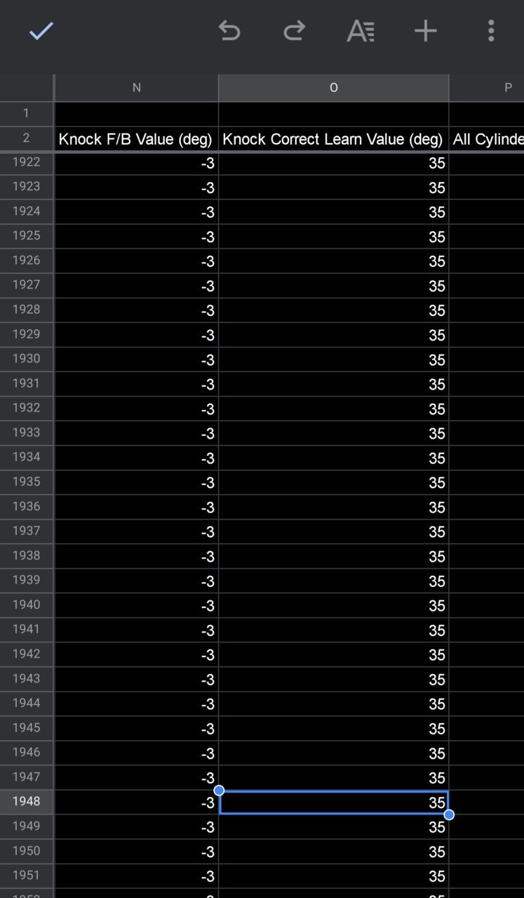

    Can you explain what KCLV and
    K-F/B is from your main Nexus tune post in basic terms?

    Our tunes are pushing 31* and above and running a very consistent of -4 : 0 when the tune is settled.

    seriously curious. This is Greek to me

    KCLV at 35 with Nexus +P Premium running 93 octane :D
