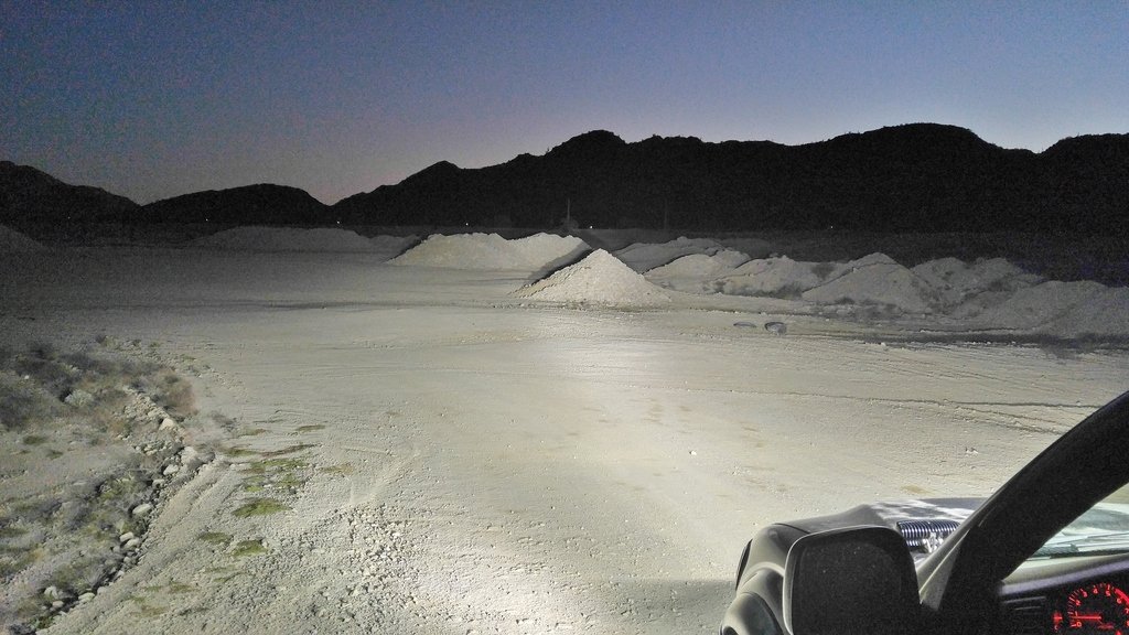

    Here's a gif for better comparison to show difference between 3d and 4d.
    And I took a drive last night. Really not a whole lot of difference. I do have a bit more distance now though. But not like I was hoping for. I would say it almost wasn't worth getting the upgraded one. I do have a slight hotspot in the center now from the 4d spot beam, but only noticeable in short distances. Down the road there's almost no change in my perception of the total output of all my lights combined.

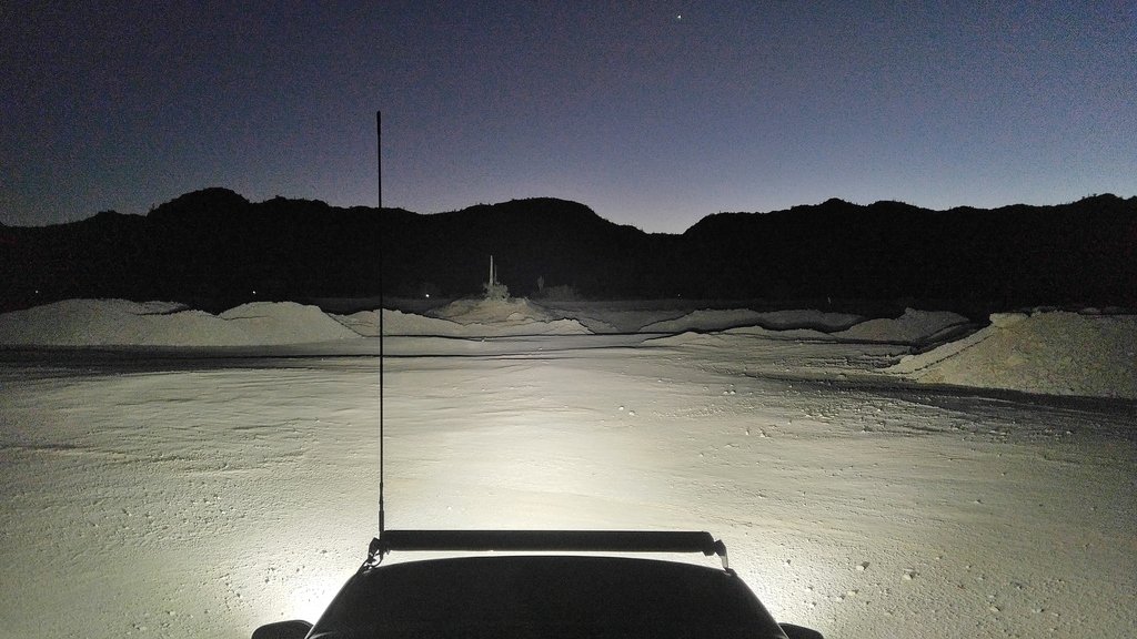

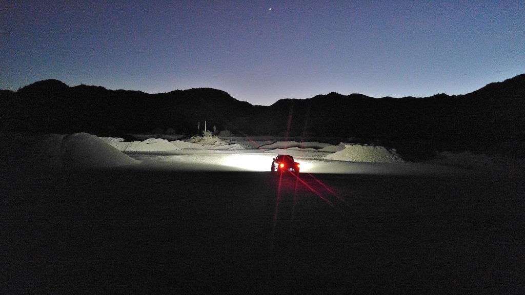

    And for s&g, here's one of the newly designed xpr (12" w/iris reflectors) (that has replaced the evo prime btw), vs the 20"3d
    Not the best comparison using 12"vs 20".. But Just to shows the difference in beam patterns. You can see the xpr has a very nice pattern and is really clean looking. Also has almost no hotspots throughout on the ground in front. A little bit directly below the light. However the 3d beam pattern still blows it away with having much more USABLE light. You can see just how wide the spread is. The spill from those diffused reflectors on the ends really spreads the light straight out to the sides! But it does have a more intense hotspot in front. Certainly not like the camera picked up, and almost none perceived in person. But it is brighter in the center on ground than the surrounding light. Only due to the nature of those 3d lenses in front of the led whereas the xpr uses no lenses so the light has a much better spread.
    Also for some reason the camera seems to have adjusted itself to capture it as a kind of yellowish output on the 20" bars. I hadn't realized until it was too late. But it does output a more 5k kelvin color. The xpr puts out a very nice 6k for the spread, but strangely the spot beam in center has more of a 5k.
    slowed it down a little to see the details better

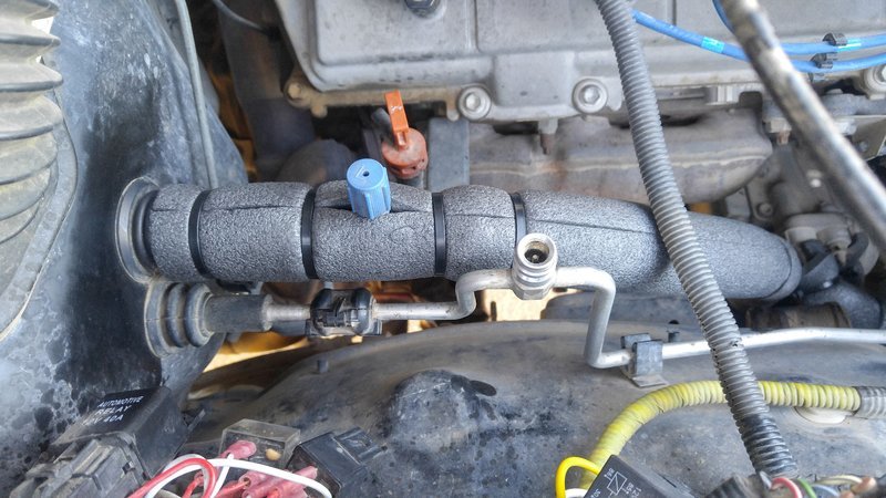

    Changed spark plugs to densos. Last time had all ngk. Anyone run 3 of each? Make any difference? Seeing as I've heard they come like that from factory... I'm sure this has been debated, but haven't looked into it. Also put in ngk wires.
    Ordered af and O2 sensors.. Also a blackvue dash cam.. And an R2C conical filter for my h.a.i. :D See if it's any better than the Donaldson powercore G2 filter I'm running now. Have a suspicion that it's a lil bit restrictive.
    Properly vacuumed my a.c. too. After replacing the Schrader valves as well as an o ring. Also put this foam insulation on the low side. Member said it helped a lil. We shall see.

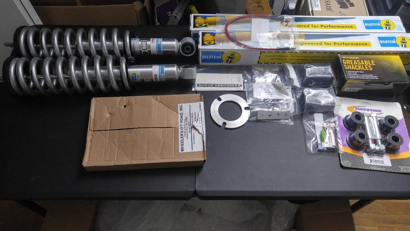

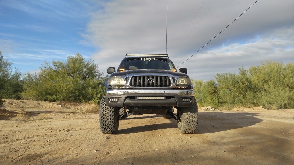

    Ordered up all new suspension the other day. Finally getting rid of of my crappy spacer lift that was on since purchased.
    5100's. Eibachs. Dakars. Greasable shackles and main eyes. brake prop bracket. ext brake line.
    Hoping I'll be able to get in on the current Demello front plate bumper action too.

    Got (most) of my kit in today from wheelers!
    BUT , little bit of a rant regarding ups shipping.
    Got everything but the dang dakars... Was an issue with shipping. But was an error mostly on ups, and a bit of my own I suppose. Delayed due to "operating conditions". Whatever that means. Actually it means the driver forgot the other two packages is what. Even called ups and dealt with a hard to understand foreign lady and that's what she told me. Couldn't even tell me if they were at the sorting facility or at one of their hubs. In hopes I could go pick them up.. Nope. Fucking ups. Sigh. Was hoping to get everything installed tomorrow:( Now it's gotta wait. Had to get my shift covered at work for Saturday(as I work weekends) and that's no easy task for me either.
    Apparently putting in "Rd" instead of "Dr" for the street, caused issues. Which I'm unsure of what it actually is, as there's no street sign, but apparently it's "Drive"... Yet one package arrived and tracking stated the address was corrected. And other two were delayed and would be rescheduled for delivery.. Never had any issues before..
    Wheelers then gave me a call confirming everything I just went through and were very apologetic. Michelle was really nice and knew exactly what was going on as she had already looked into it (same time I was probably). And wasn't but maybe 10 minutes after I got off the phone with ups that she called. She also said they were trying to charge an additional $13.50 PER package ($40.50 total) in shipping. Because of the shipping address error. Like, wtf. Ha. She said they validate before shipping too. So she insisted on fighting the additional charges and really didn't wanna have to charge me more, even though I told her it would be fine and would pay it no problem. But I've been EXTREMELY impressed with wheelers, from my first phone calls and quick email responses, to looking into the shipment issues and trying to fight the additional charges. Freaking awesome service.
    But I didn't think that the street suffix would cause all that hassle! So, I should be expecting the leafs On Monday. But I won't have time again to install for a couple weeks Probly. I could do the fronts, but I'll just wait. Just gonna work Saturday.. Gotta take it to my brothers house for install.
    Sigh Oh well. Not THAT big a deal, shit happens.. But that was my morning. On top of only getting 3.5hrs sleep. Yay!

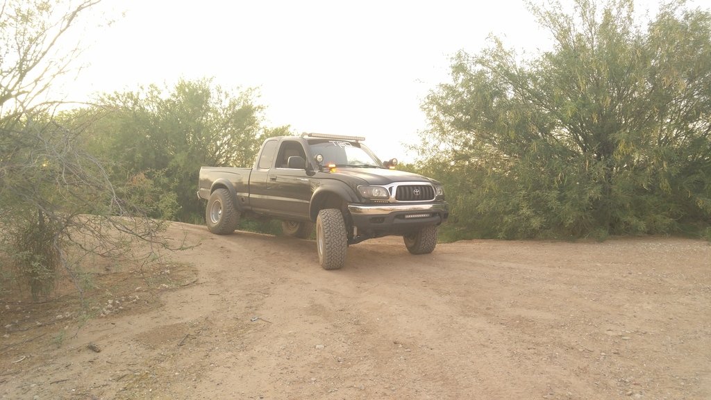

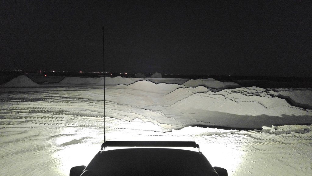

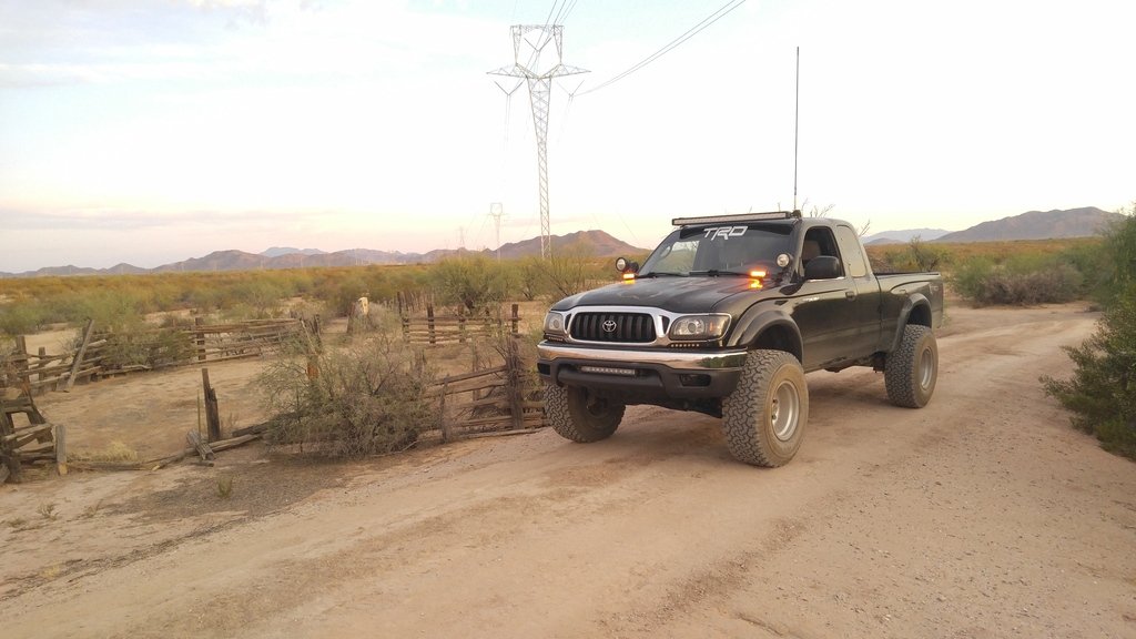

    Castin some shadows after some time at the range. Found this great spot. Been here before but was pretty barren last time. They've done a bunch of dozin since. Lots of mounds and junk for some good shots. Took these kinda quick with my phone. Gonna have to bust out the actual camera one night out here. Wished I had a friend to take some professional shots with a dslr. Oh well, these came out pretty good, even tho it wasn't pitch black out yet.

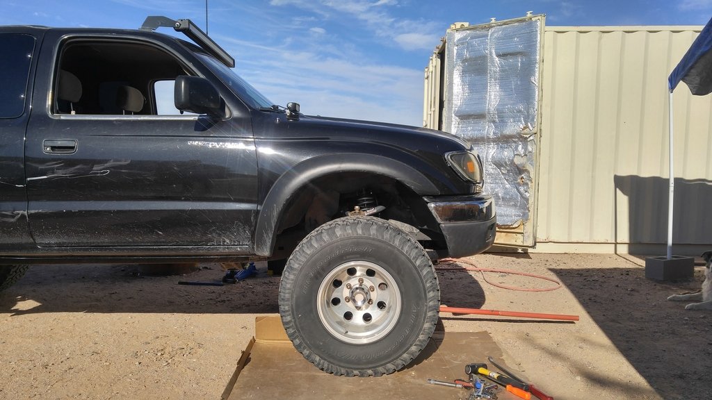

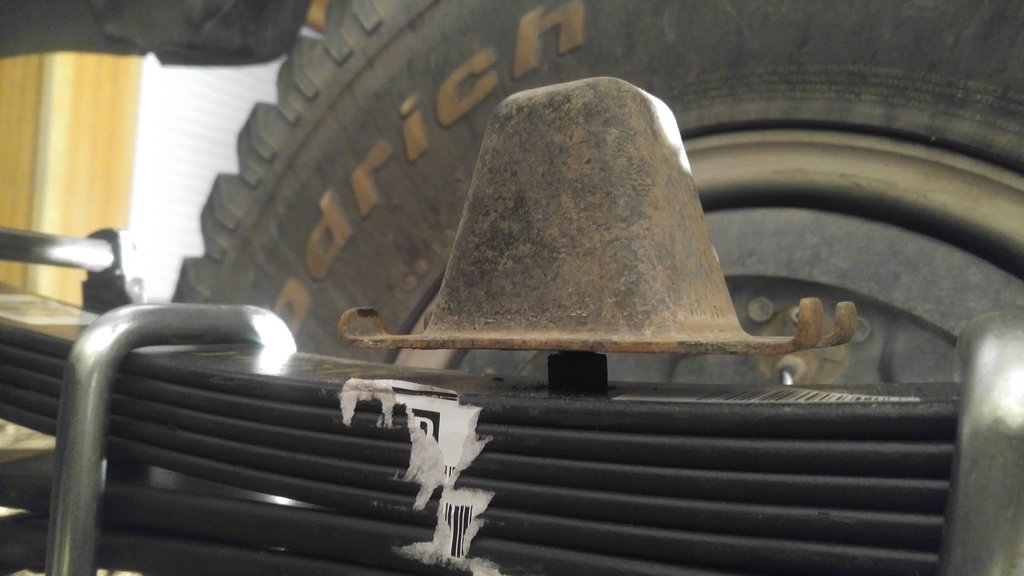

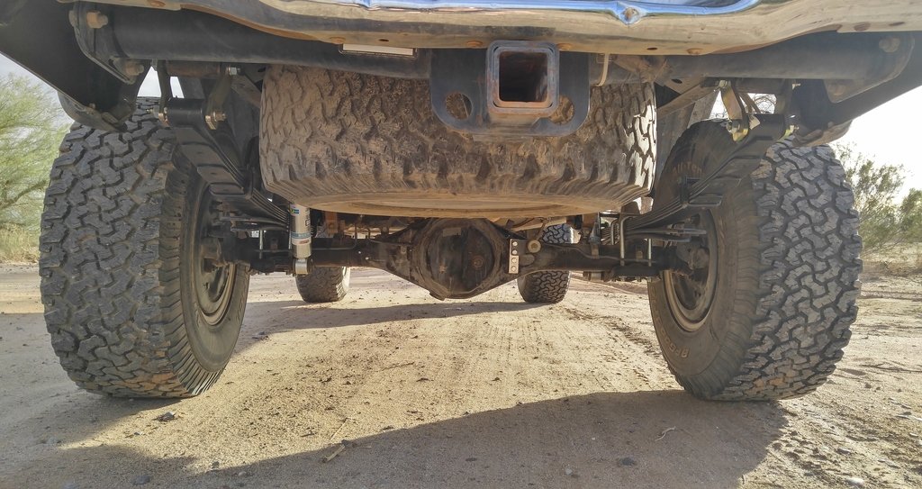

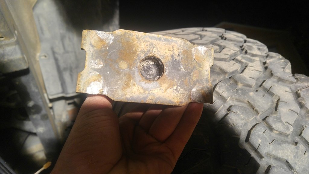

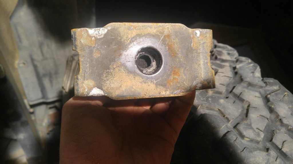

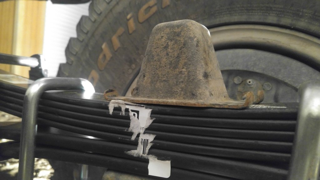

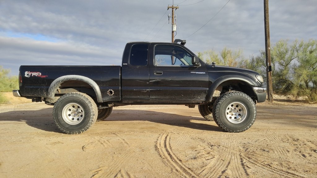

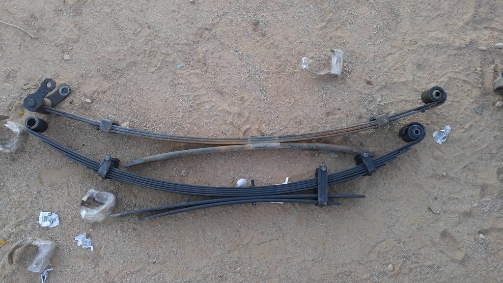

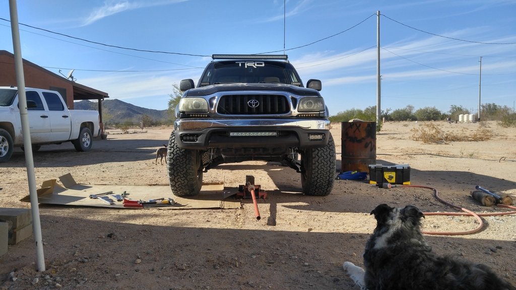

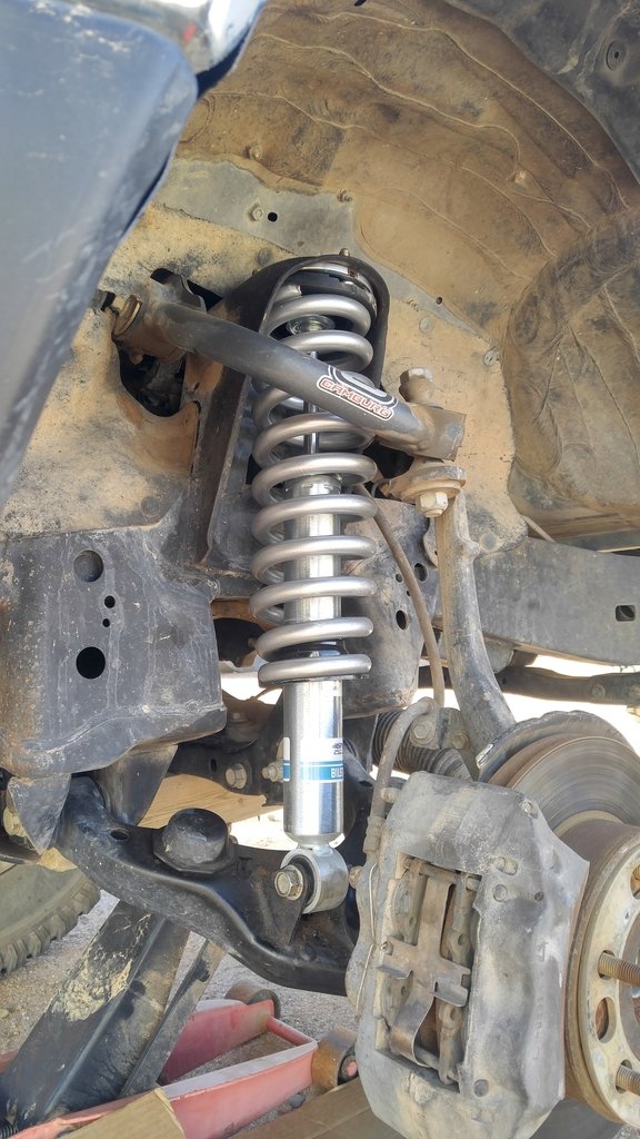

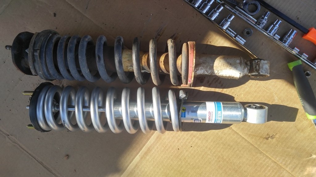

    Welp, took almost God damned day to gitrdone, and still needs a lil work, but lift is installed! 5100's all around w/eibachs and dakars, and extra goodies but not all yet. Didn't take a ton of pics. But will post up some better shots later..
    (And a heads up... please excuse my filthy truck, i've been neglecting her:oops:)
    What a job tho... Ugh. Glad my bro was there helping. Ran into quite a few issues. Took me like, idk, 11 hours. 12 total but Turkey dinner was an hour of that at least. Took our time. Especially me once I was on my own as he helped me for like half the time. We started at 11:30am. After he helped my place the leafs in position, he turned in at 6pm then I was on my own. I left his house at 11pm. Ha. Searched and searched for a lost shock washer. Finally was about to give up for the night but found another big washer that worked. So decided to push on and finish.
    Issues:
    -One lower ball joint mount bolt was finnicky going back in. Finally got it to go in. Threads got a little buggered up removing that one for some reason..
    -didnt press out front leaf bushings yet as I got greasable main eyes(will do later)
    -lost a shock mount washer(used a regular big washer)
    -one nut on driver side ubolt wouldn't come off, had to torch cut the ubolt off.
    -had to fight with my grease gun
    -snapped a zerk fitting
    -stock leaf bumpstops wouldn't fit(drilled out some of the rubber) but will Probly get proper ones later if/when I do shock relocate. For now they're fine and don't think they'll even touch. Ha.
    -installed rear shocks on wrong sides
    -didn't bleed brakes, squishy pedal, will fix and adjust rear brakes later
    -need alignment big time(didn't think it would change that much but it's not driveable atm, will take it in probly Monday)
    She's actually sitting pretty nice! I was surprised. At first, with side by side comparison of old vs new struts, I was thinking I'd lose height! But the coils are so stiff it's pretty much maxed out up front. Also surprisingly, it is a lot smoother than I thought it'd be! Certainly way better than what I had. All my shocks were completely toast, especially the rears. Lol. Could plunge em in and out like there was nothing inside. Ha. The rear also lifted just about right. Didn't really look at it yet, but I think it's sitting lower in the rear, but still higher than it was I think (I Took before measurements So I'll post up some numbers later). So with my plate bumper I'm hoping it'll level out. Feels nice and smooth out back. Front as well is really nice. But being pretty much maxed out, it slams a lil over drops and is quite noticeably stiffer than rear. Only did it once going slow over a cattle guard with a drop in it on the end.
    About ~8 mile drive home though and some of that was really rough. From a washed out creek pass road with a big dip and big rocks, to rough asphalt breaks, to a deep/tight dip in street that I used to really dip/hop through at speed. All was super smooth. Before it was literally like riding on bricks. Now every bump is hardly noticeable. I'm sure most of that is due to my old shocks being beyond bad, but also never having drove/ experienced anything smoother than this. I can't imagine how some people's rigs are with better setups than this. Must be like floating on clouds. Because I think mine is nice, even for a truck. And it's only gonna get better. Albeit only slightly..
    Anyways, I'm really happy. Even though it was a major pain. But being my first time installing stuff like that was against me as well. Looking forward to more mods!
    Also removed the sway bar. Hard to tell any difference so far tho with these heavy duty coils. Will see when I button the rest down and hit up some trails!

    3,489
    Harlan
    Maricopa, Az
    '01 Prerunner, '16 trd4x4, '03 cbr954rr, '03 rc51

    After new lift
    some rough measurements, tried to find a level spot.
    Before with spacer lift:
    Front
    Driver-39 1/4"
    Pass.-39 3/4"
    Rear
    Driver-40 1/4"
    Pass.- 39"
    After new lift:
    Front
    Driver-40"
    Pass.-40 1/4"
    Rear
    Driver-40 1/2"
    Pass.-40 1/2"

    Got my alignment all corrected. Had to take it back a second time. The first time they did't even touch the camber and only adjusted the toe. NEVER going back to Big-o. They gave me the run around and tried telling me the first time the camber couldn't be fixed. Bullshit. Took it today and demanded they redo it. All seems good now.
    Gotta order up some new slug adapters for the camburg uca's. Looks like that's the culprit for my play in the spindle up top. That's what camburg stated in their reply when I sent them the video. $50 bucks a pop. ouch.
