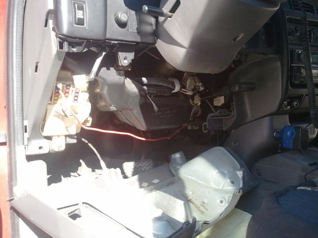

    Remove the four 10mm bolts (red circles) and the Phillips head (red box) screw on the panel below the steering wheel
    The panel will pop off now, I found it to be easier to just leave the hood latch cable hooked up, let the panel rest on the floor

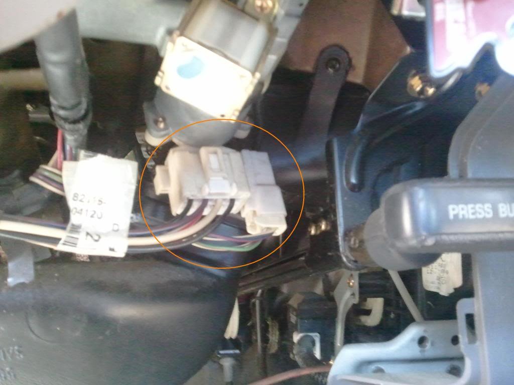

    Locate the two plus like the ones in the picture below (Note: the plugs may be blue)
    Step 3:

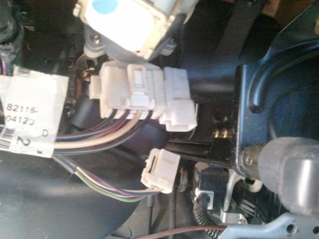

    Unplug the the smallest of the of the two plugs and that's it no more chime
    Reassemble the panel and you're done :D
