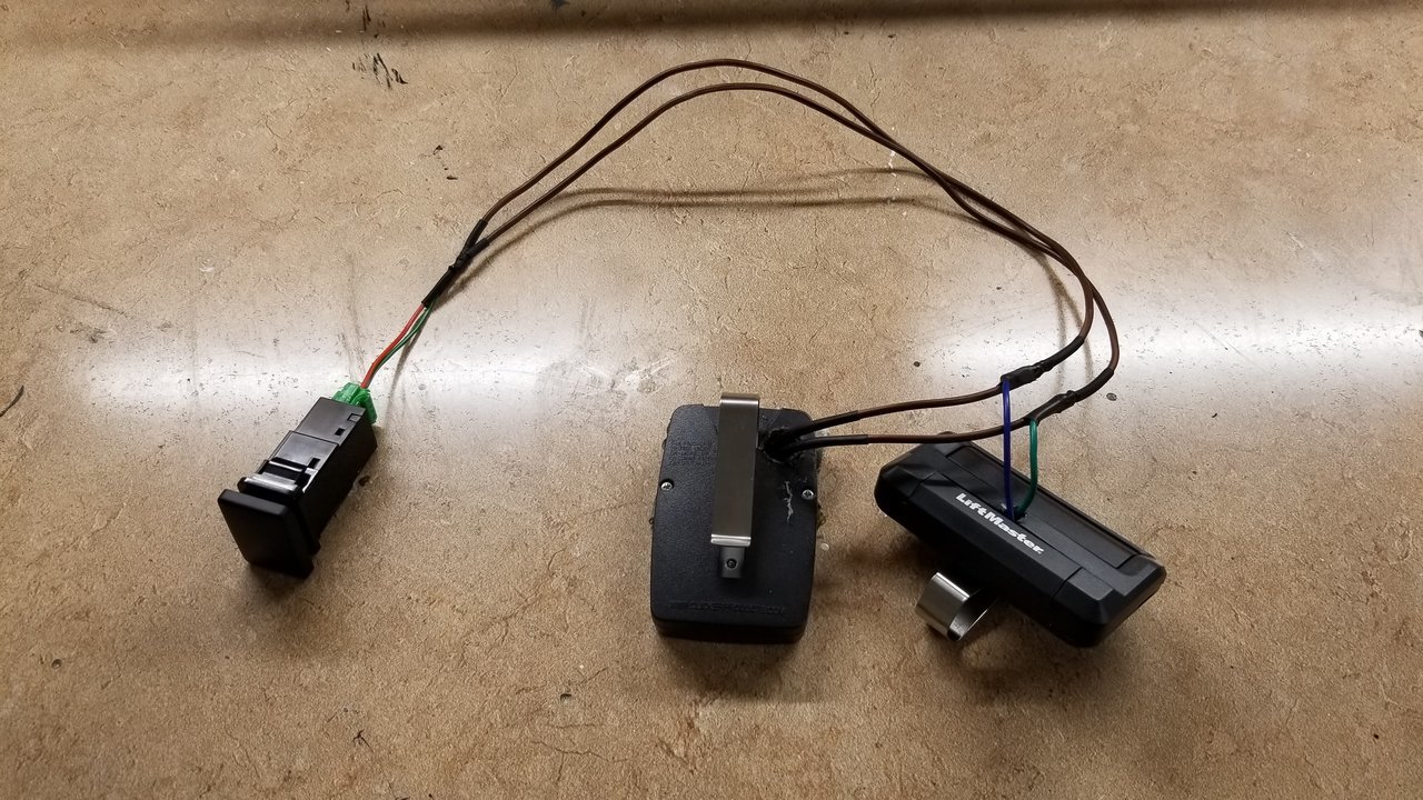

    So forany wiring gurus, I could use some help. I've done this mod for my home garage door opener. We now have an electric gate at work that uses a similar opener. Can I wire two openers from one switch without catching anything on fire? If so how? Or is there an easier way? Thank you.
    Edit: I did this and it seems to work. Should I keep the fire extinguisher handy?

    as long as you've wired in parallel and not in series, you should be fine

    How would I find out which way I wired it? I figured it's all pretty cheap to fix so I put both batteries in and it worked no problem. Does that mean I got lucky and they're in parallel?
    Edit: I tested with a multi meter and the brown wire with the blue lead goes to both remotes positives, then the brown wire with the green lead goes to both remotes negatives. I looked around on Google and it looks like that is in parallel. Would that be correct?

    Yes, the way you had it in the photo is in parallel, that’s the nice thing about electronics and electrical. Generally they will let you know right away whether you’re right or wrong, LOL ( with the exception of softly overloading a wire or breaker,

    Awesome news! Yea I figured if something was going to go wrong it would've with me testing it on my concrete garage floor haha. I just tested it with both batteries in and held the switch for about a minute. No sparks and no wires got hot so that's awesome. Thank you so much for your help!
