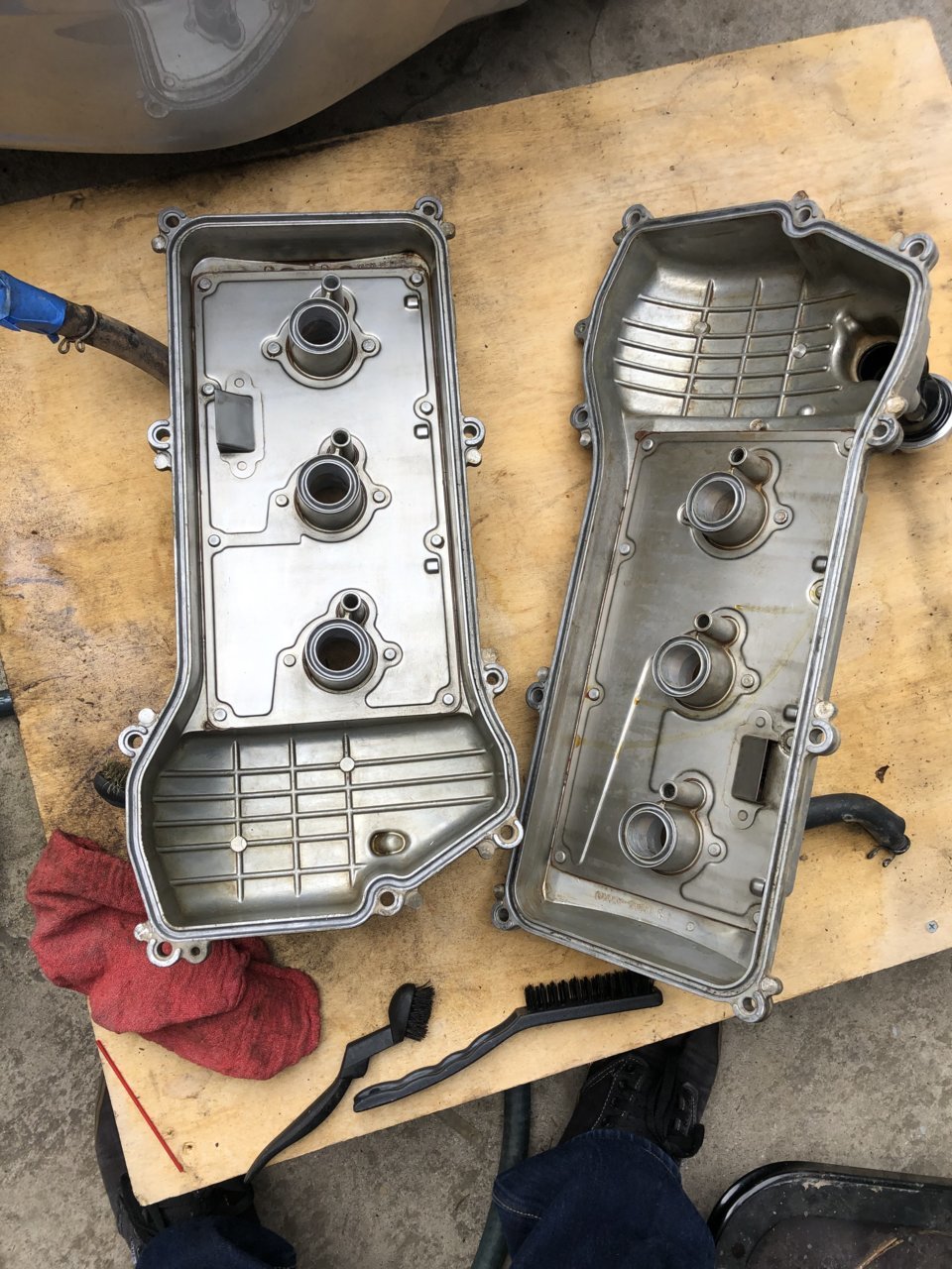

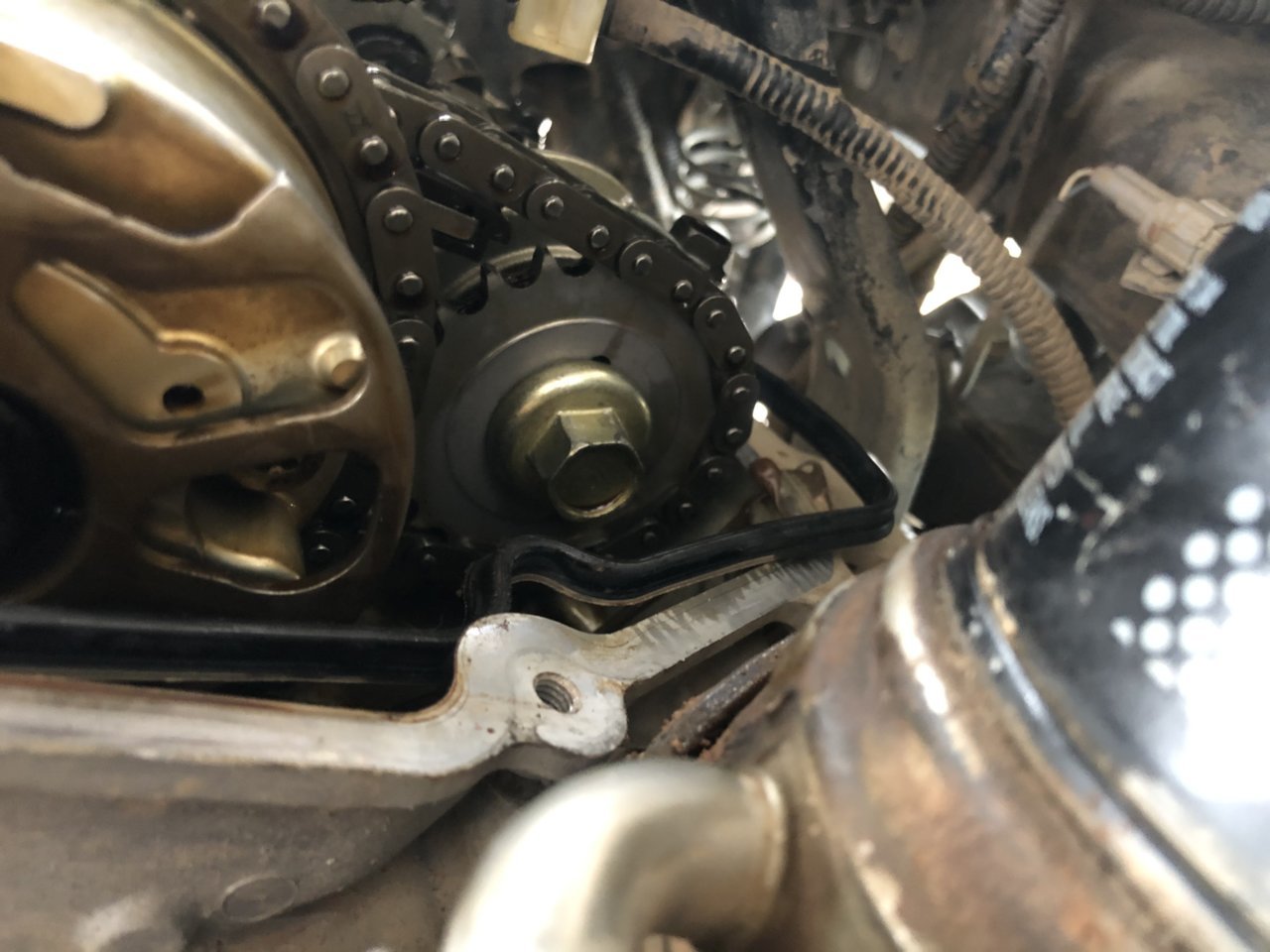

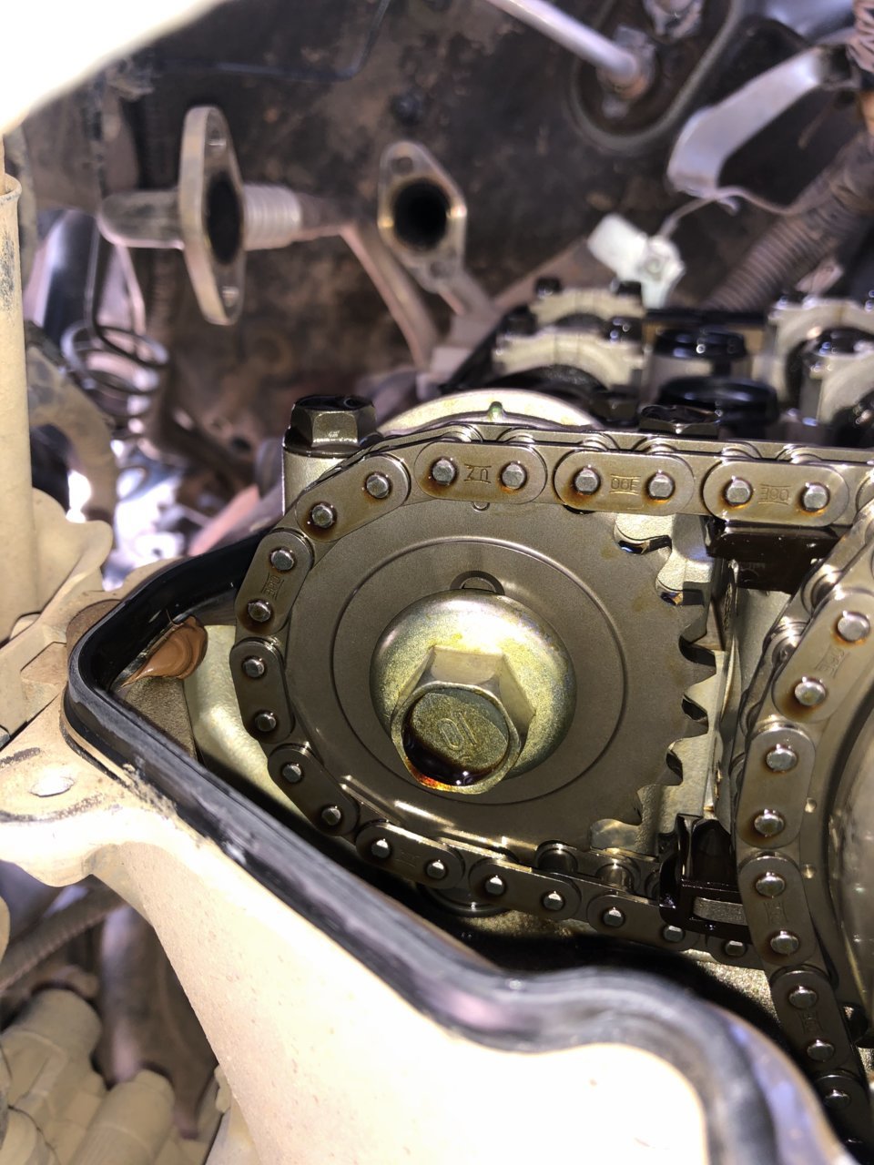

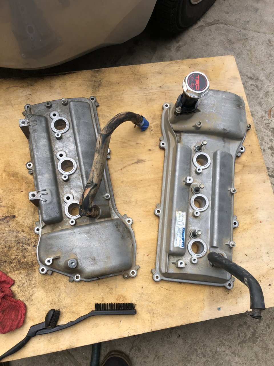

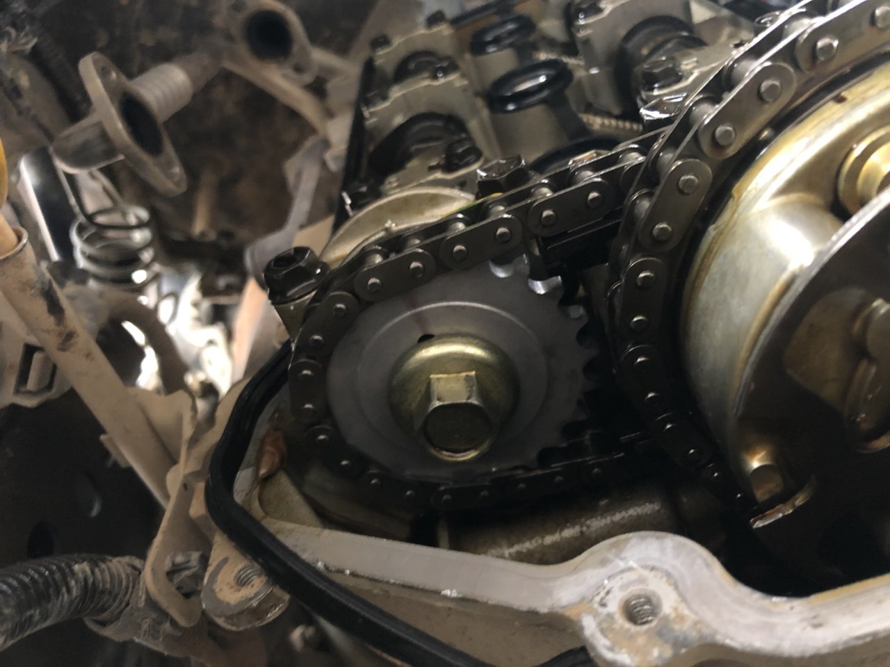

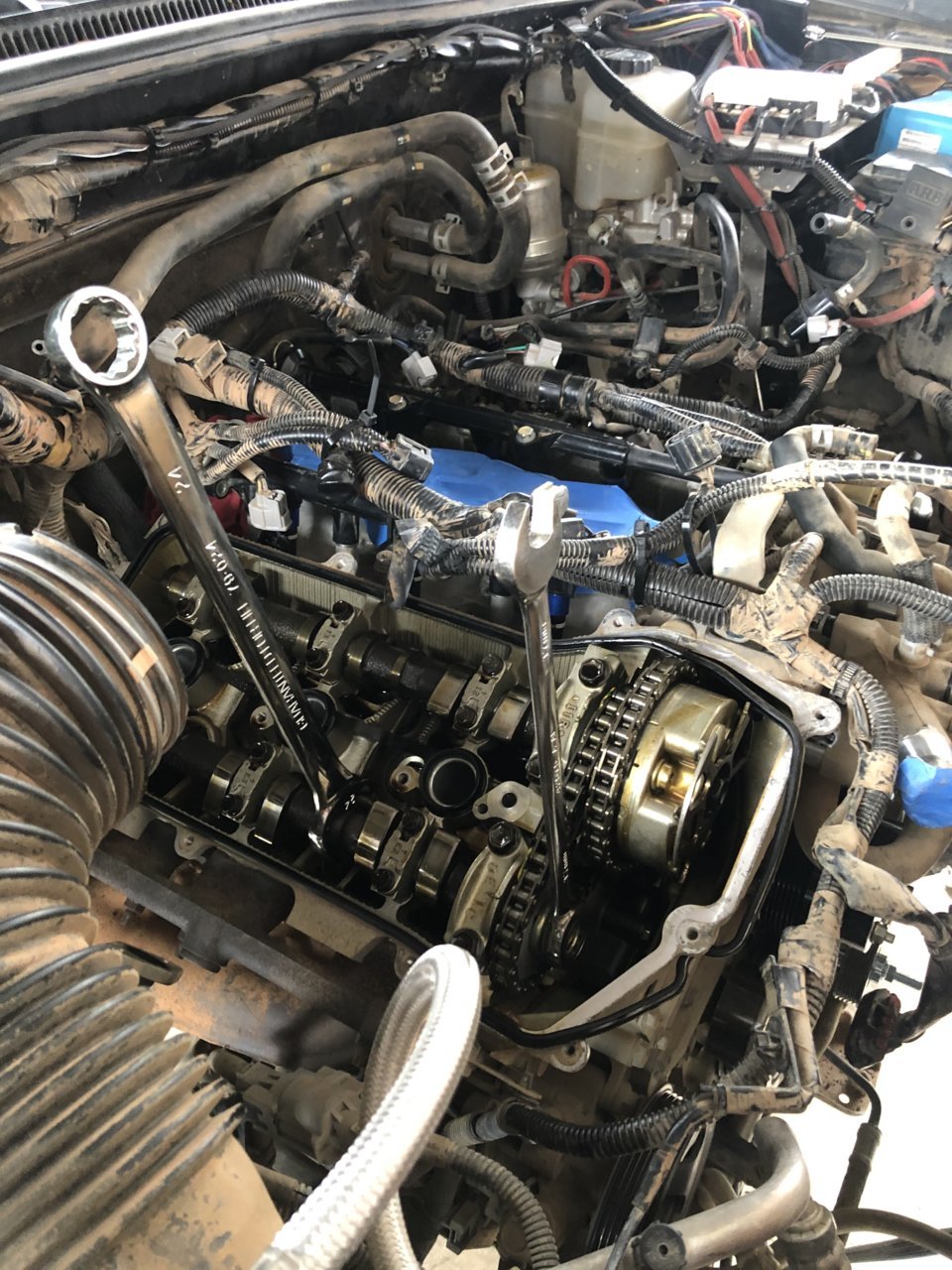

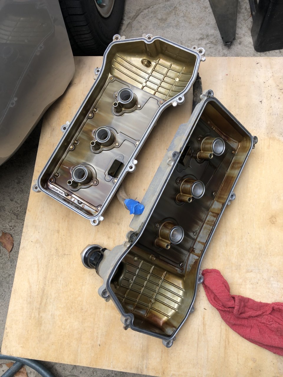

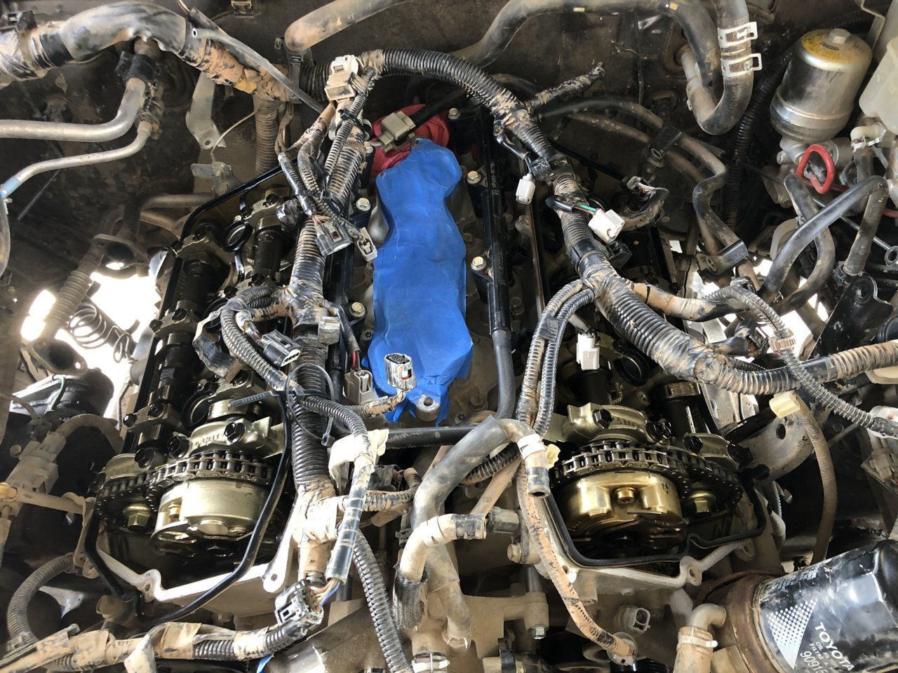

    Decently productive day yesterday. Swapped in water pump spacer for the SC, swapped out the cam gears for @mightytacoman 3 degree retard setup, cleaned the valve covers and swapped the plugs for the new colder Denso’s for the SC.
    Did not snap a photo but ECU also arrived back form @JustDSM with a fresh TRD SC tune flashed onto it.
    7E376B3E-9FA0-437A-8D3E-70EE378B4A3D.jpg D912D361-F3F9-4CF9-A22C-496A09FACD38.jpg 39E55284-9D03-4299-BB4A-6BF56844E230.jpg 4ECA747B-5933-4621-9D2B-AF83473ADBA0.jpg 6803CE2A-E1DF-4878-A751-29479A0C02B9.jpg 63415E9F-D803-496B-BD2C-D3F35EBA4C70.jpg BF969D4B-54FD-46E9-B260-7B8D9D6FB934.jpg DD12CC45-00CA-4367-A339-6773CFDBEDDD.jpg 3735F993-0333-41EB-9805-BA2E7E007390.jpg 2736E691-331C-4619-AE2C-4B99A7A0E83B.jpg

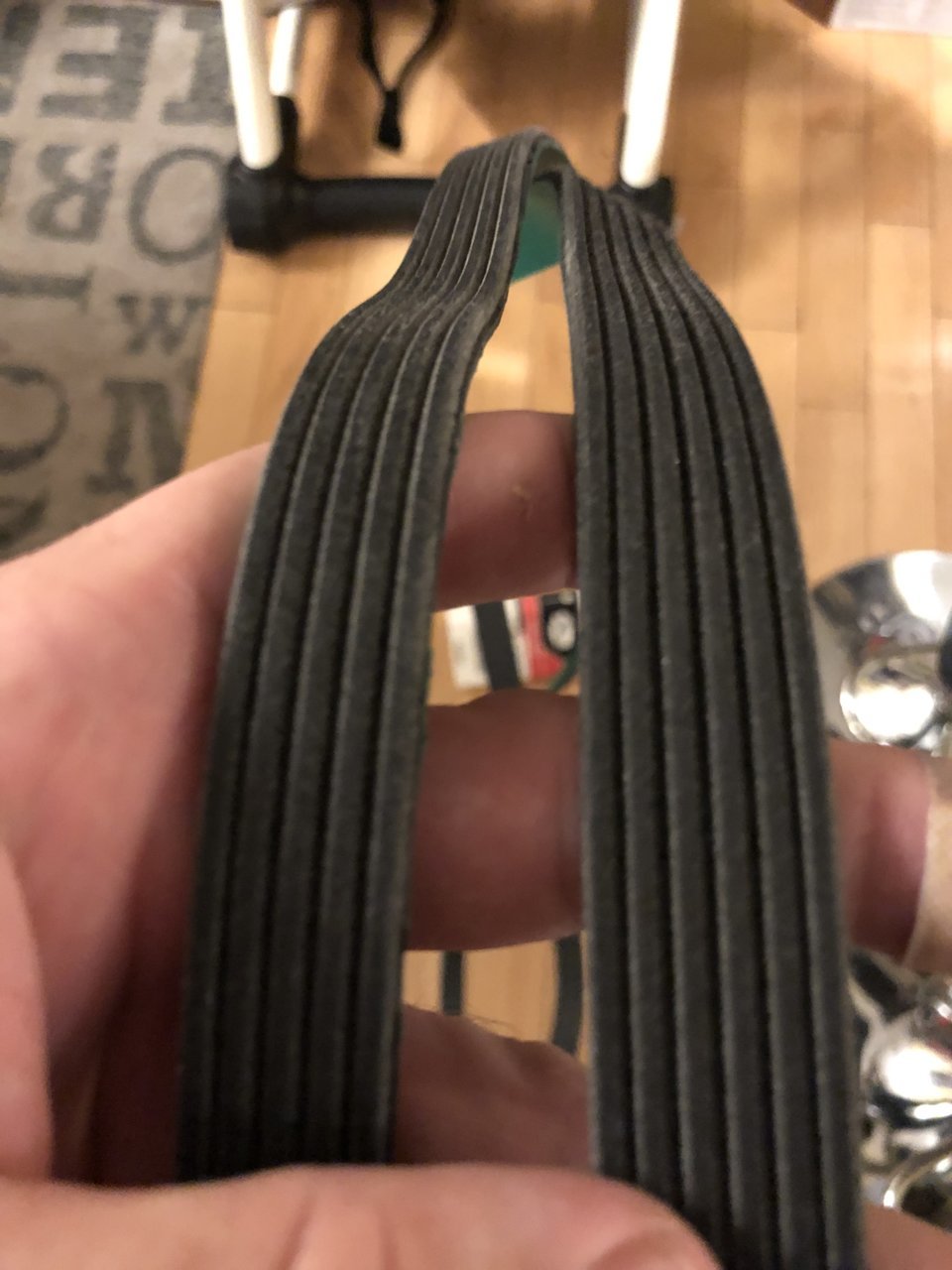

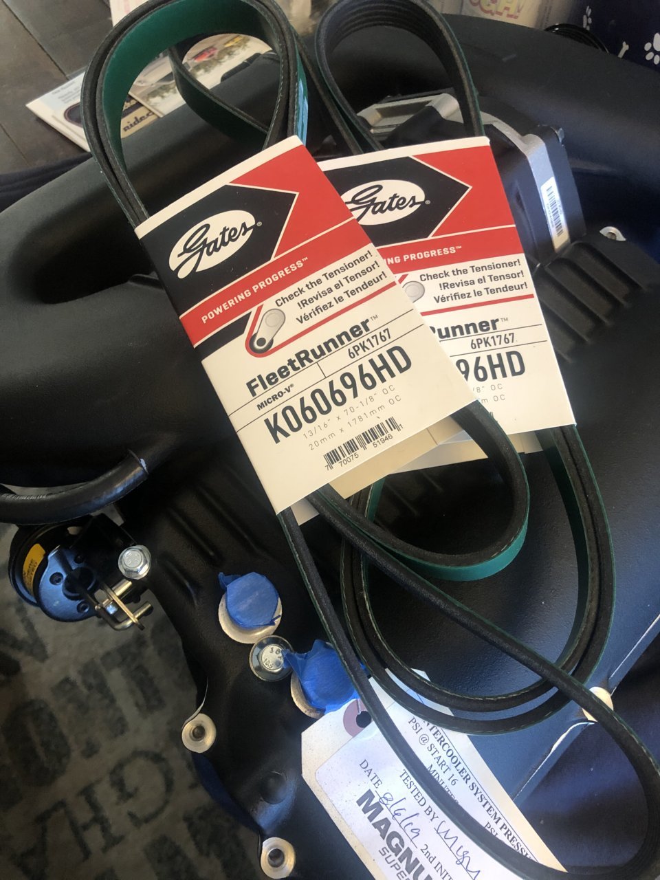

    Shorter Gates Fleetrunner belts for the SC. With the smaller pulley it needs a smaller belt which these work. They do need one rib cut off to work. Pic of same belts one cut and one original 6 rib belt. Took forever. 2nd belts a backup.

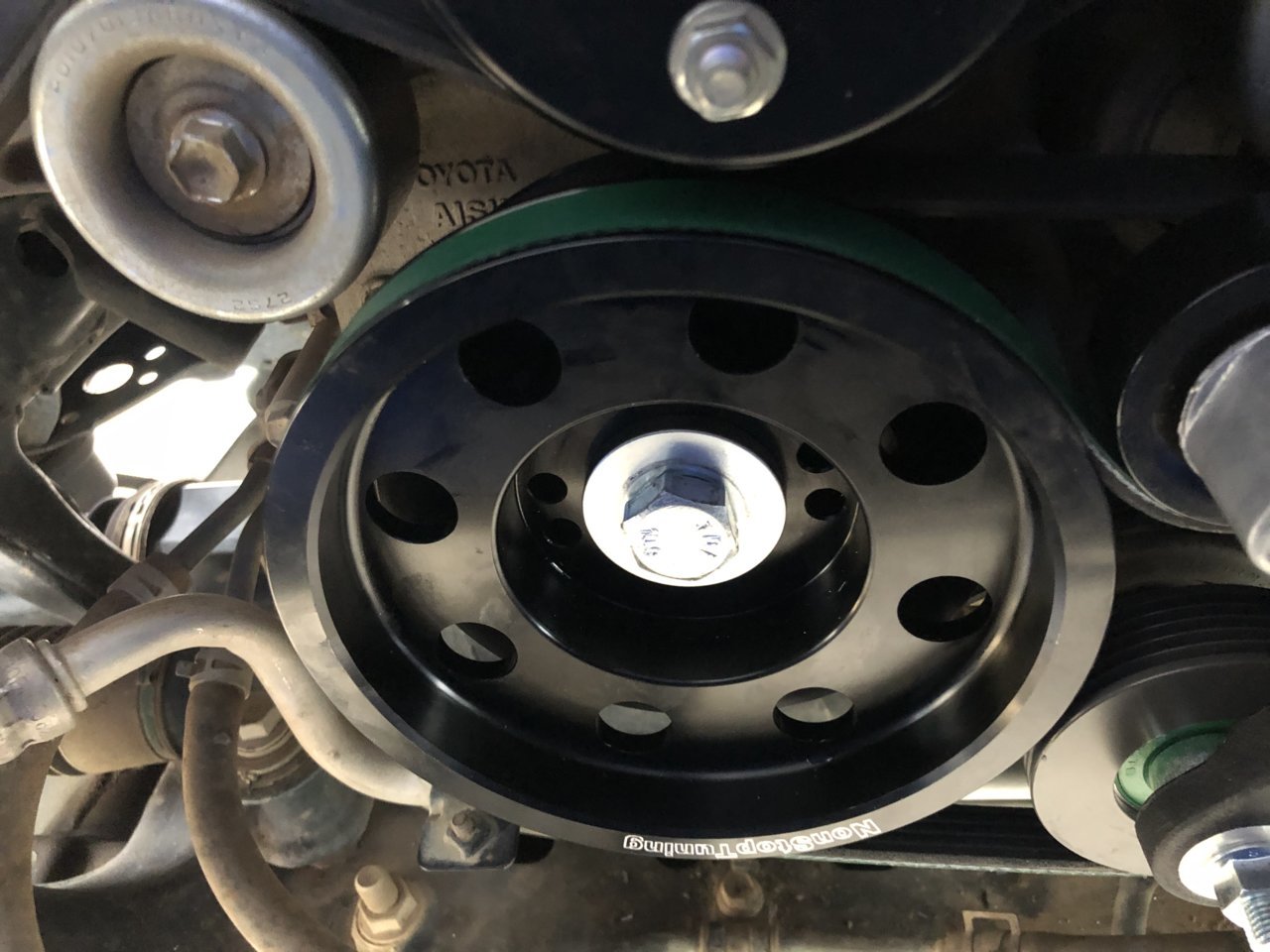

    Ha getting there. Hit a little snag that I’m trying to get past.

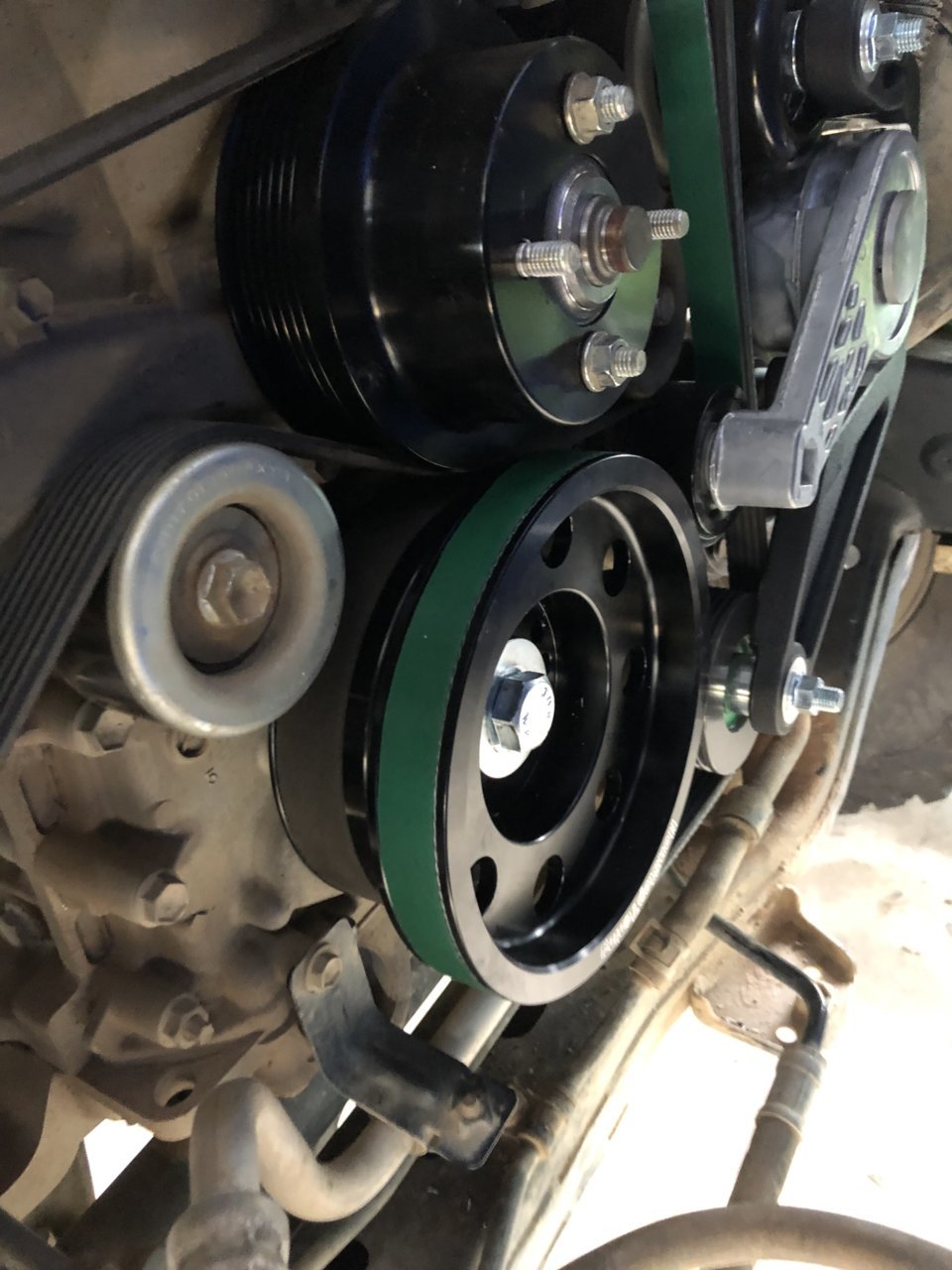

    But I did get this fancy new NST SC crank pulley :burnrubber:
    3434357F-0B0F-4118-8C9C-904A24F730BA.jpg 11C015D7-F7F1-4B86-8C1C-D2274A351263.jpg

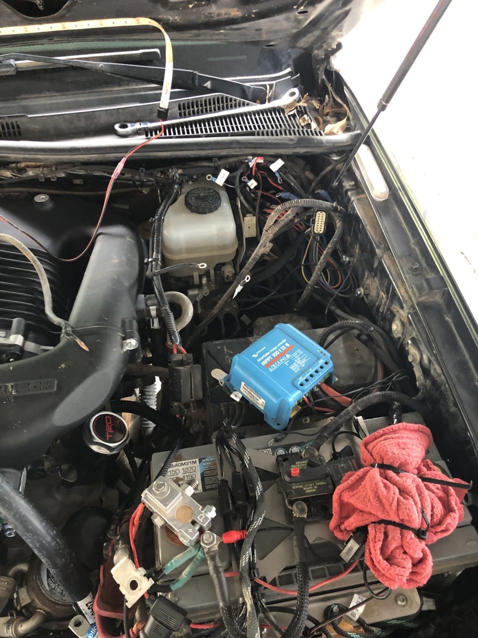

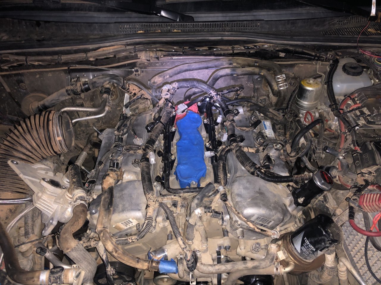

    Chipping away and making progress. Had to pull all my switchpro and compressor mounts to make room for some other items. Will be relocating but need to see where to put them.

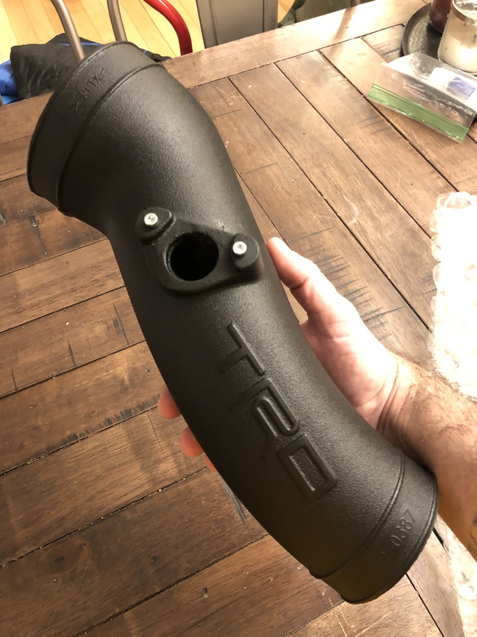

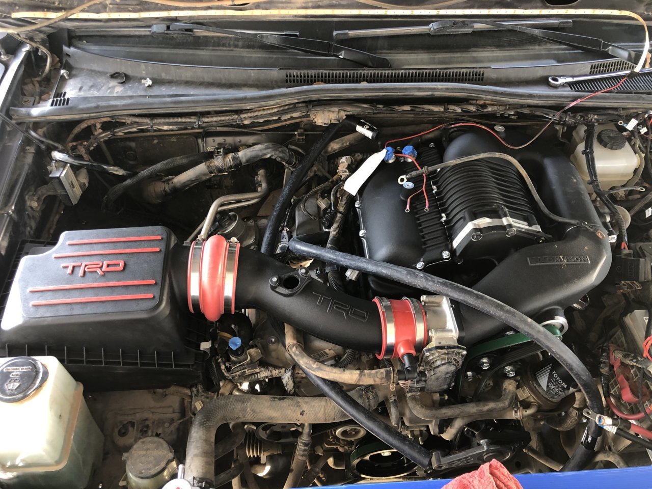

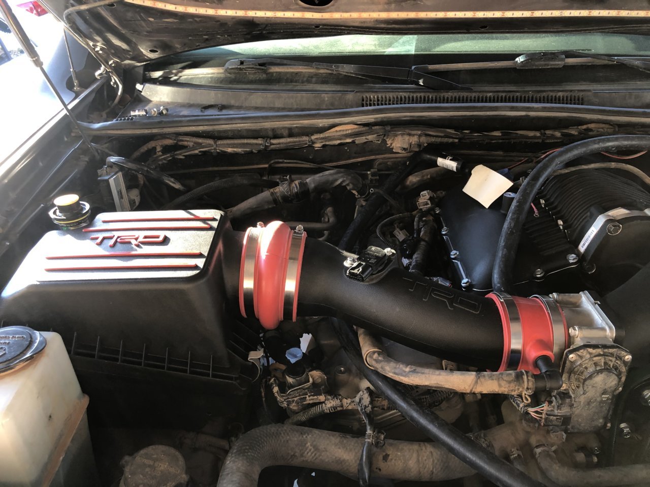

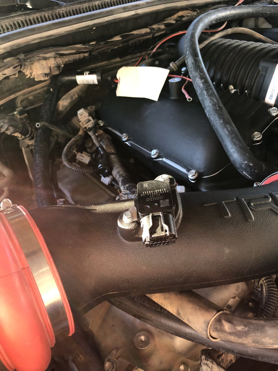

    switched gears and retrofitting the TRD intake from the 13-14 FJ/current T4R due to the larger intake tube in support of the 2.5” pulley. This is a nice bonus as the Tacoma version TRD intake made for years up to 201 but EO carb order states up to 2013. I’ll take it as a clerical error I’m my favor.
    Next step the intake requires a new MAF from the FJ/T4R as it uses a different connector and is just a different size. could possibly have used the Tacoma one if they had made it a similar mount. They just can’t make it easy on us. Next up is finding a good location for the SAIS as the intake was designed around not using it and takes up the same space it once lived.
    There are a few options from other intakes by AFE, K&N and Holley. If you do not have the ABS junk on the passenger side you may be able to mount with 2/3 original mounts. Would require a 3rd to be created.
    @12TRDTacoma has had good success with the Holley relocate. It does require that you extend the harness. You can see his success here.
    https://www.tacomaworld.com/threads...ricks-and-mods.518932/page-1291#post-23069972
    All of the a the new NST including the custom S/C crank pulley are installed and ready to go
