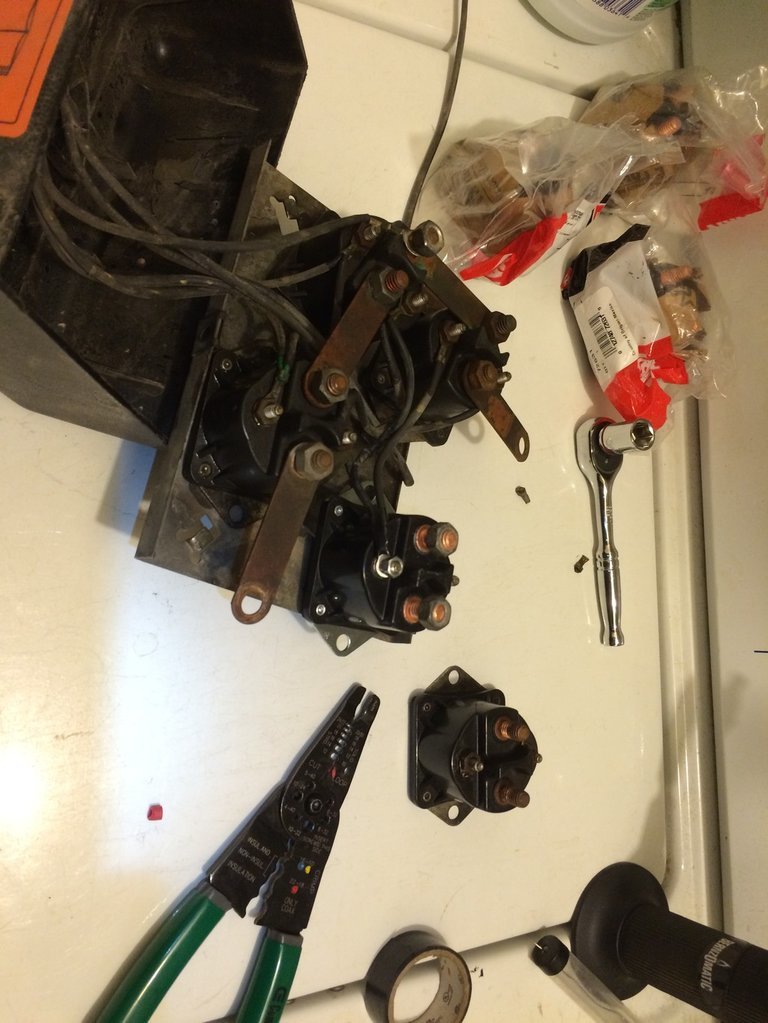

    had a busy weekend with the trucks getting ready to head south for FJ Summit...

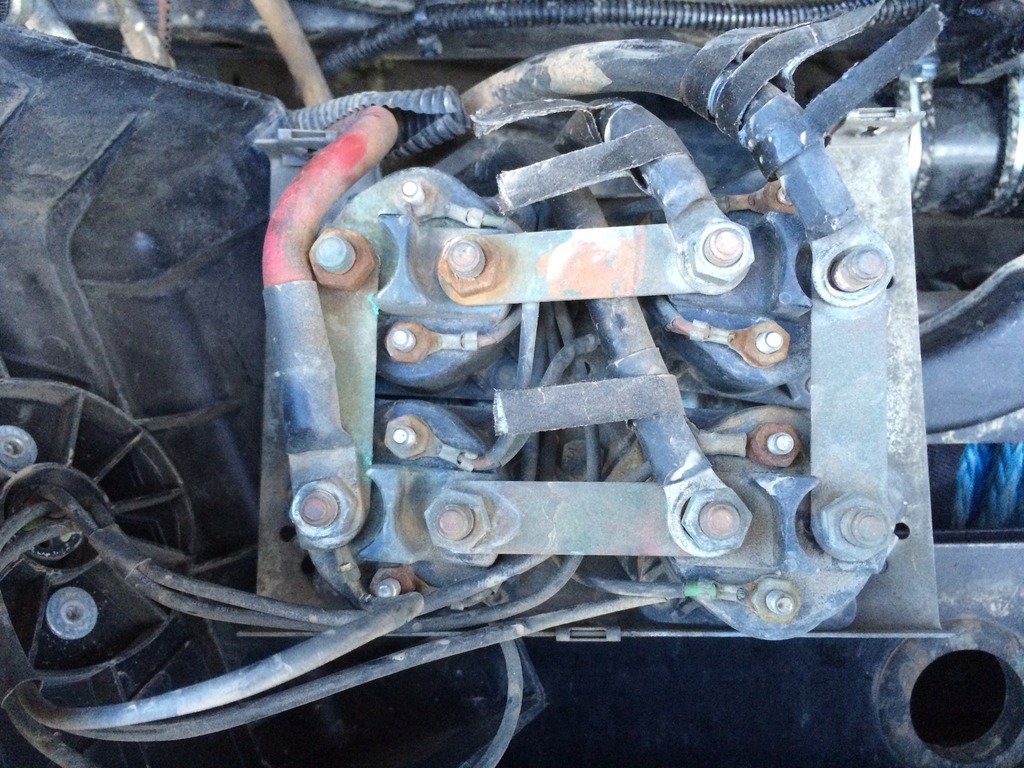

    friday night i tackled my failed winch on the tacoma...was on hagerman and lost my "in" but still had the "out"...swapped the wires on the winch to make the "out" the "in" for a temporary fix until i got new solenoids...so i ripped apart the box and got 4 new solenoids in from Warn.
    rotten mess before...
    8ACBE565-D29E-4EF7-8065-82B45AC0804A_zps_1234aab2e2bd7885e4c5ed32a863cfd04de80dfe.jpg

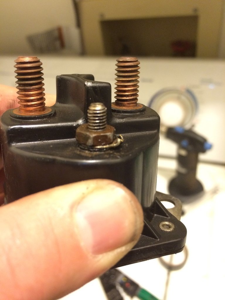

    had to get destructive to get some wires off for the new solenoids..seized nuts
    77458F0D-472B-4386-B536-9BF7F7913103_zps_5101b4cf48e96b726b052fff8798319f27612bc0.jpg
    my work table...aka kitchen counter
    003B4137-6823-4841-B139-48C23F50CB4B_zps_f04d298c23c62734b54d0ded99db33e2384fd242.jpg

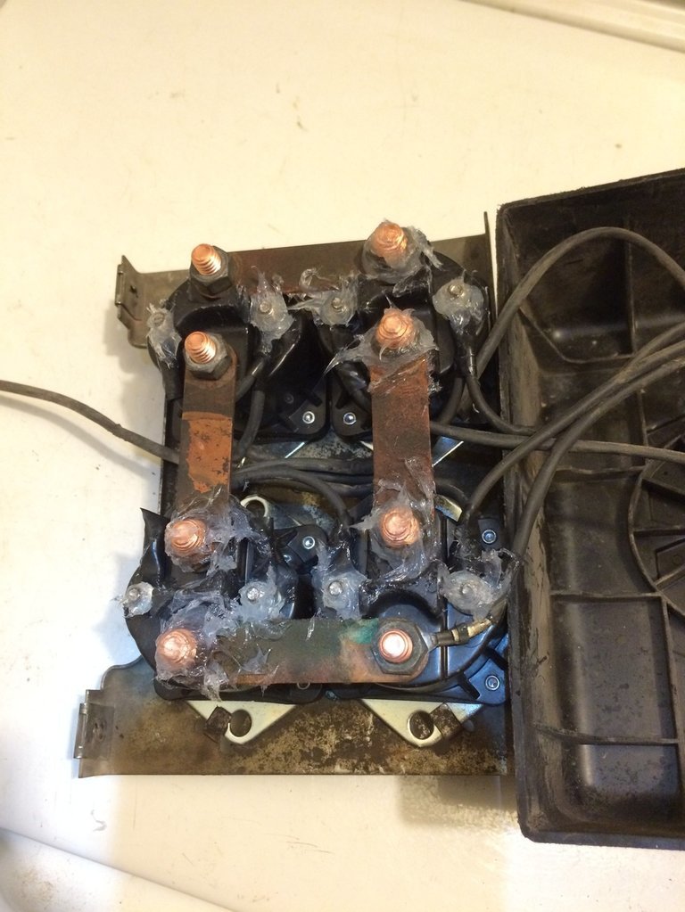

    much better...ready to go back in...
    2EF867A1-D165-44DE-B75A-72F7F72B9919_zps_4946913a9246840fff2d4be2f8b4d85696780947.jpg
    and now i have a working winch again :woot:

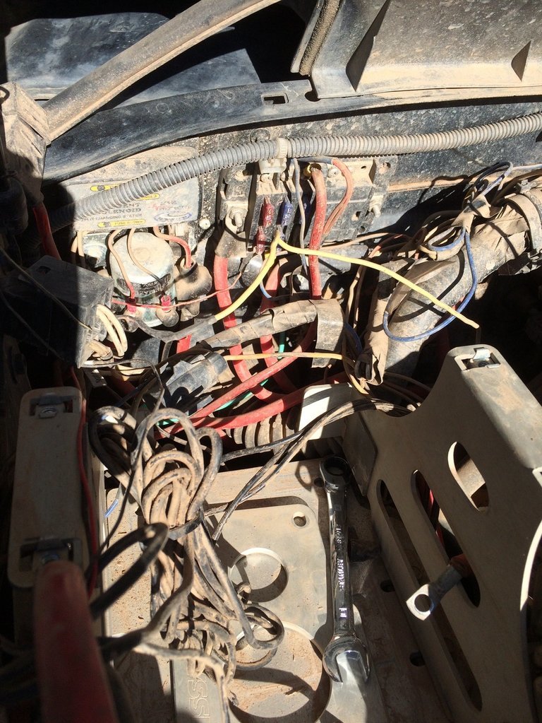

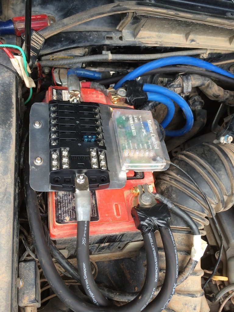

    gutted the engine bay wiring for the auxiliary fuse box and second battery and put in 1/0 and a new 12 slot blue sea with 100A breaker...way more organized and cleaner looking now...
    the mess before...this was all behind the secondary batter...very inconvenient
    F6228BB2-A690-4A37-A5F9-5BECEF2BD047_zps_5b473512bb3684933f4822d848795a031c3f5bb8.jpg
    new placement...much more convenient to access the accessesories...100A breaker and dual battery monitor/solenoid is behind the battery
    0636165A-74A4-4108-844F-AF408051DAB4_zps_7e20f48a45d37ad13aac0f108e9e1ceca0b294c7.jpg

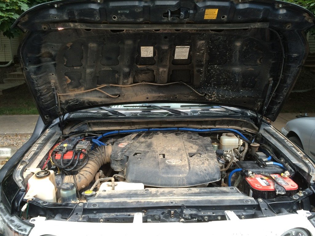

    and completed...i will eventually loom the wires on the passenger side and along the firewall..
    D2231FF7-AD94-41AE-85A9-B376B4B7CEE9_zps_7089631c1dfafbb2393e71fc66b8db990d381a1c.jpg
