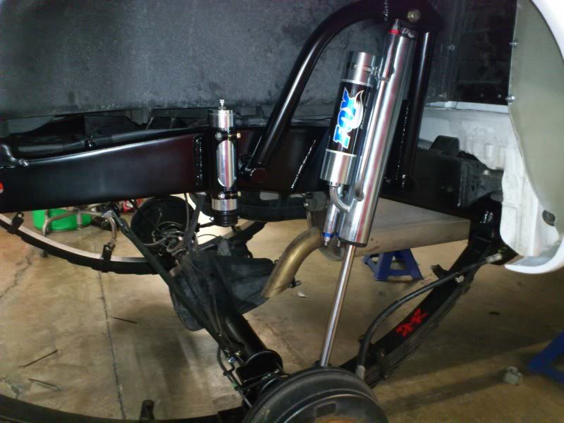

  10. Mar 27, 2013 at 5:58 AM
    #1330
    NYCO
    NYCO [OP] go explore...
    Jul 27, 2010
    #40842
    19,126
    bOb
    Colorado
    Blue Betty - '06 TRD OR
    dents & scratches

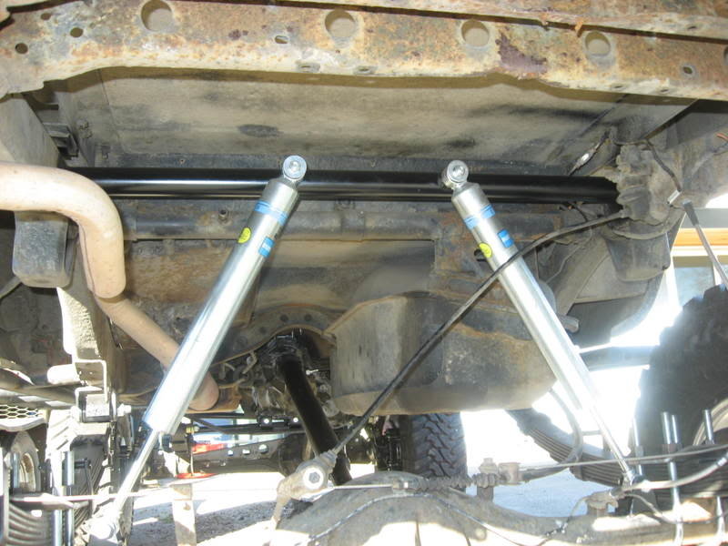

  11. Mar 27, 2013 at 8:06 AM
    #1331
    BigRedToy
    BigRedToy ¯\_(ツ)_/¯
    Apr 12, 2009
    #15885
    2,269
    John
    Colorado
    07 Regular Cab SR5 4x4
    I wouldn't inboard, but the the other options require shock hoops, frame modification, and/or a bed cage. Inboarding is probably the least expensive way to go.
  12. Mar 27, 2013 at 8:33 AM
    #1332
    NYCO
    Jul 27, 2010
    #40842
    19,126
    bOb
    Colorado
    dents & scratches
    good thing about inboard is that all factory mounts remain, so i can put shocks back in the factory spots for towing instances to keep factory stability..
    then have the inboard option for wheeling
  13. Mar 27, 2013 at 8:34 AM
    #1333
    NYCO
    Jul 27, 2010
    #40842
    19,126
    bOb
    Colorado
    dents & scratches
    i'm going to have to see how much room i have left when these shocks compress and see if i can squeeze out another inch and move to the 5110s and get a bit more of the extended length
