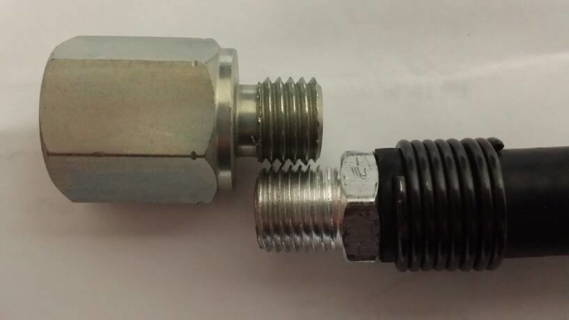

    Wow, they don't believe me that they are the wrong size. They had 2 in stock and ordered another one from their supplier. They can't fathom how all 3 could be the wrong size.
    I am pretty sure that they order by part number, not by exact size. If they gave them the same part number of course all 3 are going to be wrong. I verified all the fittings threads at Lowes on their thread gauge and bought a new nut and bolt to double check with new threads.
    I'd almost be better off, but I'd have to buy even more parts to make it work. The outlet runs through the handle and the tube doesn't have enough material to drill..

    What about removing the handle and going straight onto the head?

    I could do that or probably turn the head 90*

    I bet if you removed that handle, you would be able to bolt up with no issue.

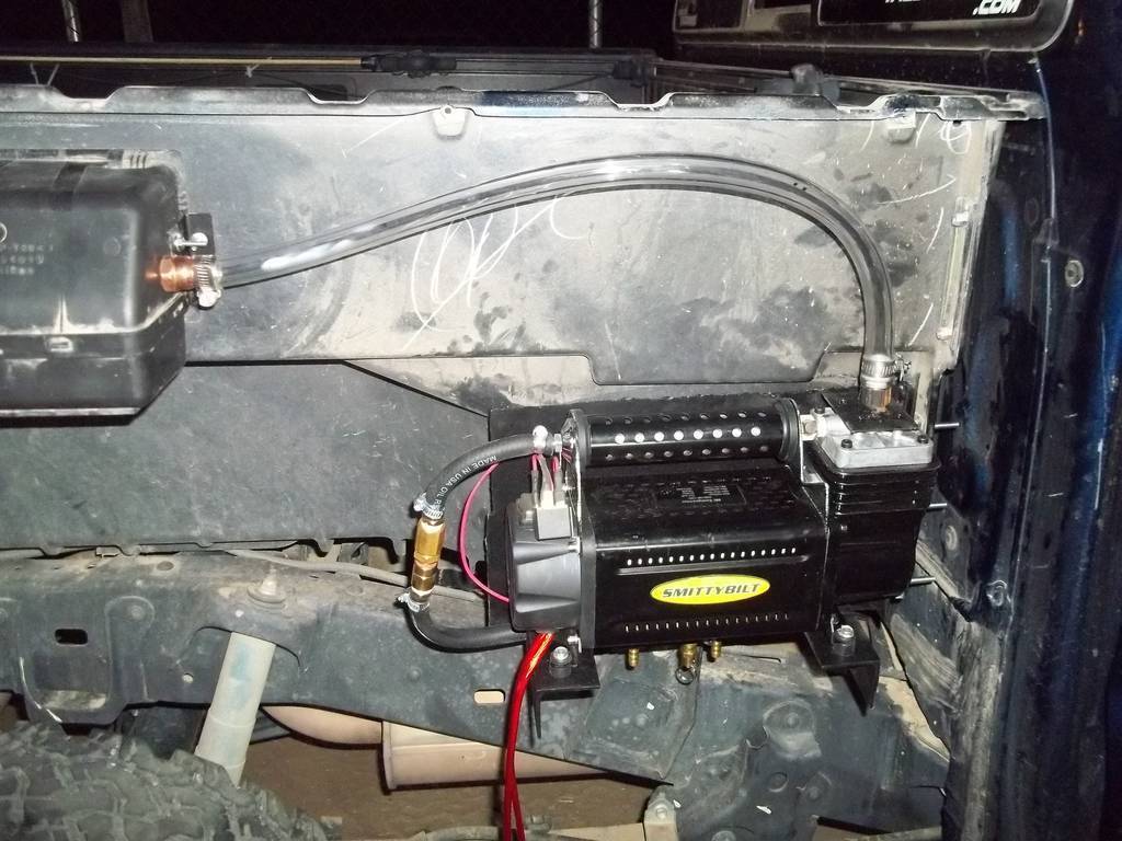

    I have the next compressor model up, the 2781 and the cfm is not enough to keep up with the unloader valve at higher pressures. I believe I got the second smallest version of the genie, after trying the 3rd, eventually I will need to go to the smallest or just go the check valve route. Smittybilt says mine puts out 5.65cfm and yours is 2.54cfm so I dont think yours will handle even the smallest unloader after 80psi.
    I also ended up having problems coming up with the correct threaded pieces to fit the compressor and ended up using the barb that was coming off the handle and just used my own hose at that point. Here are some pictures to show off my setup

    Looks like you did some work to that (modified the head). Got any info on it?

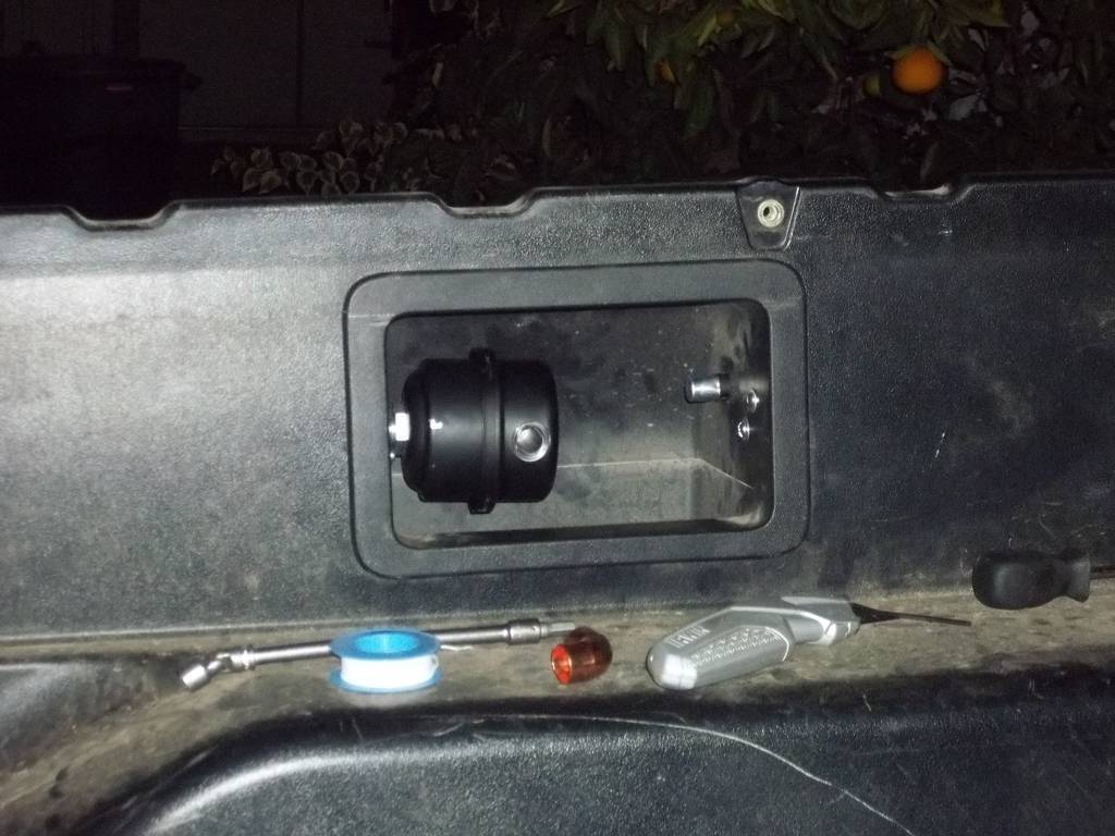

    The filter system on the 2781 is just foam in a plastic cup. In addition to that I have a longbed and mounted it in front of the rear tire so serviceability of the filter would be an issue. Rather than try to cut threads into a cheap chinese casting I decided to machine a tube to fit into the intake port, welded a small plate to it and screwed it down to the holes that held the plastic in place. I then took a servicable air filter i got from mcmaster-carr and mounted that into the cubby Then i took a simple piece of hose and connected the compressor to the filter.
    Overall I am happy with this compressor. It puts out a TON of air at the lower pressures, but tapers off quickly above 70-80 psi ish, though it will go to 150. It takes about 2 minutes to air up each tire which actually seems to compete with everyone i wheel with running co2, and thats without me having a tank yet.
    As for your psi switch, Me personally I would return it. That thing is HUGE. The one i have is tiny, and just works like a simple inline switch, which i use to control the relay which powers the compressor.

    Off topic but how hard was it to remove your bedside? Is there a guide somewhere?

    If you look at the last picture, you'll see a nutsert just above the cubby. Those are the bolts that hold the bed rail on. Start there. There are some more hints in this thread.
