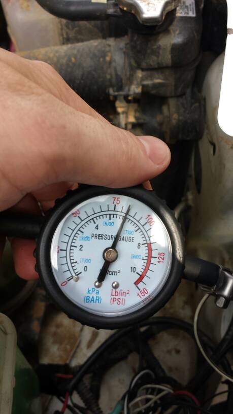

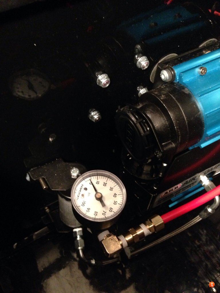

    Finished up my OBA. I need a lower psi pressure switch. The one way check valve doesn't work at lower than 1CFM and when psi increases the valves closes and blows off (CFM being inversely proportional to PSI). I'll make a gauge and see what psi the valve blows off at. At the very least I know I can pump my front tires up to 40psi.
    Zr_nf likes this.
  10. Aug 29, 2014 at 12:41 PM
    #370
    Sandman614
    Oct 26, 2010
    #45273
    36,038
    Tim
    Garner, NC/Boone, NC
    '06 SR5 Off Road
    The results are in. About 80-85 psi is where the cfm drops too low for this unloading check valve.
