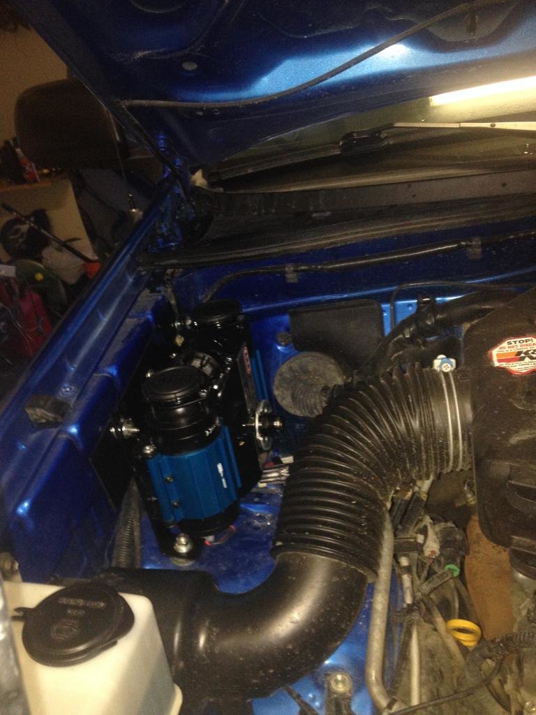

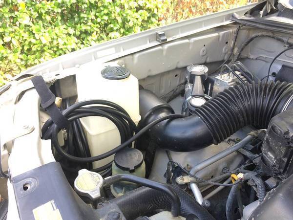

    Finally mounted my compressor inside the engine bay. Was pretty simple. Just bought a u-shape mount at home depot for $3 and used the factory mounts to secure. Cut off the clamps and used terminal connectors so they can be permanently on the battery.
    I got tired of getting in the back of my truck, opening the toolbox and putting on the clamps etc. Now I just have to open the hood and flip the switch.
    Velcro strap to secure air line.

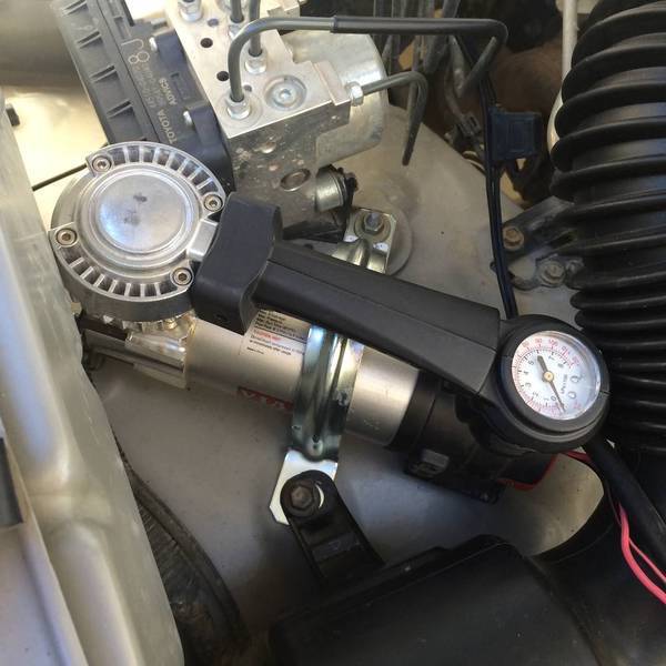

    If you have any room in your bed sides id play with that idea first.
    Also found you can get two of the CKMA12 Compressors for a couple bucks cheaper than the dual- and in the end, the dual is just two ckma12 stuck together.
    Two separate ones sharing a manifold to the same tank would be easier to mount I think.

    I thought they all had abs?? I really wish mine didn't, as its nearly killed me several times. I've got a bunch of OEM crap in that corner so this is the only thing that fits over there. Fabbed this up to use the three OEM bolts that are sticking up. Don't know what they are there for, but they're very convenient if you know how to use em

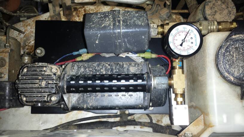

    It's complete. Took out the combined one-way unloader and put in an electronic solenoid valve. I added a gauge while I was at it. The next time I mess with it I'll add an ARB Locker and safety blow off valve (to manually bleed off "tank" pressure).

    What is the solenoid for? Do you have a tank?
    & what's an unloader? Check valve?
