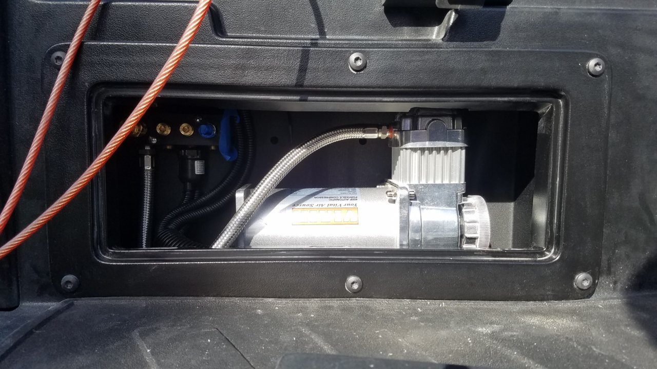

    Viair 400p in the truck bed using the expedition essentials mount. Grounded to the frame cuz only a fool would run 2 wires all the way to the battery.

    Just make sure you seal the cubby. A LOT of mud got to my compressor before I moved it. The location of the cubbies are prone for mud since the tires are right there

    Just curious, how bad did it get in there? I didnt like how the expedition essentials box was so exposed so i designed it to be as weather proof as possible. Where did u end up moving your compressor to?

    The compressor actually seized up. But did this trick and flipped pos and neg wires and it turned on in reverse and kind of unseized itself in the process. Flipped the wires back and luckily it worked just like new.
    After getting a Vagabond Outdoors Drifter, it now sits in one of the cabinets I made.
    I really didnt wanna say anything bc you have it wired nice, but TBH I’d definitely install it somewhere better protected by the elements. However if those seals that @Jakoda mention work well, then definitely get them.
