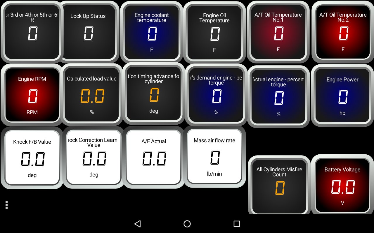

    Taco16LB
    Taco16LB Well-Known Member
    Sep 30, 2016
    #198602
    1,900
    I do think I have it , I had to set up email etc.
    quite a bit of learnin I just did for an old fart, lol.
    Thanks for the help guys!
    This is just my first draft of a dashboard , I will be playing with it to spruce it up a bit.

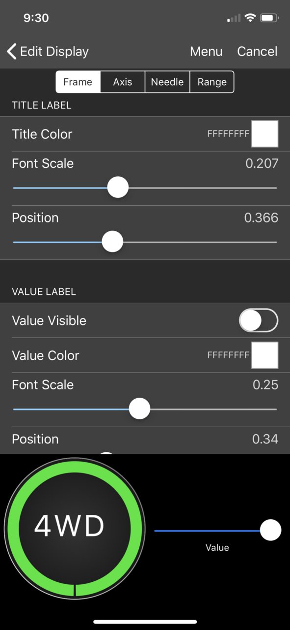

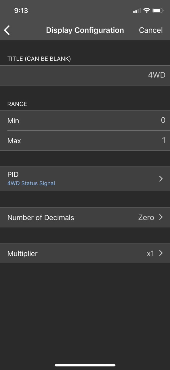

    2019 Cement TRD OR DCLB

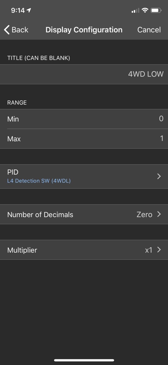

    @LDS 77 How did you get 4Lo to trigger? Mine just triggers whenever 4wd is activated. Can’t get it to differentiate between 4Hi and 4Lo.
  8. Feb 12, 2019 at 9:17 AM
    #68
    LDS 77
    LDS 77 Well-Known Member
    Feb 19, 2017
    #211025
    168
    2016 OR
    Had to try different pids till it worked.
    Here’s what I used

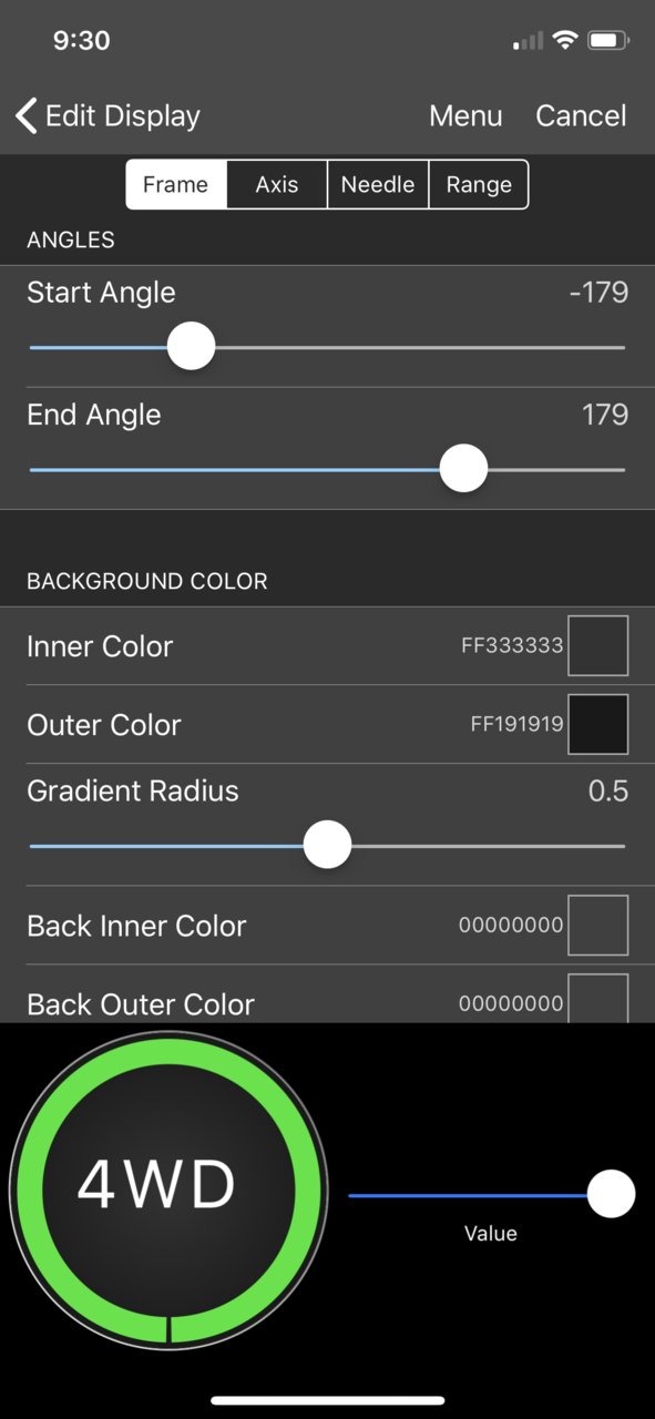

  10. Feb 12, 2019 at 9:38 AM
    #70
    LDS 77
    Feb 19, 2017
    #211025
    168
    2016 OR
    Here’s the settings I used. You can play around with it to get it how you like.
    I just made different displays and put them all on the same dashboard to see what works than delete the ones I don’t like or don’t work.
