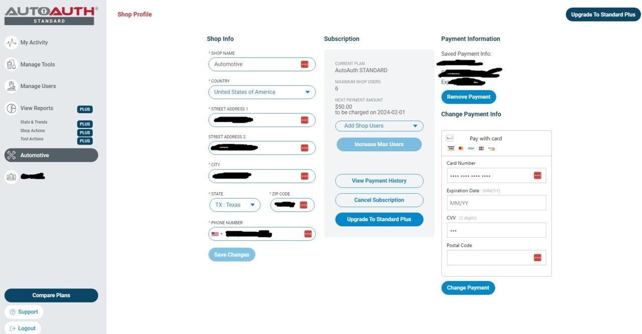

    Do you have to prove that you are an "actual" automotive technician and/or auto maintenance shop owner/employee to qualify for AutoAuth? Or can any private individual/DIY person sign up for an AutoAuth account & subscription? (I looked carefully through the AutoAuth website & this basic question did not seem to be answered anywhere, either directly or indirectly.)

    No, all you need is your name, address, phone number, & the serial number of your scan tool. You can put any name in the shop field.
    Once you are signed up with AutoAuth you have to create an account with your scan tool provider and link it to your AutoAuth account.
