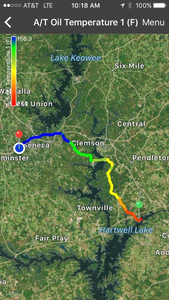

    Interesting, look at my temps with Fusion/Kiwi for A/T 1 & 2 for a trip, the temps were in the 185-192f range.

    This is a really cool feature (auto log). I'm really considering this whole set up as I do a lot of towing through the BC mountains.

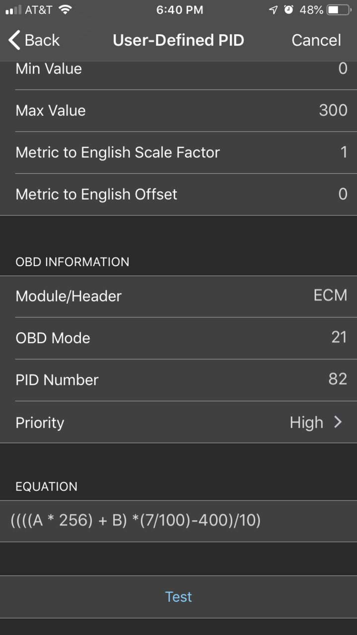

    Here’s the formula for user defined tranny temp, works perfect on my 2010
