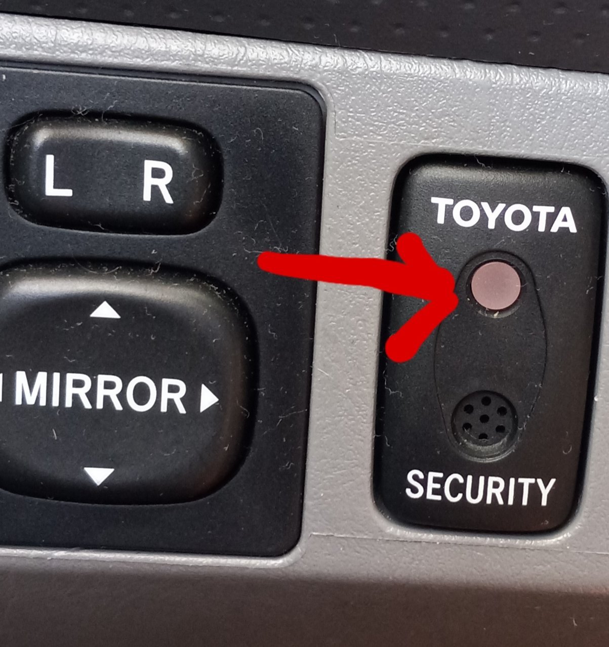

    I know this is a old thread but I am finally getting back to it. I am not good at during the pin method, I am better at using wire taps. Can you tell me which wire coming out the back of the sensor I can tap into to make the LED blink with the security light. I know this was a while ago so I can understand if you don’t remember. I am also not very good at reading wiring diagrams, that is why for my question. Thank you.

    Does anyone know which wire coming out the back of the microphone I can use to tap into the blinking security light?

    From what I know the standard one that fits in the larger switch spot doesn't have an LED. I have seen some do it on the smaller ones. Sorry I'm not much help. Try to look back in this post or other posts to see if you can find the person that has done it. Try sending them a direct msg. From my experience everyone on here is willing to help so see if reaching out to them directly works. Good luck.

    Thank for your reply. I have the smaller one with the LED light. I’m trying to tie that into the blinking security light. I will look back on the posts and see if I can come up with something. Thanks

    Finally got my GBS LED light tied into the security system light. It took me awhile but I was able to source a connector with the 4 wires (2wires to the GBS harness and 2 wires to the security light) from eBay. Everything fit perfectly and the connector was only $19 and it included a GB sensor. I found out the older Toyota cars that had a GBS had the right connector that fit into the small sensor. Once I get the pictures uploaded from my phone I will post pictures. I think it looks cool all 3 LED lights ( GBS, TRD pro shift knob, security LED) all blink off/on together.
