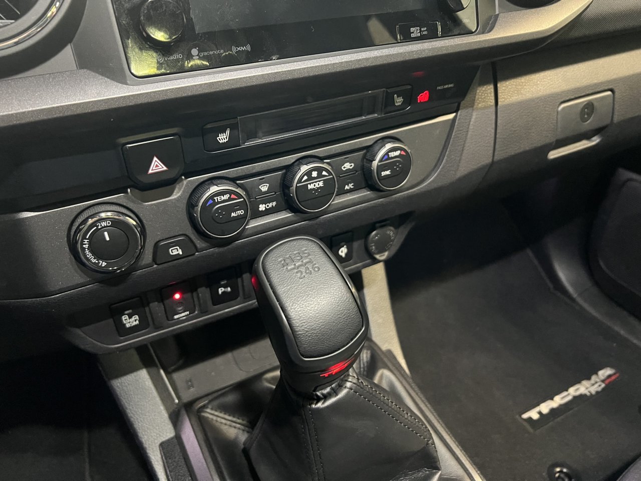

  5. Aug 16, 2023 at 7:08 AM
    #265
    NukeMaster
    NukeMaster Member
    Jul 24, 2023
    #429704
    10
    2023 DCSB Trail Edition
  6. Aug 16, 2023 at 7:11 AM
    #266
    Barsoom
    Barsoom Well-Known Member
    Jun 17, 2021
    #368854
    1,850
    NW GA OTP
    Man, that's very tempting. Will allow me to bleed the ABS block too.
    And program a Lexus key card.
