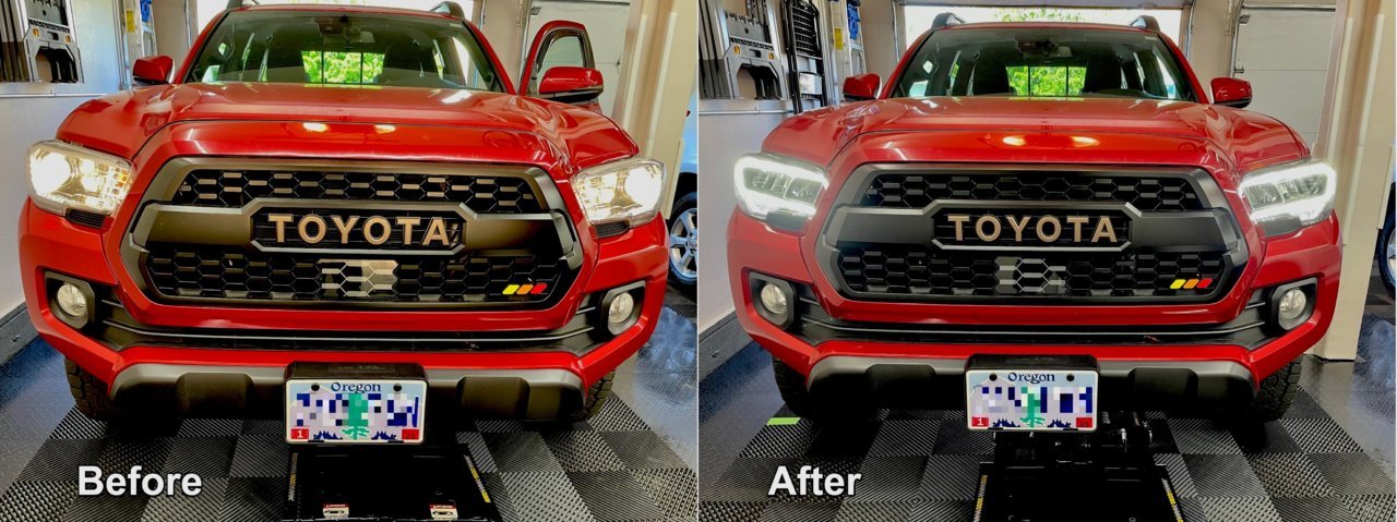

    Did this on our 2020 TRD OR using @daveeasa's wiring harness. Works perfectly.
    Dave's website:
    https://fbchs.square.site/product/taco-3g-trd-oem-led/1?category_id=4
    I just kept an eye on craigslist, FBMP and such and eventually a pair turned up for a good price. More here:
    https://www.tacomaworld.com/threads...3rd-gen-today.399305/page-12989#post-28727343
