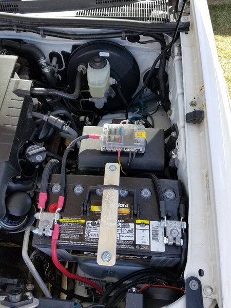

    @WormSquirts is exactly right. The kit comes with one 4 AWG extension, one 2 AWG extension, one 4 AWG butt connector, one 2 AWG butt connector, one 2 AWG ring terminal (for the factory ground. Usually needs to be shortened) and enough heat shrink to cover all three crimps.

    Thanks for the info. Still trying to decide what to do. I just need a few more inches on the starter cable to connect better to the 31M battery I installed.
    I like the simplicity of the spice, but I'm also considering replacing that whole cable down to the starter... maybe even doing a "big 3" upgrade while I'm at it. Especially if I need to buy a hydraulic crimper either way.

    I crimped them with vice grips. Was quite difficult to squeeze and took a little while doing it in small increments, but it holds strong. Wasnt worth buying the crimper for two crimps to me

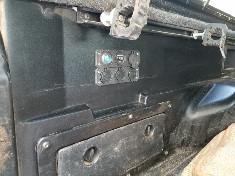

    Thought I post up the install Matt did. It's a single battery setup with power plugs in the bed, just right for my needs. The bed plugs are 4X USB, 1X cigarette style and 1X for the solar panel plug, with an on/off switch and voltmeter of course.

    Sweet setup. How much of a pain was it to route the wires up on the bed wall? I was considering a similar setup and didn't want to block the 2x6 slot or the cubbies.

    They just get ran along the frame until after the wheel well then up to where it's mounted. you can take the cubby out to help make the install at that end easier
