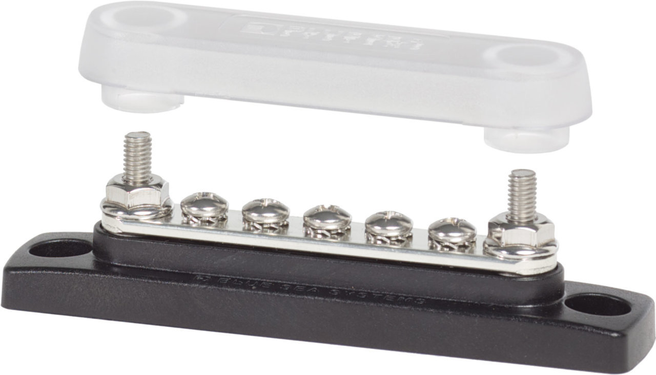

    Using a busbar will still require an inline fuse to be used for each accessory. You'll still have a mess coming from the general area of the auxiliary battery. This is why we recommend the use of an auxiliary fuse box instead.
    Run one positive and one negative cable from the auxiliary battery to a fuse box located anywhere you desire. Attach all accessories to the fuse box. This keeps all circuits well sorted and properly fused.

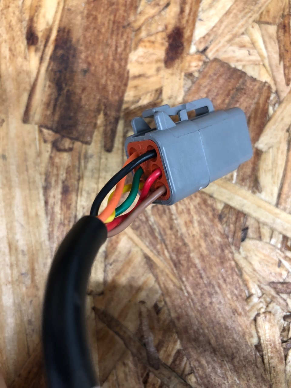

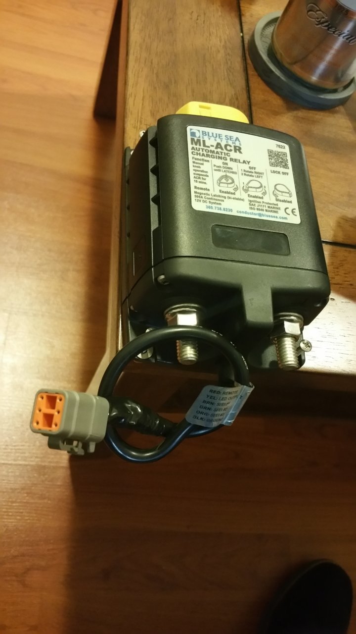

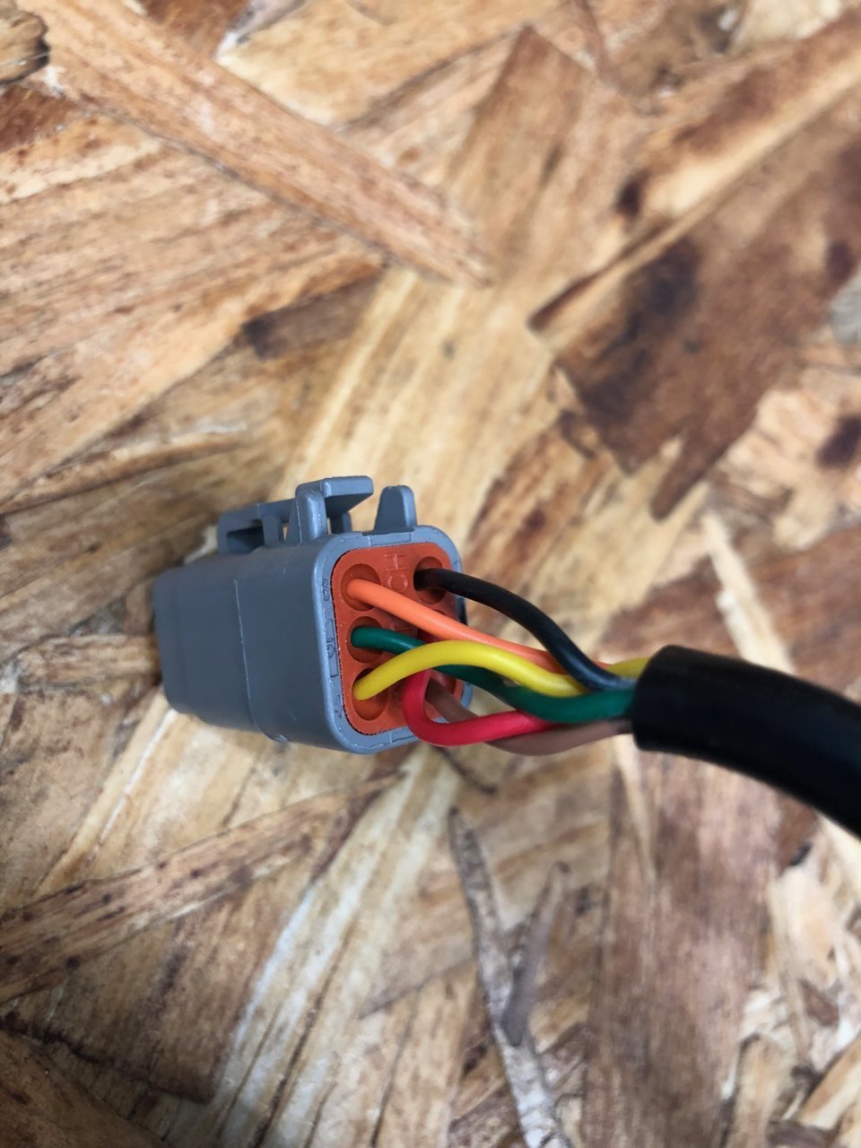

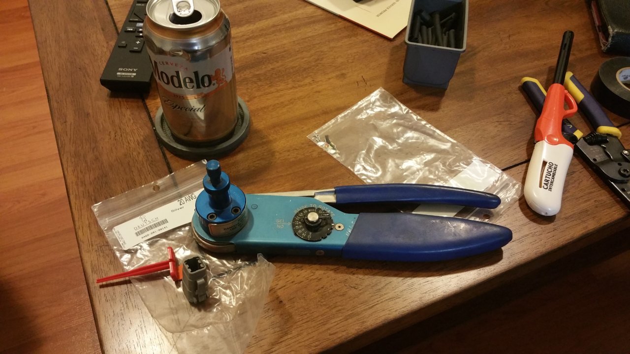

    anyone in here bought the wiring harness with the Deutsch for the ML-ACR? Need some close up pics of the clip that mates with the ML-ACR Deutsch if possible. I bought the harness and my own Deutsch pieces to crimp on my ML-ACR wires and want to make sure I get the ML-ACR wires into the proper slots ont eh Deutsch to make up properly to the OGE harness.

    You need a picture of the ACR side of the harness, correct?
  15. Dec 3, 2018 at 4:09 PM
    #495
    HeliMedic
    HeliMedic [OP] Off-Grid Engineering
    Nov 12, 2010
    #46096
    616
    Erie, CO
    Constant revolving door of Toyota vehicles
    Here ya go
    Pin #1 - Black
    Pin #2 - Red
    Pin #3 - Brown
    Pin #4 - Yellow
    Pin #5 - Green
    Pin #6 - Orange

    You sir are the epitome of customer service and I am extremely grateful!!!
    Learning note for everyone else: DO NOT PUT HEATSHRINK ONTO THE CRIMPS AND THE WIRE BEHIND THE "BARREL", the connector will NOT "snap" into place with it on there. Lesson learned, luckily I didn't use very good heatshrink with glue so it was relatively easy to remove.

    Why is it that there's always either a beer in the picture with either a auto part or engine... or a truck. :)
