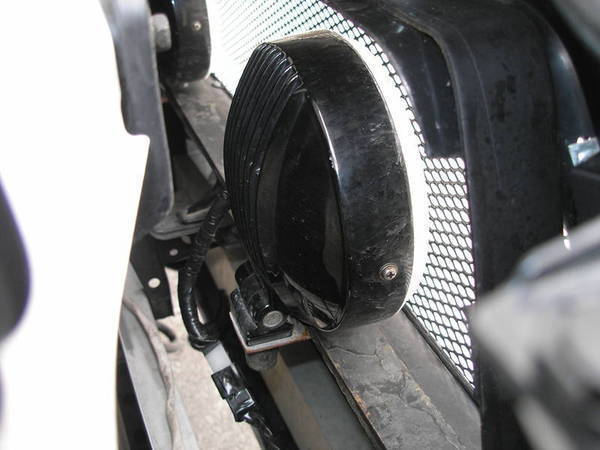

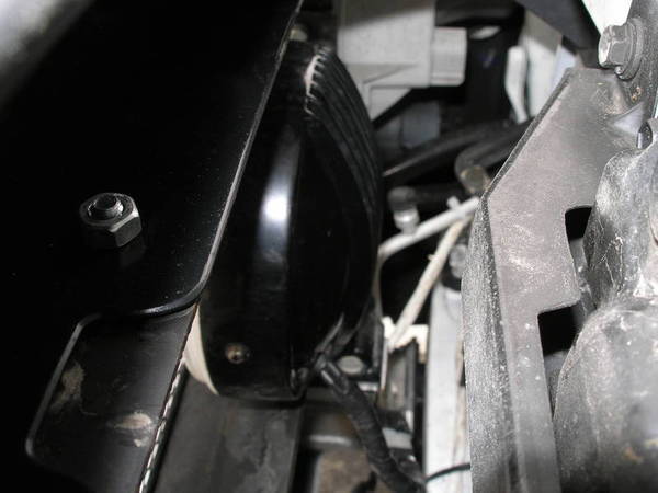

    There are no bracket kits available as far as I know. I just used some flat bar and bolted it to the grill to reinforce everything. My lights are mounted to the flat bar on tabs since I needed some extra clearance for the lights. If you use Hella 500s, I don't think you would need the tabs as they are not as thick as the PIAAs I have. My set up is pretty sturdy and I am happy with it so far, here are some pics......
    Hope that helps a bit.

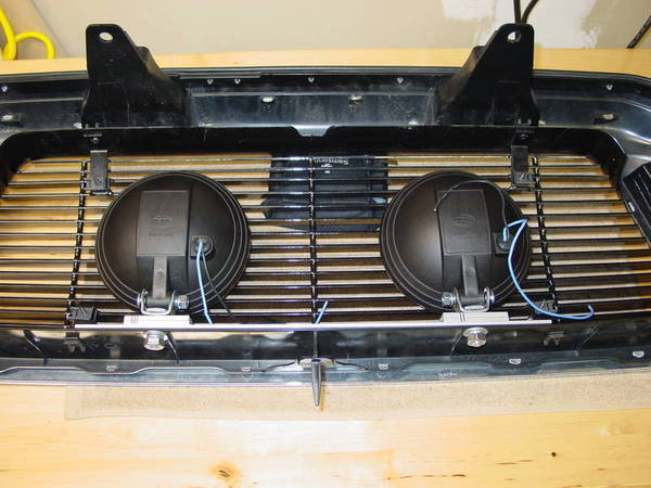

    Alot of people have done them different, alot of it depends on type of grill you go with and lights.
    This is my old set up with a billet grill and Hella's, for other pic's look in my pic's.

    The only thing about the Hella's I did not like was the fact they have a top/bottom, some lights like Piaa, you can turn the assembly around. Now I don't know if it means anything, or if pattern of beam is different, but the Hella's you can't turn the lens assembly.

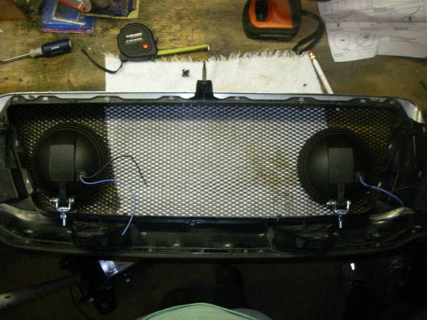

    I took a piece of flat aluminum bar and bolted both lights through it. On the other side, I made little pieces, to help support. If you dont they will bounce. I had to go back and do this. This picture doesnt show it, but I drilled holes through the bar on both ends so both lights would be mounted to the bar.
