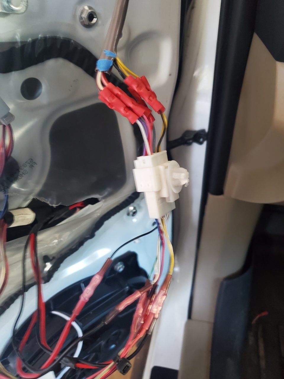

    This actually caught me by surprise when installing the Highlander switch that I got from @Up2NoGood. Why is a momentary push more ideal than the latching design?

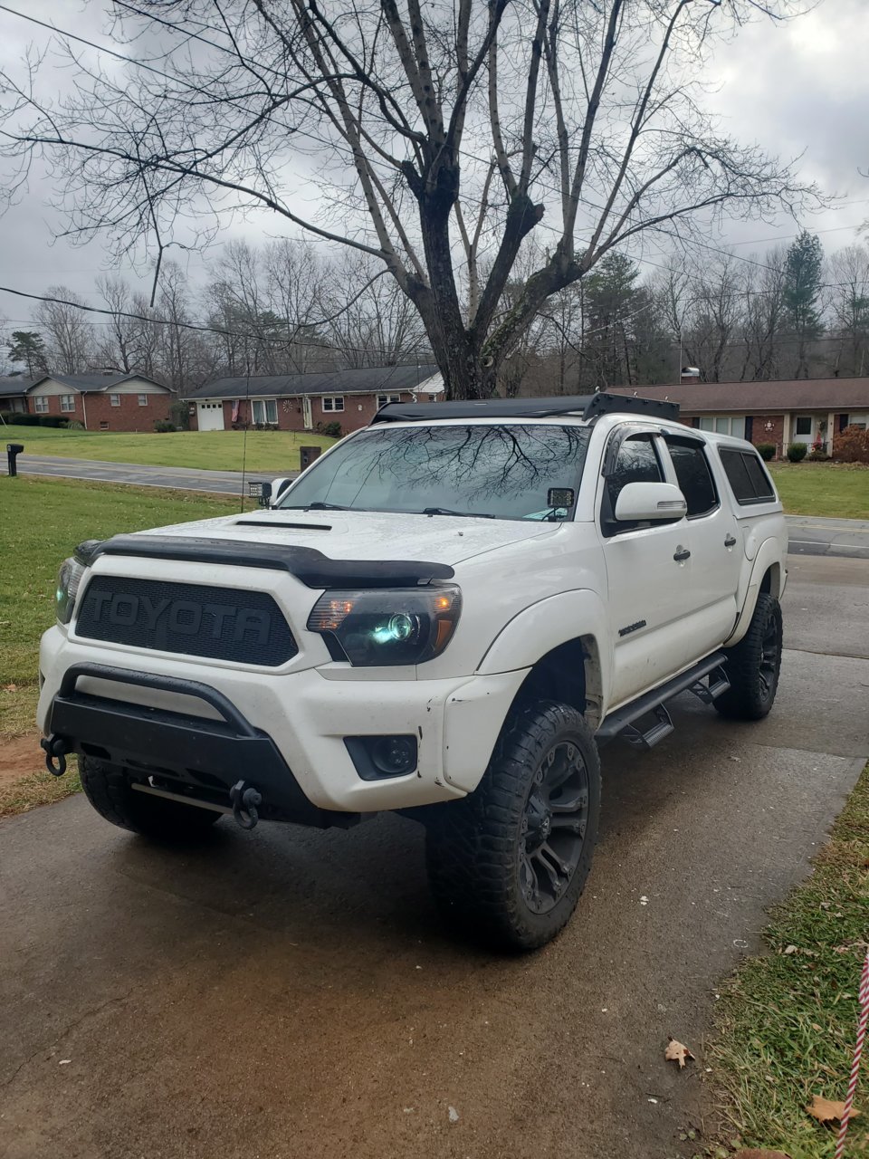

    20211016_172757.jpg I did this last year and everything works as should, looks much better than the crap black mirrors. Once I found the male and female connectors off a wrecked 4runner it is now plug an play.20211211_102111.jpg
