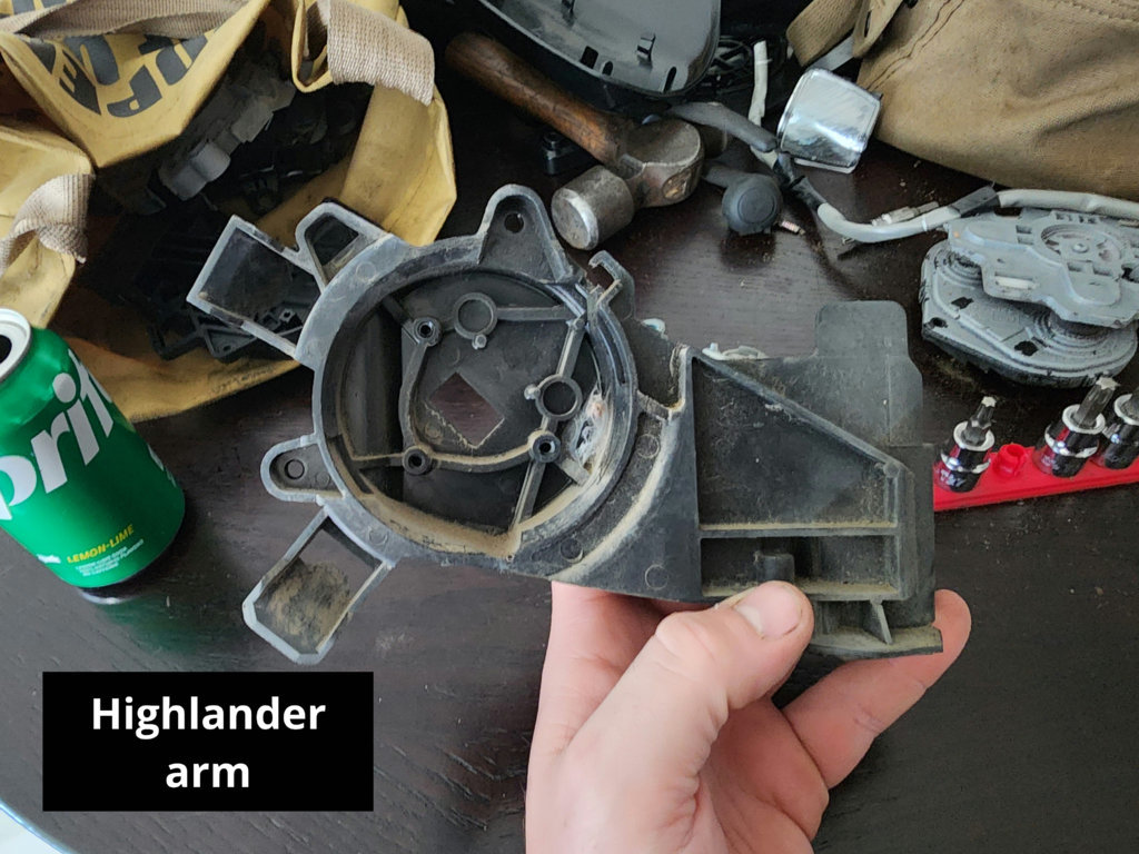

    07 Tacoma access cab 4x4 2.7l

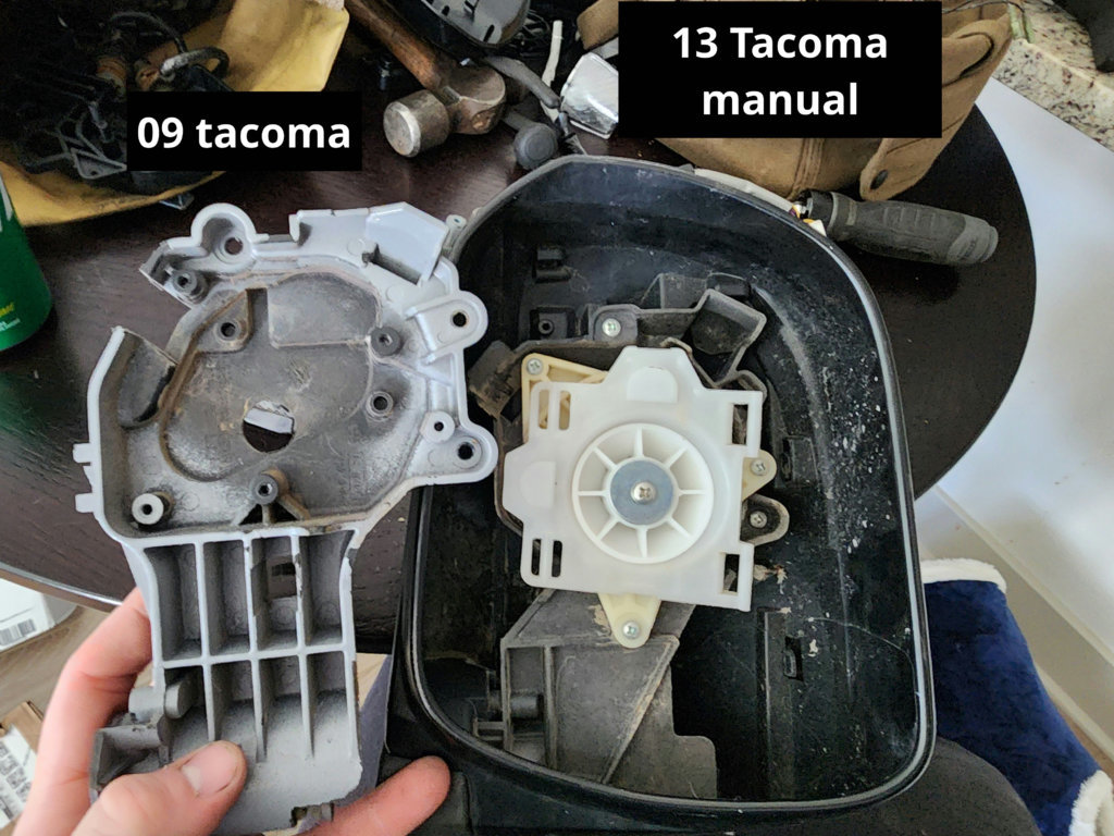

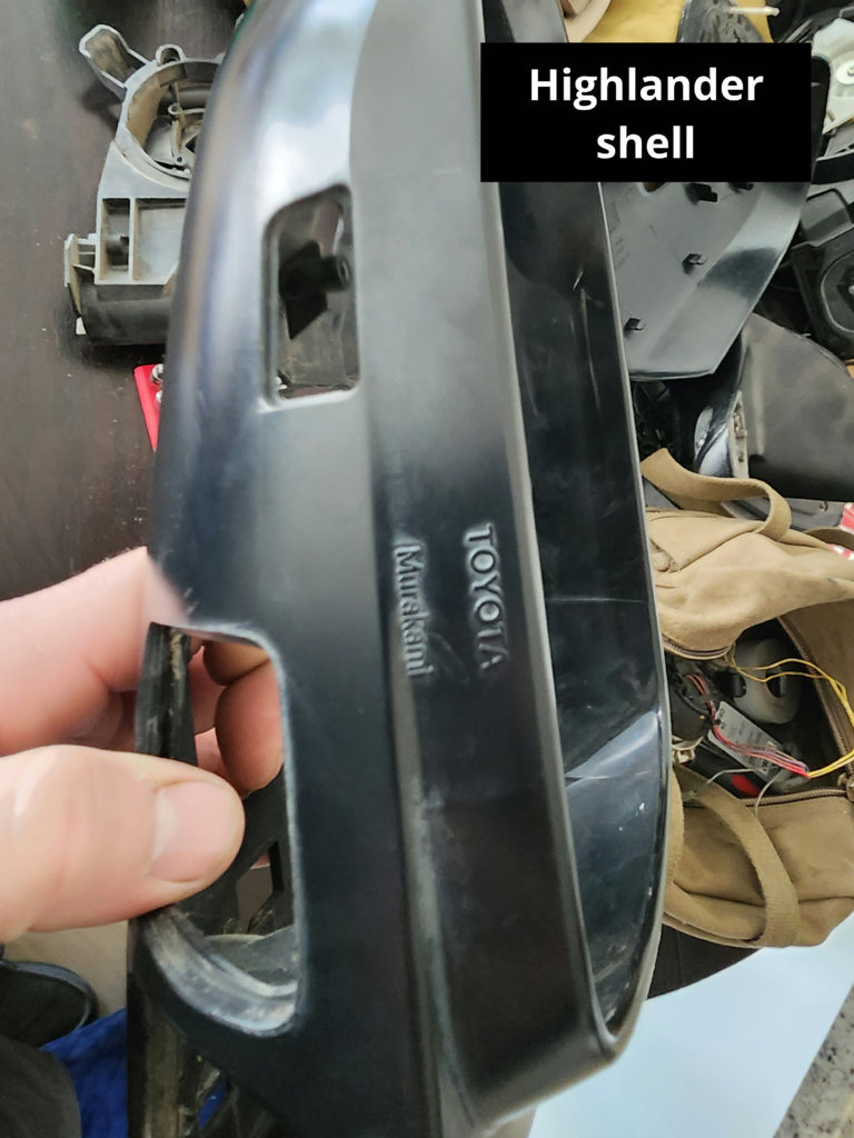

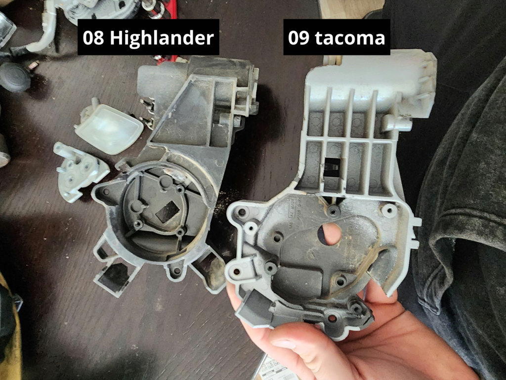

    I'm working on doing this right now, but I have to wire up the mirrors, as I have a base model.
    I found out that the 08-13 Highlander have the same base as Tacomas. I'll post some pictures later. I've got to buy a shell and the blinkers will bolt up to the Highlander mirror
  10. Apr 7, 2025 at 10:08 PM
    #130
    nudavinci64
    nudavinci64 Robert @ Holy Horsepower
    Nov 14, 2013
    #116533
    10,144
    Robert
    San Mateo/Cayucos, CA
    13 S/C TRD OffRoad 4x4
    Boosted Money Pit....
  11. Apr 7, 2025 at 11:35 PM
    #131
    Levalexi
    Levalexi Well-Known Member
    Jun 10, 2019
    #295916
    435
    Southern Maine

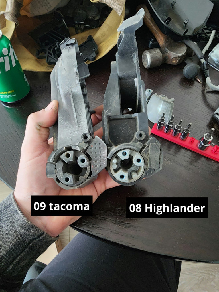

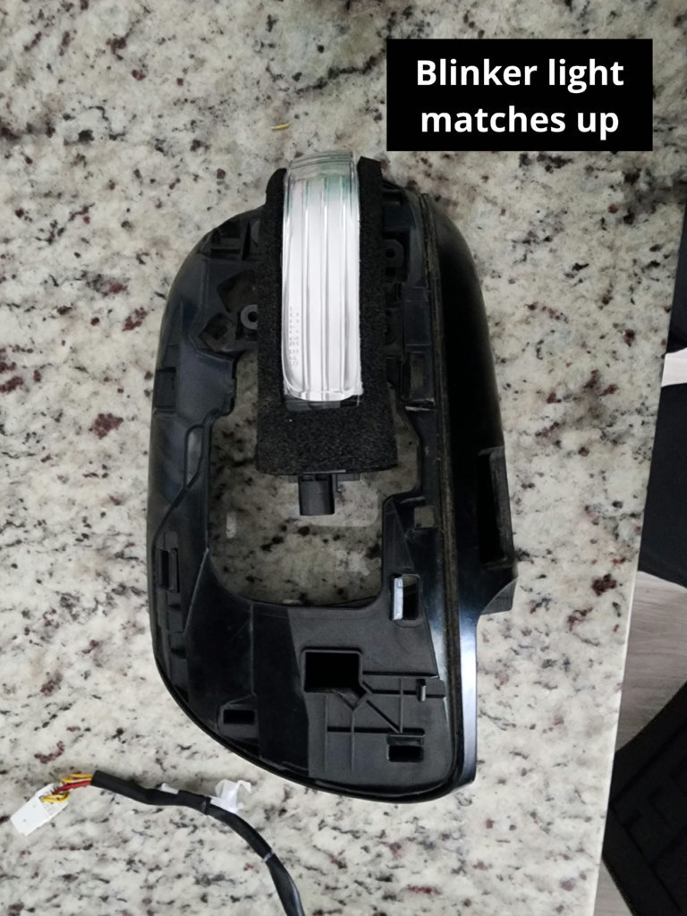

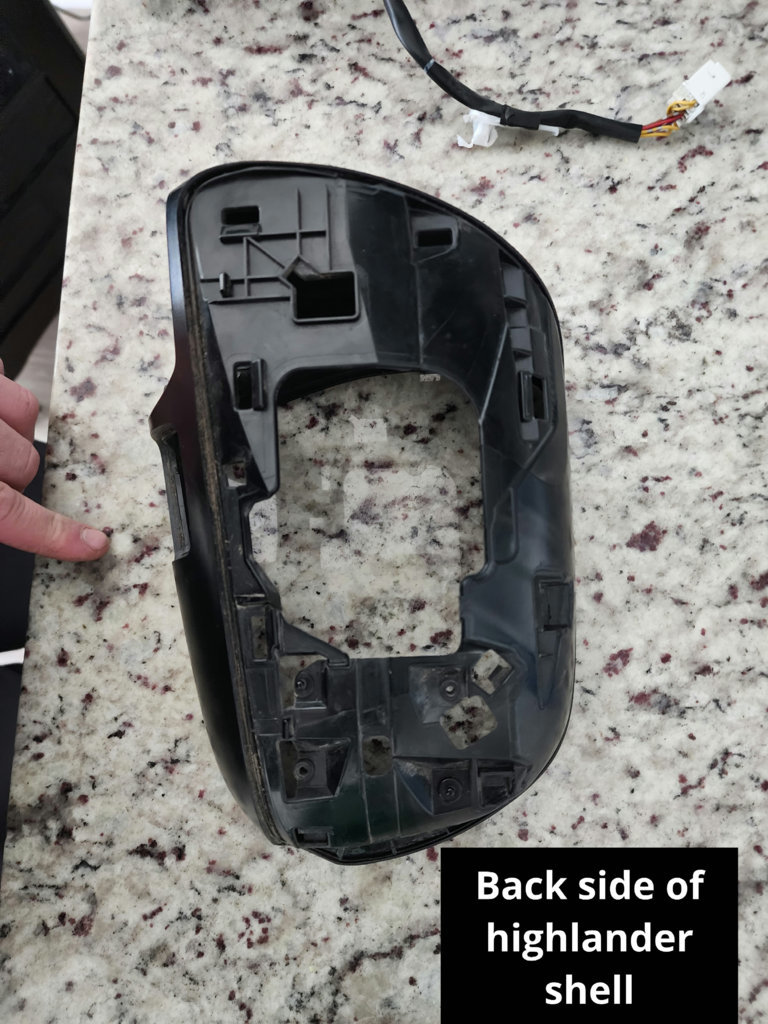

    The mirrors from the 08 Highlander have puddle lights. I ended up buying one aftermarket T4R mirror, but I'm probably not going to use it anymore.
    The side blinkers I bought just will need to have the wires run to them, but will otherwise bolt onto the Highlander framework.
    I had bought some power mirrors off an 09, hoping to do as you did and use the OEM internals, but the mounting points for the motor arm didn't match up, and I'd have needed to cut out a part of that arm for the puddle lights.
    So I'm returning the other T4R mirror I bought and I'm going to use that money towards some nice fitting OEM caps
    I just gotta finish my wiring harnesses so I can install them

  13. Apr 8, 2025 at 5:56 PM
    #133
    Levalexi
    Jun 10, 2019
    #295916
    435
    Southern Maine
    Here's the pictures I promised last night.
