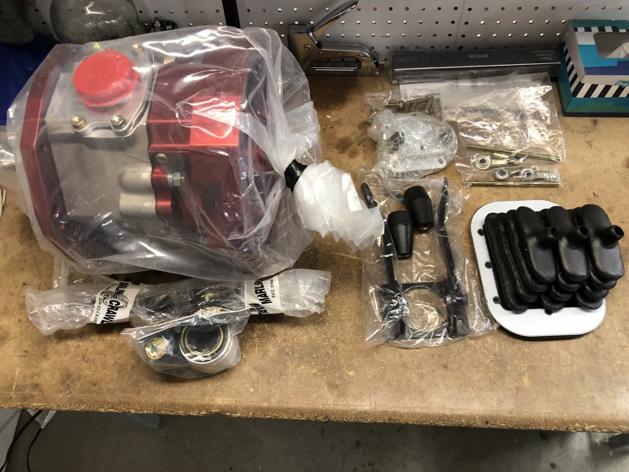

    My drivelines are in and it’s official everything works! I’m officially dual cased!

    Couple tips:
    • Don’t couple it with another project(like sound deadening the cab)
    • Don’t do it on a slanted driveway
    • Either make a jig for a floor jack or use a trans jack. I used a trans jack and it was very helpful
    • Take breaks (i don’t know how to do this lol)

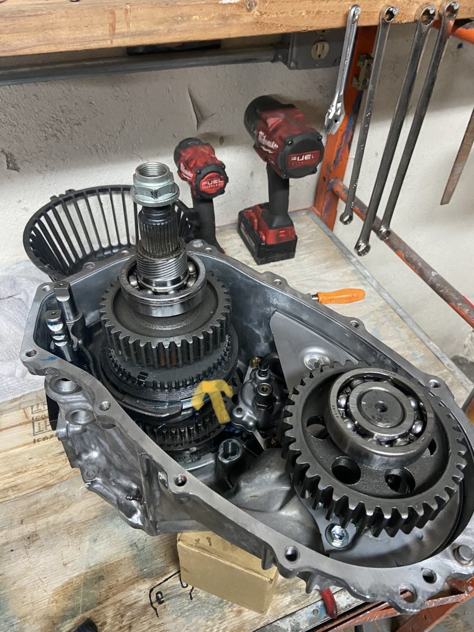

    Can anyone confirm if the upper/larger shift fork slider is in upside down or correct? I reassembled the whole thing and it shifts fine and seems ok but I saw one pic online where it looked like it was in the opposite of mine. Thanks

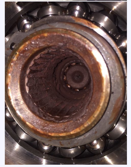

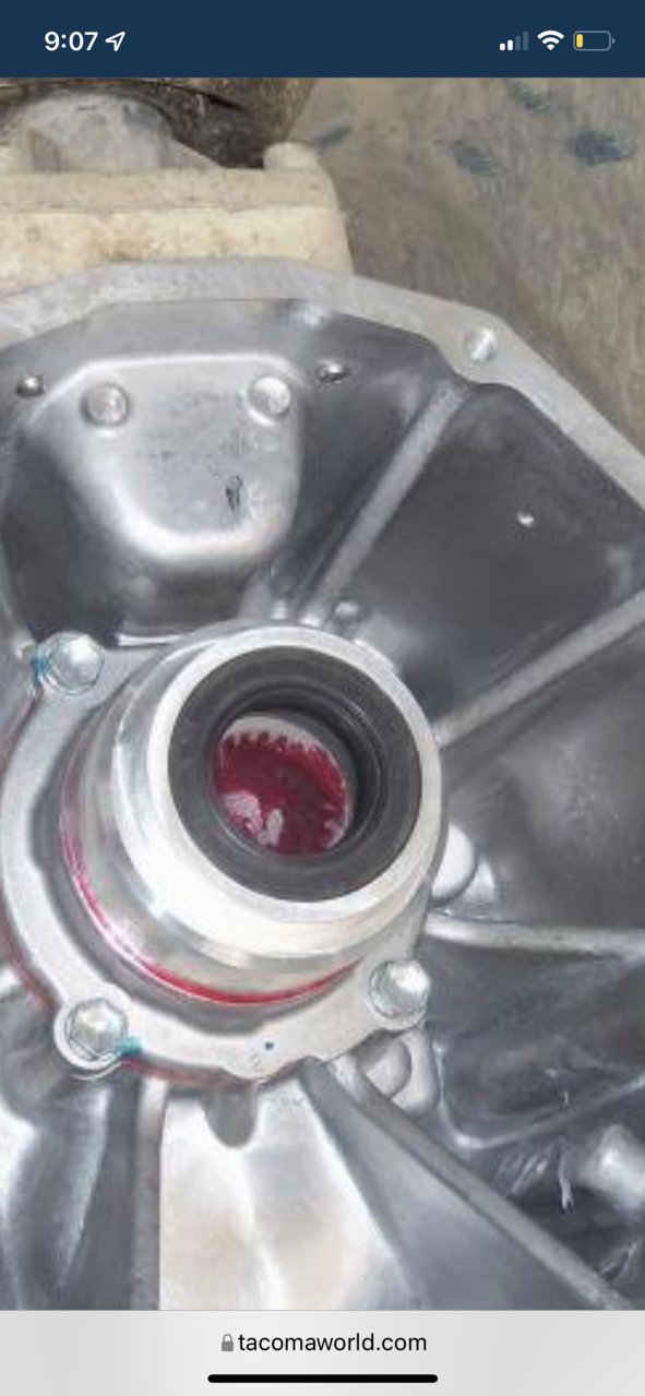

    Okay, so I was looking through this thread and seen a picture of the couple full of grease, I didn’t do this. This is a must? @betterbuckleup says yes, but just want to get more opinions before I pull them off just to grease that. LolC51428BA-21F9-4A09-9799-2955EFEB0E90.jpg

    I would agree, especially running a single row bearing (TG). You have a better chance of fretting the splines without running anything.
    While any grease or even antiseize is better than nothing, from the pic looks like Lucas Oil RED n Tacky that has additivies for high pressure.
    What you really want for this application is a high Moly content paste https://www.amazon.com/dp/B0083BWUYW to cover the threads with.
    slander and jubei like this.

    looks like my pic haha, yes def grease that coupling with something as Greg suggested. I used mobile 1.

    welp looks like I’ll be pulling it back out then, won’t be able to happen for a few weeks. Wish it was documented somewhere better that it should be done. Trail gear instructions just say install coupler. So much work, to just add some grease and slap it all back together. I did order that paste to use.

    Stuff is worth the $20-30. If nothing is used, you'll end up with this. Granted the total spline will help combat it, but not get rid of it. PIA to redo for sure, but that time spent will help in the long run of it. May look like rust, but is actually called fretting caused by intense force rocking back and forth.
    https://www.tacomaworld.com/threads/crawler-box-splines-keep-stripping.638372/

    Makes me wonder how much the antiseize I used is actually doing and if the gear oil just washes it out...

    I think there were other issues going on with that than just grease. I didn’t put grease on for the first 2 years mine was installed but did from them on. Didn’t have any issues during that 2 years.

    From what I've researched and personally seen, its been back and forth and not concrete that gear oil is making it up into that coupler where the fretting is occurring. Changing the fluid and keeping an eye out for RED tint will help with peace of mind.
    While antiseize has some properties better than normal every day tube grease, I always recommend the small Honda M77 Moly Paste just due to the amount of Moly it contains when compared to other items out there. One small tube is all you'll ever need.
    "- Primary Use – Part assembly; running in; as a press-fitting lubricant where high temperature is a factor. - Special Characteristics – Wider and higher operating temperature range than organic oil based pastes; extreme loads; low speeds.
    - Physical Form – Black, soap thickened, silicone fluid based paste containing more than 60% MoS2.
    - Applications – Lubricating during running-in of gears, splines, journal bearings, cams; reducing torque in tightening threads and bolts; lubricating bearing shafts, O-rings, packings and seals, brake assemblies; press-fitting.
    - Temperature Range – Solids from –50 to 750 degrees Fahrenheit (-45 to 399 degrees Celsius); base oil from –40 to 450 degrees Fahrenheit (-40 to 232 degrees Celsius).
    Pretty much engineered for what these Inputs and Couplers are seeing from the crawlbox.
