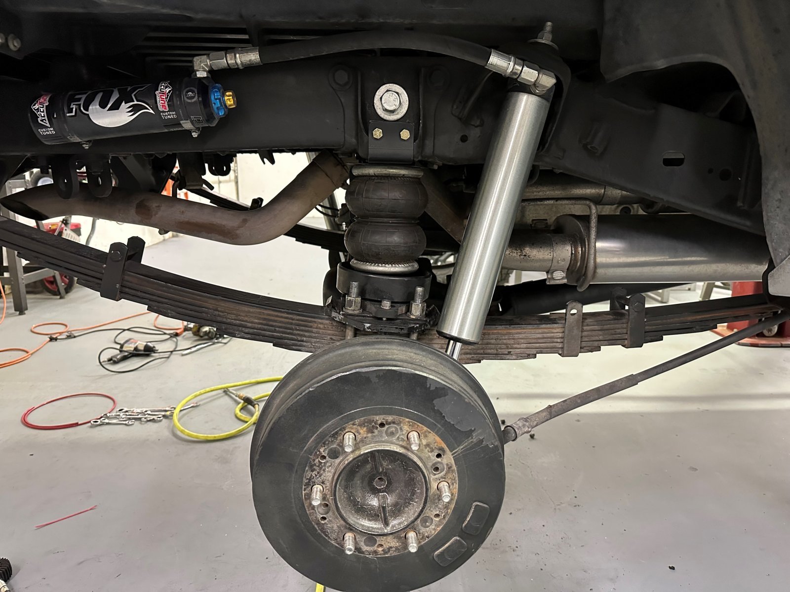

    This got me thinking. We can look into a designing a U-bolt Flip option specific for airbags.
    I saw a customer's truck that had the Firestone universal support brackets, they were all bent up, plus they were gouging the 2.5" Kings on both sides of his truck :cookiemonster:

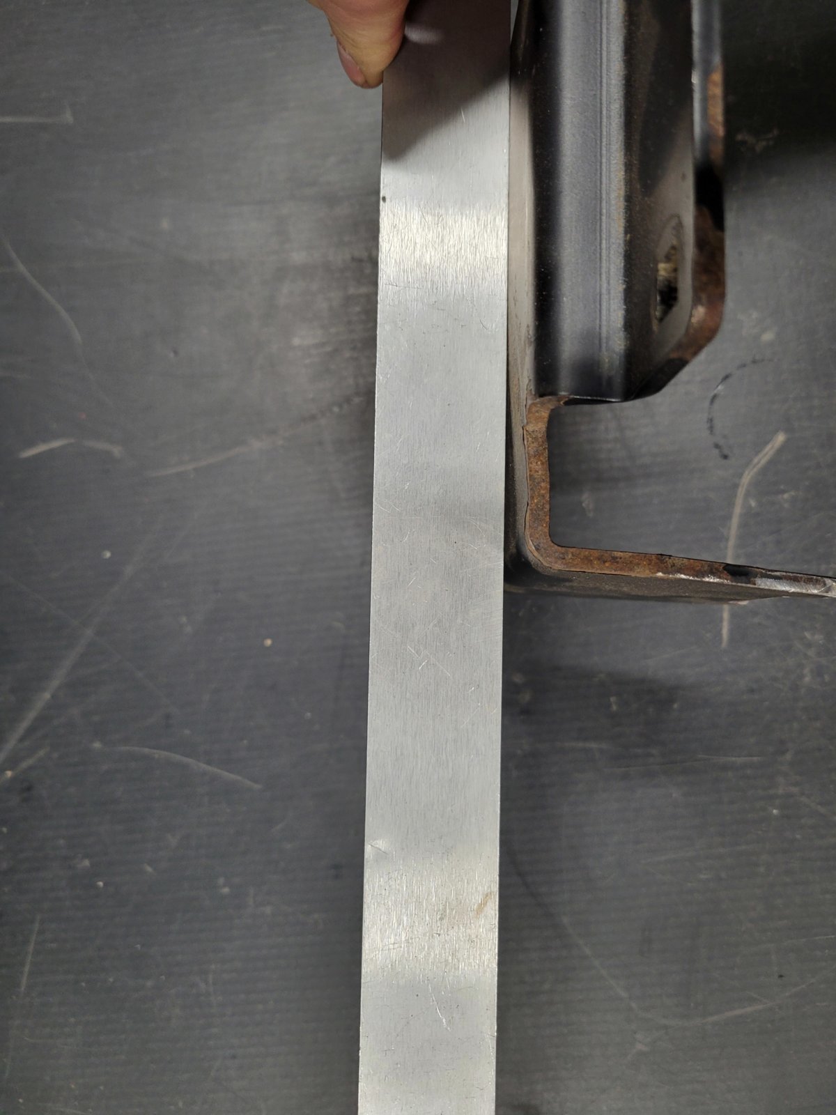

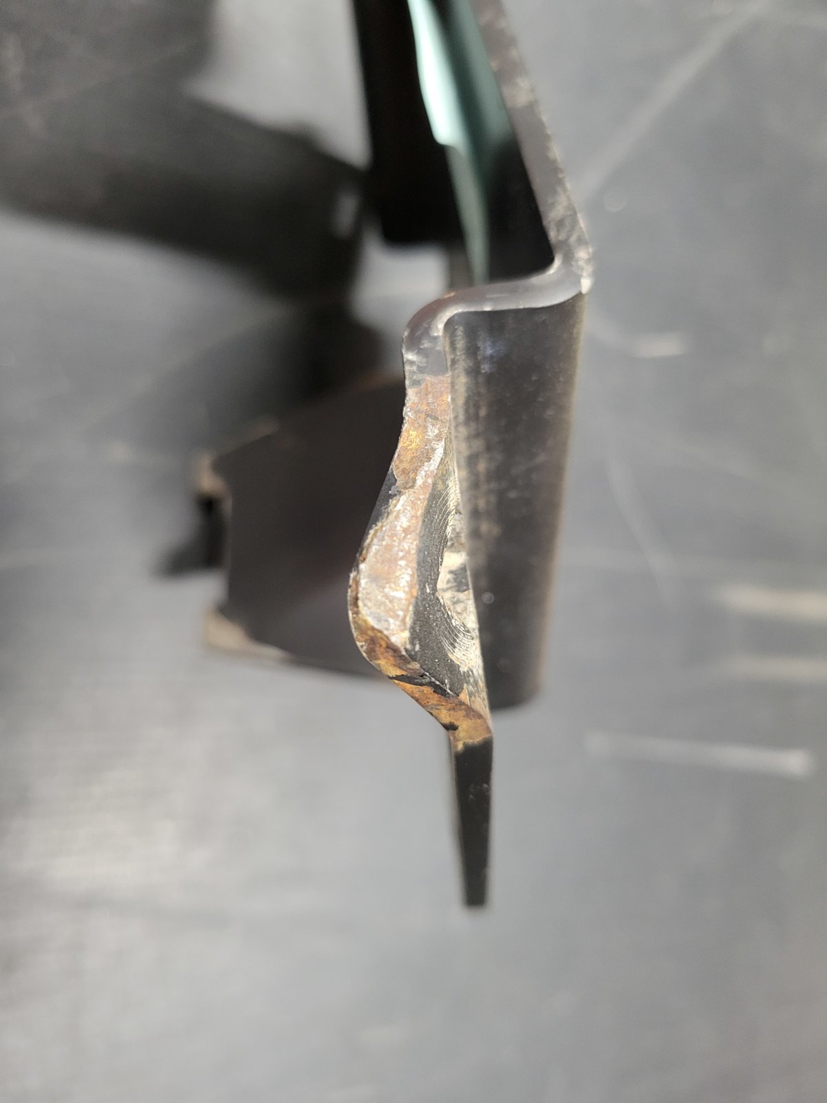

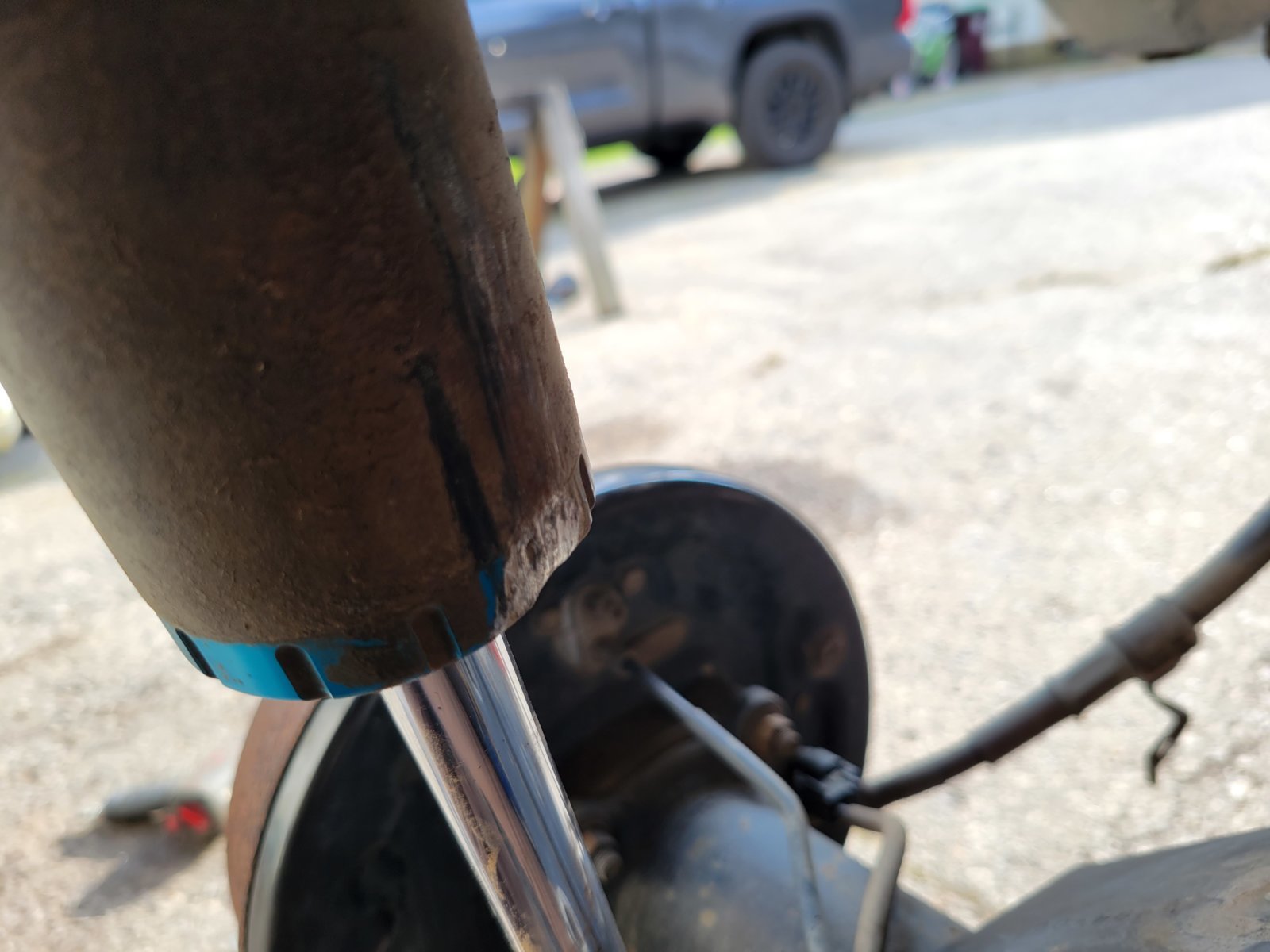

    After 8 yrs of usage, I removed my Daystars. No matter how much I tried to center them, the rubber bags rubbed on a portion of the cradle, on both sides. The ‘chafing’ started wearing out the rubber. I took them off before a hole wore through. I tried super gluing the point of contact but the flexing was too much. Using pic above, below shows the rubbing as on mine.
    ARCHIVE likes this.

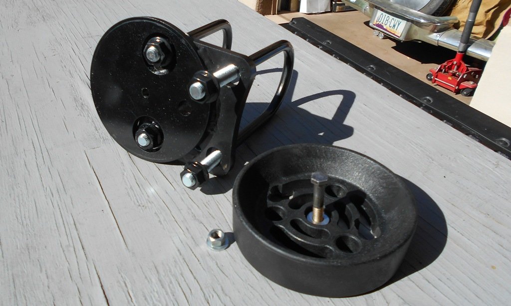

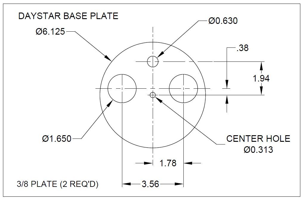

    Flip kit with added Daystar base
    base laminated onto a U-bolt flip kit
    kit base plate is 1/2" thick and the disc is 3/8" so thickness is much increased at the critical point.

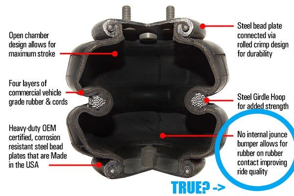

    Many people go this route because they fear a poor ride, and then this kit brings a harsh potential of bottoming out metal to metal that has bent frames on Tacomas, because the kit forces the removal of a chassis bumpstop.
    Don't fear a bad ride people. Step 1 is to install Archive Garage Hammer Hangers® to noticeably improve the rear ride quality, corner handling and durability, customers are often shocked how much Hammer Hangers® improve the ride. This allows you to increase the spring rate of the leaf springs without the feared poor ride. We also have a very affordable Add-A-Leaf designed for hauling weight, as well as our Archive Garage Leaf Springs which are praised for their ride quality, and it's all made in USA!
    We'll continue the work on a U-bolt flip w/ air bag support, but not having a chassis bumpstop is a very poor situation to be in for any offroad situation

    Metal on metal?? Isn't the rubber of the airbag itself supposed to be a bump stop?

    Yeah, it might only need to be tall enough to capture the end plate. The bags flatten under compression so it’s likely to rub somewhere if heavily flexed.

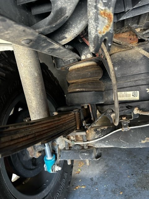

    IDK, looks pretty close inside the airbag the center nuts could get real close. Even if they don't you have a few thin layers of rubber, and that clearly isn't enough to protect the frame from bending, as I showed above. See quotes below
