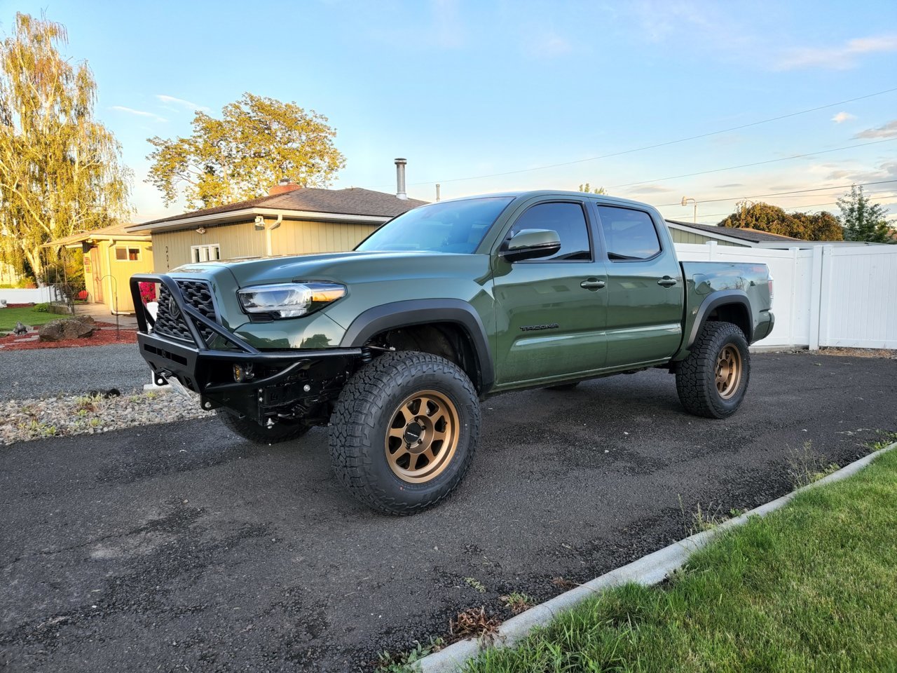

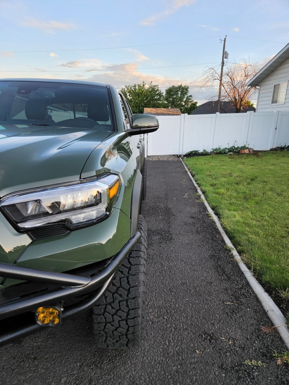

    I'm running 17x9 Method 701s in a -12 offset wrapped in 285/70/17 Falken Wildpeaks. Pic for reference on how far it sticks past the fender. With my C4 Fab front bumper I had no issues clearing in the front. CMC and plastic trimming was very much required, I'm finding places where I'm rubbing at full-stuff when offroading so I'm still fine tuning the plastic trimming.
