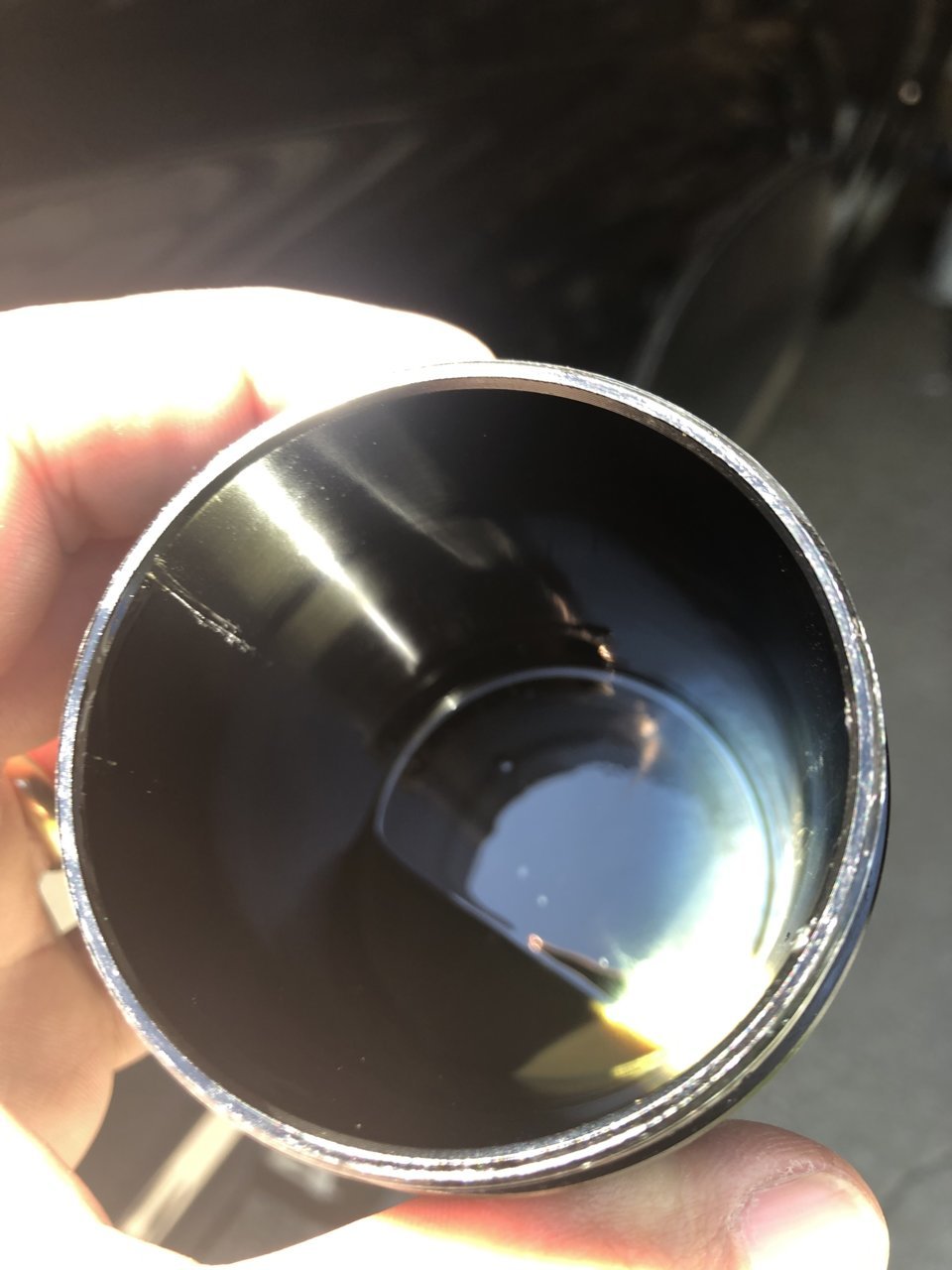

    It was only half an hour I was impatient.
    Funny but I did check it after an hour and nothing.
    I checked it often and got nothing for the first 150 miles.
    Seems running the interstate produces more than our 50mph secondary roads?
    Because I’ve done a lot of interstate driving at 65mph,,,,,,,
    And collected this in the last 150 miles.
    So this is what I’ve gotten in the last 300 miles.
    My truck also has 177k so I may have ring or valve seals that are weak.
    No regerts here this isn’t going into the combustion chamber now.
    Looking at how I could winterize this?
    CS_AR and Drainbung like this.

    Very nice!
    Jeffch[QUOTED] likes this.

    I can understand the concern. It took me a couple oil changes to get the feel for it. Now I run 6-7K and end up with about a third to half a can. I do pop the hood regularly and make sure everything is where it's supposed to be. There was one post/incident/story where the can backed off and made a hell of a mess.
    Lord Helmet and Jeffch[QUOTED] like this.

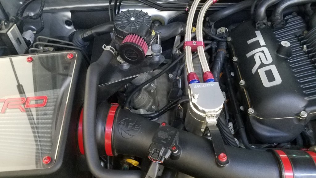

    What size bolt did you use, to lock into the top of the AFE intake?
  13. May 27, 2019 at 9:46 AM
    #1033
    Waited many moons
    Waited many moons Well-Known Member
    Jan 17, 2017
    #207897
    212
    Pat
    Honolulu, Hawaii
    2014 Alaska Edition
    Do you have pictures of brackets?
  14. May 27, 2019 at 11:18 AM
    #1034
    Waited many moons
    Jan 17, 2017
    #207897
    212
    Pat
    Honolulu, Hawaii
    2014 Alaska Edition
    What type of braided hoses did you use, and size?
  15. May 27, 2019 at 11:18 AM
    #1035
    Waited many moons
    Jan 17, 2017
    #207897
    212
    Pat
    Honolulu, Hawaii
    2014 Alaska Edition
    Also lenghts?
  16. May 27, 2019 at 11:42 AM
    #1036
    Waited many moons
    Jan 17, 2017
    #207897
    212
    Pat
    Honolulu, Hawaii
    2014 Alaska Edition
    What kind of Summit braided hose did you go with?

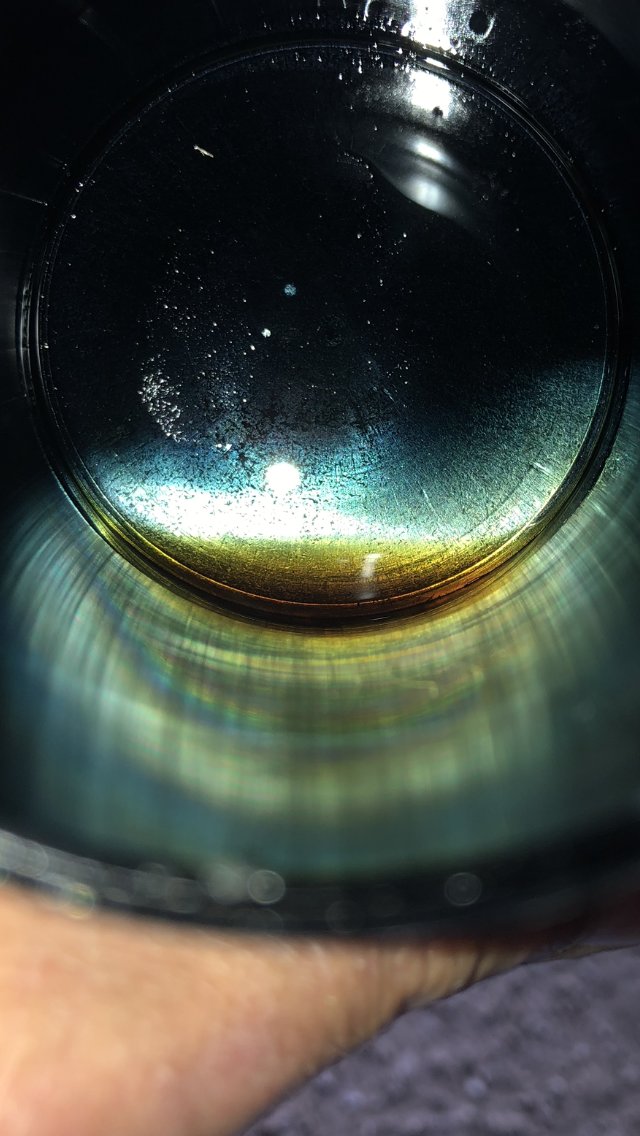

    So this was at 1000 miles.
    Stuff smells freakin nasty.
    AR15xAR10 and Drainbung like this.

    Well don't sniff it. It's doing it's job. Emptied mine on Saturday. Every oil change it's about 3/4 full.
    Norton likes this.

    I had too! :notsure:
    Taco-Obsessed likes this.
