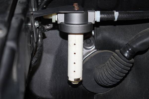

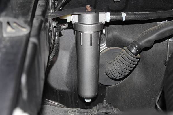

    I just made one from my old shop compressors water/oil separator. I upgraded the shop a few years ago and had it laying around. I only have about 15 miles on it since I put it in yesterday, but I feel pretty confident it will work well.
    I removed the filter and replaced it with a piece of PVC pipe with holes drilled on three sides (opposite of the return side) and filled it with a copper chore boy. The pipe has 3 notches cut in the bottom for the oil to drain out once it is collected and condensed on the copper filling.
    I figure the unit used to hold 175lbs of pressure without leaking, doubtful it will leak with the little pressure it is under now.

    ^^He shoved copper scrubbies inside the PVC pipe for the oil to collect on. No need for baffles if you do this. Of course you don't want ANY catch can to fill all the way up.. so it's a maintenance item and needs to be drained or checked regularly.
    Count Macula.. awesome home made catch can! I bet it will function better than most on the market. And it doesn't even look like a catch can - looks like a factory emissions thingy dingy.

    Thanks! I was going to buy the can linked above but figured I'd give this a try first. I figure if it didn't work, I only have about $6 in parts invested. After 200 miles I am amazed at how much water I have in the bowl, there is a little oil as well but not a ton of it. I run 5W-30, and don't run the truck hard so, I don't know we will see after a few more thousand miles for my next oil change.
    The truck feels like it idles and runs smoother since I put it in though, maybe its all in my head but so far I am pleased none-the-less.

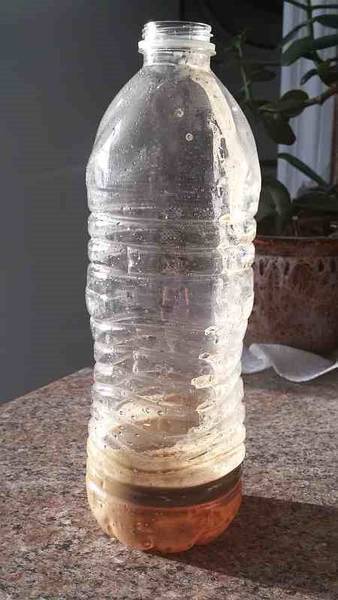

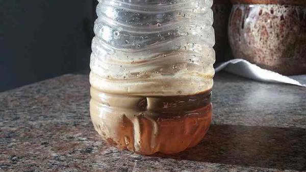

    Update on my can, this is what I collected after 500 miles. Lots of water, a little bit of oil. I only live 9 miles from work, I know thats why I got so much water. I am very glad this isn't being recirculated through the manifold.
