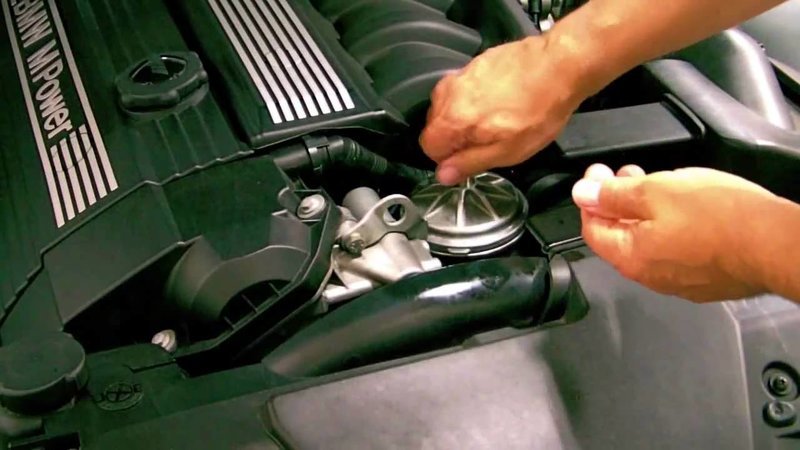

    This style filter housing is great, when located on top of engine. I had a few M3 years ago and the oil change was super easy; unscrew banjo bolt, remove lid, pull paper filter up and out- easy day.
    I wish all the manufacturers would adopt this top style paper filter. My sister's Pontiac had it, but the housing was plastic.

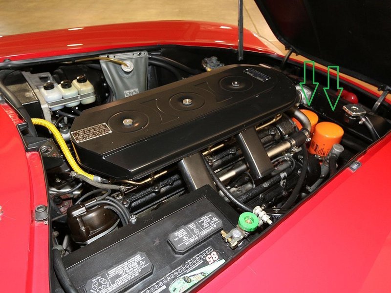

    I had a neighbor in high school who owned a Ferrari 275 GTB four cam. He sold it, like an idiot, to buy the Knight Rider styled TransAm when it came out, right before the value of the 275 skyrocketed. Any how, the 275 used two spin-on filters mounted high and facing downward. The system was a dry-sump design pumping 17 quarts to/from a reservoir mounted behind the passenger seat, iirc.
    Tacoma oil changes seem so much easier to me. =)

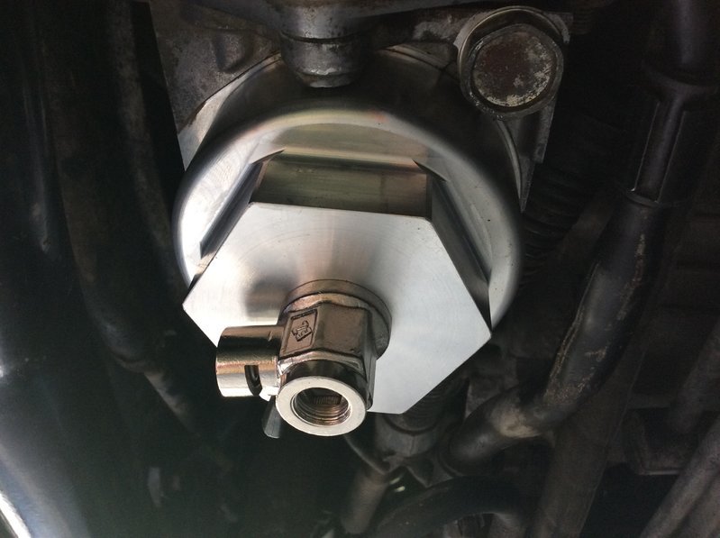

    About to make the oil change a bit easier. A regular drain plug can be utilized in place of the locking Fumoto/EZ Drain, for those that are uncomfortable with that design. The six point socket will never become stuck.image.jpg
