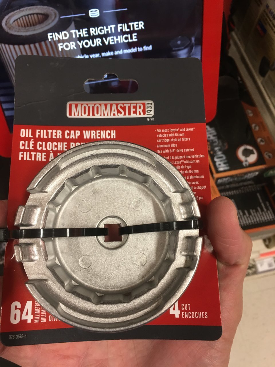

    1bad2k, peavey02 and brny67 like this.

  17. Nov 13, 2018 at 1:01 PM
    #457
    Boricua
    Boricua Well-Known Member
    Apr 22, 2018
    #251290
    512
    Jack
    2018 TRD Sport
  18. Nov 13, 2018 at 1:32 PM
    #458
    05Taco4x4
    05Taco4x4 ToyotaHubs
    Jun 29, 2011
    #59085
    6,280
    2TR-FE Enthusiast
    FJ Tcase, Manual Hubs, 2017 Head unit, Mirror Riser
    Yes, of course. That’s what the wrench beside it is for- it clears the valve.
