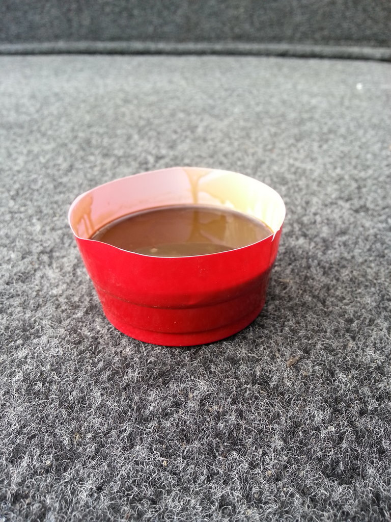

    Justus is just making a good point that the statement "if the OEs are ok with it, it must be cool" does not carry a whole lot of weight at times. Working in the engineering field, and now around it, my hat is off to most all OEs as far as the amazing job they do with years of R&D, manufacturing processes, taking thousands of parts from hundreds of suppliers, assembly etc etc and deliver a working product at a price normal people can afford. Despite Murphy's Law plus oversights, plus leadership and bean counter pressure, some manufactures do a really good job, some not so great, all of which in todays information age allows that it is common knowledge who is good and bad at this thing. A little OT but I've been in the game a while now, including the business side and IMO Toyota has been loosing ground to the bean counters. I'm not nearly as inclined to buy a new Toyota/Lexus/Scion product as I would have been their older models. The TSBs my wifes Scion tC has had, then the IS250 compared to my Taco and IS300 are in totally different leagues of "oops, our bad". I can understand some changes made due to CAFE and that gets a write-off from me, but some are pure bean-counting or engineering oversights that are not acceptable.
    The pics are not loading for me except for the actual cup of oil, but that was some good catching with an ebay can. 90% of the ebay cans are simply empty cans with ports in them, there is NO internal baffling/filtering etc going on in their insides. In ebay's deffense, catch cans did not hit the scene with advanced seperation in mind, they were simply there to catch large globs of oil from vent to atomosphere systems to get on the road surface (track rules).

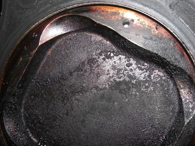

    Here is an example:
    Kind of hard to tell, but on the rings and ring lands. After 30K miles.
    That build up over a long time can decrease power due to valves not sealing completely, and causing a loss of compression. Rings not being able to seal as good as they once could due to being gunked up and stuck.
