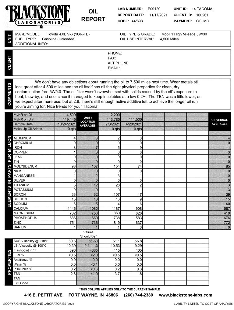

    For those of you asking about what they say, here's a copy of a recent report I received. Good report as you can see, especially compared to the universal averages for a 1GR-FE w/ about 120k miles on it.
    I bought this truck from my FIL and wanted to get a baseline on how the motor looked internally, hence the number of reports in such a short period. The oldest report shows the last oil fill by my FIL at about 6k-7k on the oil. I won't be doing another report until I hit 150k or so, especially given the wear trends from the last two reports.
    You can go to Blackstone's website to see examples of bad reports. I'm sure there's a few bad reports on this website if you guys are willing to use your Google-Fu

    Ok.... I figured there was only a report about metals and liquids.
    Nothing to indicate a potential for oil to produce varnish.

    The Blackstone report posted above does have TBN listed as 2.6 which means the oil still has some life left. TBN loss is not linear so the owner could have gone an extra 500 or 5000 miles and TBN would have been 1 at that point.
    Blackstone charges extra for TBN analysis, which is why I switched to ALS Labs (same as Wix oil analysis kits on Amazon/RockAuto) since they include TBN in their particle analysis cost. ALS doesn't give you the typed out analysis like Blackstone, but still lets you know if any data points are outside of acceptable ranges.

    I must have been blind or too much in a hurry. I just skimmed over it and didn't notice that it had the TBN on it.
