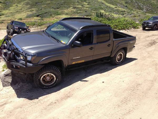

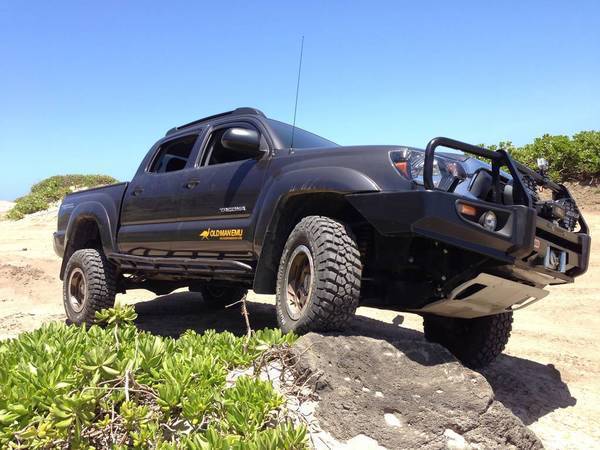

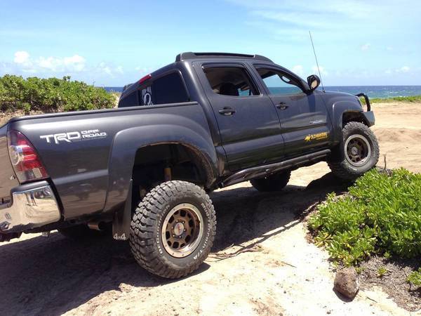

    SUSPENSION ARB Old Man Emu BP-51 OME Internal Bypass coil overs and rear shocks Suspension ARB Dakar one ton Rear Hi-Lux Leafs EL091 U Bolt Flip Kit Firestone Ride-Rite Air Helper Spring Daystar Universal Air Bag Cradle Wheelers Front Super Bump Stops SPC Performance Adjustable Front Upper Control Arms All-Pro 4" Steel Braided Brake Lines EBC Green Stuff Brake Pads WHEELS TIRES TRD 16-in Off-Road Beadlock-Style Alloy Wheels Bronze BFGoodrich Mud-Terrain KM2 255/85R16 with matching full size spare. ARMOR ARB Deluxe Bull Bar with Quadratec Q9500is Winch with Dyneema Synthetic Rope B.A.M.F Kick Out Rock Sliders PERFORMANCE ARB Safari Snorkel TRD Performance Exhaust System INTERIOR Clazzio Leather Seat Covers LIGHTING ARB IPF 900XS Extreme Driving Lights Rigid Industries Dually Flood Lights All interior lighting swapped to LED's AUDIO Front Doors: Rokford Fosgate p1694 6x9 Rokford Fosgate Tweeter P1T-s Back Doors: Rokford Fosgate P16 6 ½ OTHER Custom Martin Truck Bodies Aluminum Flatbed Weather Tech Window Rain Deflectors Bird Dawg Tech Extreme Deck Gadget Mount PrinSu Design Aluminum Roof Rack T6 Aluminum Devil Horn Toyota Emblem Ceramic Window Tint Bushwacker fender flares
    [​IMG][​IMG][​IMG][​IMG]
    What did you put up front & what did you get?
    886s N186S
    What did you put in back & what did you get?
    Dakars N186S
    If you got Dakars on a 2nd Gen share your measurements with OZ 2nd Gen OME Dakar hub to fender measurements ( 1 2 3 ... Last Page)
    Been there done that.
    Are you running trail armor & how much lift did you loose or what did you do to regain/maintain lift?
    I am running BAMF kick out Sliders, ARB bumper and winch, aluminum TRD skid plate
    After 2000 miles I'm now 22 1/2 front and 24 1/2 rear. I would like to get another Inch some how out of the front.
    It rides better that it ever did stock.
    Tire & wheel specs & rub or what you did to eliminate rub.
    TRD Bronze simulated Bead Locks with BFG 265/75 16 KM2 No rub & no trim.
    Are you still running a sway bar?
    No and it rides even better off road and I cant even tell its gone on the road.
    What would yall suggest I do to bring the front end up about an inch to compensate for the extra pounds she is putting on?
