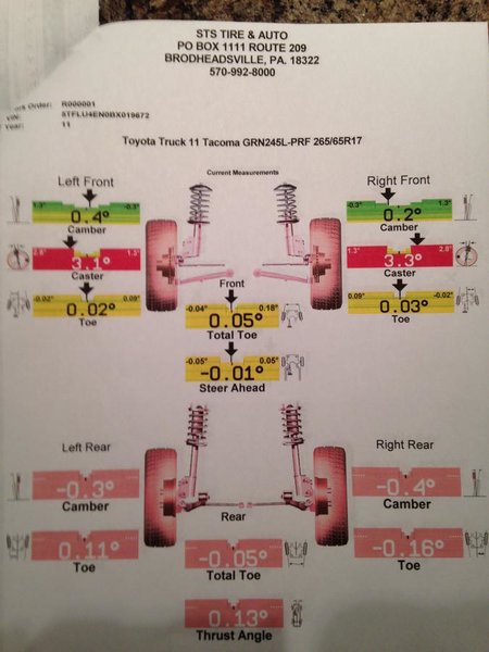

  10. Jan 6, 2014 at 4:56 PM
    #3270
    joeybags
    joeybags Well-Known Member
    Jul 17, 2011
    #60054
    178
    joe
    pa
    2011 4x4 trd sport mgm
    new lift ome 885springs daker leaf, very happy new control arms also.

    Great alignment numbers Joe. Are you running 285s? I couldn't get the DBs at my alignment shop to see the light on my caster request with LR UCAs.
    "Well we dial in all our customers at .75 to 1 deg if caster." LOL

    im running 265, when i added the fuel rims got a little rub at full lock on the mud flap may have to go bye bye. it feels straight when i let the wheel go.

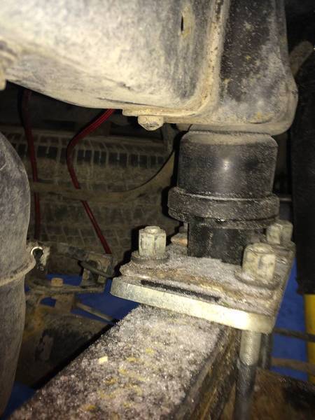

    Finally got my lift on. Im running the 886 coils up front and dakars in the back, with the nitro sport shocks all around.
    I was running the 886's with just a skid and sliders for 2 weeks, and though the ride was stiff, it was not intolerable. With the bumper on it ride likes a dream.
    Got the superbumps in the rear and they are fantastic. Soon to have the superbumps in the front when I have a wrench big enough to take of the stock bumps :p.
    All in all super super happy
    Super bumps with flip kit
