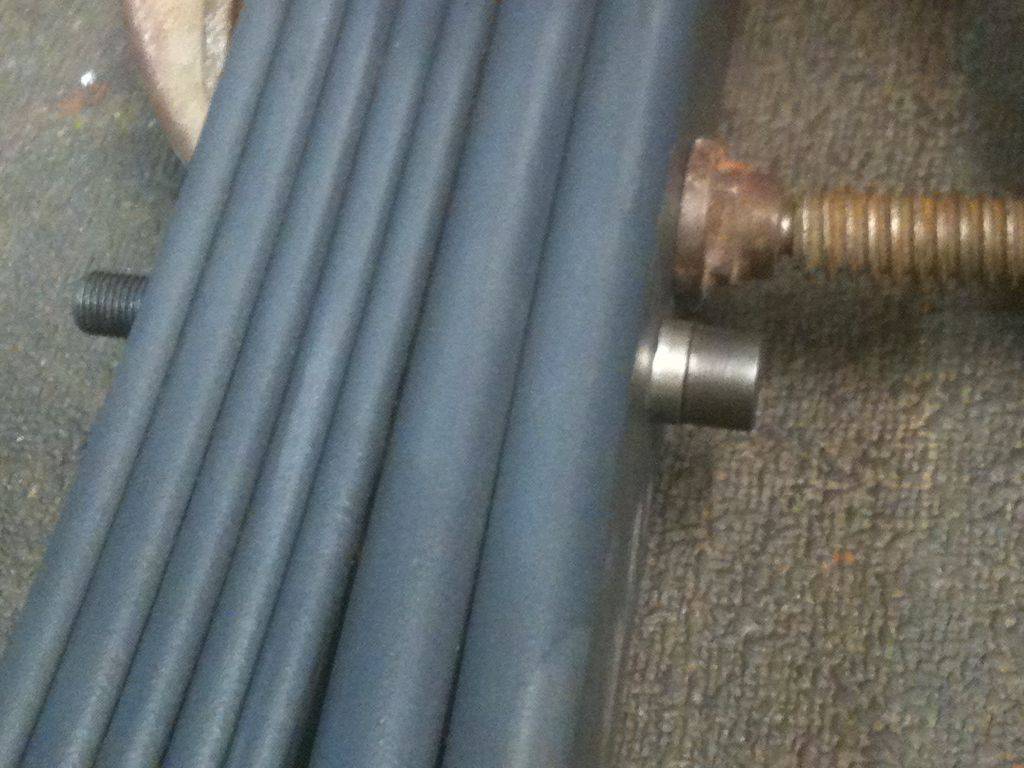

    So i just picked up my new CS047R dakar leafs. Just wondering what you guys think about using shims to correct for pinion angle ? Can they be added after i install the dakar's ?
    Thanks

    Depends on which style of shims you use

    Right. I've seen some with a slot down the middle, which I would assume could be installed at any time. I guess i won't know if i need to shims until i drive the truck with the dakar's installed. Or should i just throw them in for the heck of it ?

    I would try it without personally , get collars for your centre pins , that projects the head of the centre pin out of the pack an additional approx 1/4" , then if you need to add shims later your leaf pack will still be well seated in the axle

    I used the 3-5 degree shims from toytec seems to work fine and help with the angle. Though I didn't install the Dakars without the shims so i can't tell ya if there will be more or less vib with our without them. If you do go the shim route it's a good idea to buy longer centering pins or a extension (spacer) to make it longer.
    As far as adding it after the install.... Well you would have to uninstall and pull the u bolts.... Blah blah etc.

    Just getting longer pins doesn't acheive what the collar does

    This is true, that's what I ment, I got the collars for mine when I ordered my Daks. Toytec sent me longer pins with my shims that I didn't use just for that reason, plus the stock Dakar pins are long enough with the added collar anyways.:)

    You want it to look like this

    ^ exactly what I did.
