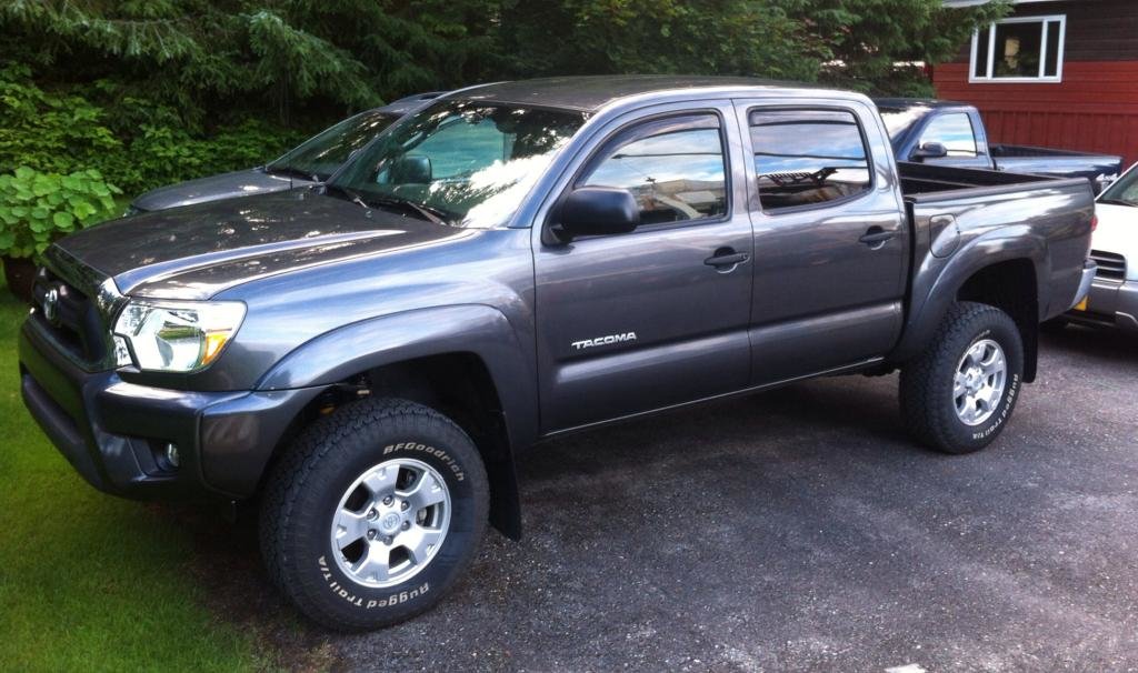

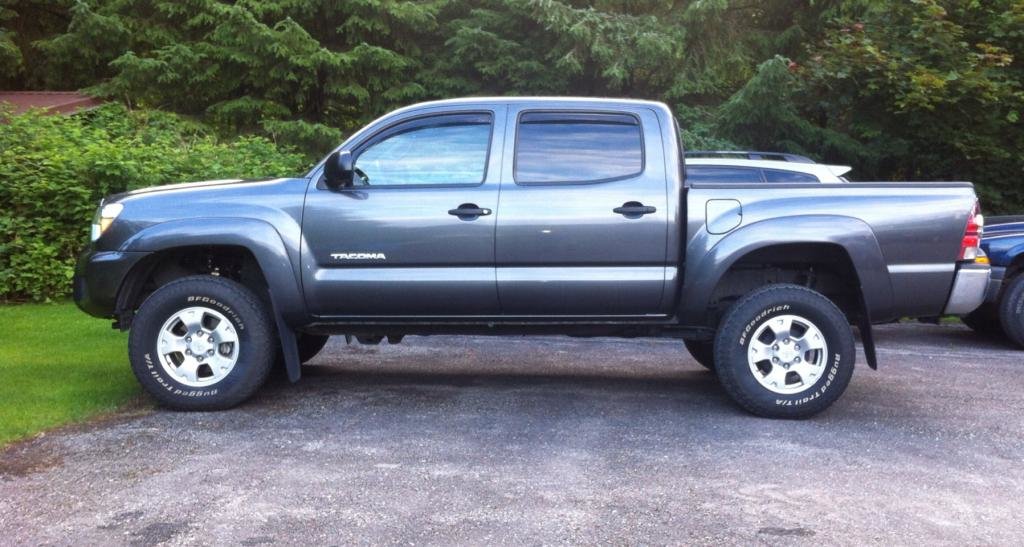

    The lift is finally on. OME with 887 coils and Dakar's. LR UCA's, sway bar relocate and SuperBumps all around.
    FC79F283-D8FF-40B2-A78E-4E4FA749E8D7_zps_46db27d1599c597e0cf447d2f1ba3b0674c6458b.jpg
    4D4F102A-D014-42BB-B300-D2D97C743D28_zps_2d295bd8684df4ba2f61f4882644c2b3bd97e99f.jpg

    Looks good

    I'm happy with it and it was worth it. I'm already eying some tires to fill that wheel well. I was planning to wait till the stockers wore down but they're still practically new. It's handling speed bumps like a champ.
    I did the carrier bearing drop, but there is a slight vibe at 25. Are both shafts supposed to be in line with each other? I'm thinking about putting in axel shims, but I just need to figure out how many degrees I need.

    How do the Dakars cycle with the UHMW strips installed ?
