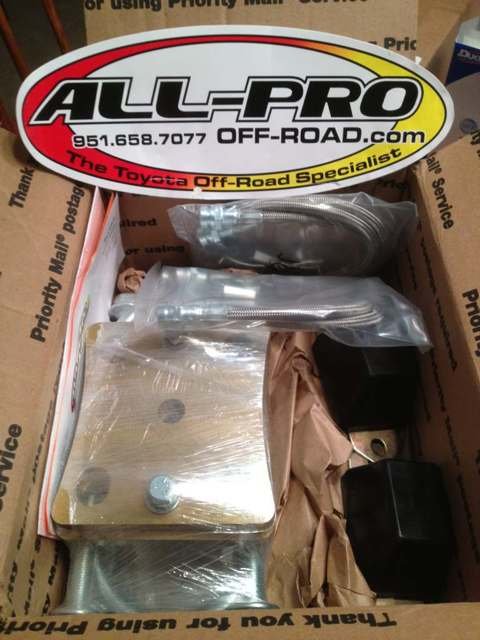

    I did a search and came up with 2 threads and I think it will work but...looky here
    Can I use napa part# 904900 so I don't have to take apart my existing set up. I'm supposed to get my ome coils/sport shocks assembled today.
    I sent 'thatSchusterguy' a pm. It looks like it worked for him after he removed a rubber gasket

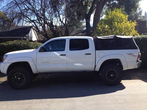

    Finally able to get a level pic after the OME Install.
    Set up: 885s on OME shocks, trim packer, .25" top spacer. Rear Dakars with 3rd leaf removed. Front = 23 7/16t Rear 23 3/8.

    Nice but in the 2 pics I see one the front looks low & the other it looks high (JK).
