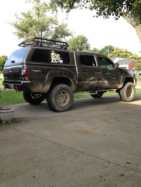

  15. Sep 28, 2014 at 4:53 PM
    #5335
    HHogrider
    HHogrider Well-Known Member
    Oct 19, 2013
    #114772
    105
    Mark
    Lexington, KY
    11 Tacoma Sport Pyrite Mica
    Tint, ARE Z-Series Cap, Yakima rack on cap, ROLA basket, SCS Stealth 6 Matte Gunmetal with full size spare, 285 Terra Grappler, OME lift (885's with Top Plate Spacers, full DAKARS, Carrier bearing drop, stainless extended rear brake lines, BORLA cat back exhaust, color matched All-Pro rear bumper
    OME made it to the top!
