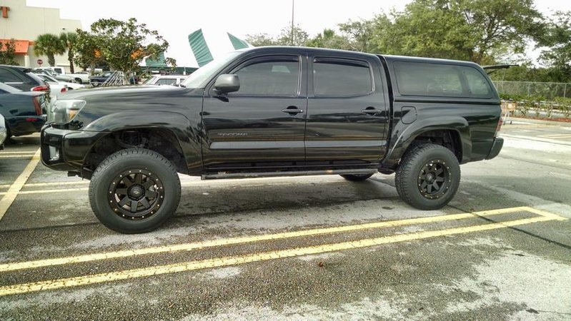

    So if I haven't posted this picture yet. This is what my truck looks like with 885's up front and all pro in the rear. Rims are 17's with Cooper RTX 265/70/17

    Looks to be a bit of bro-lean going on. You get the front end aligned? How long have hey been on? Front settled in at all?

    I had my stock tires in the bed. Needs a realignment, pulls to the right a bit. And the shocks are all settled they have been on since like june
