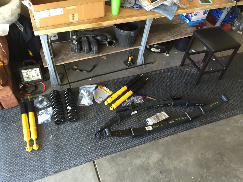

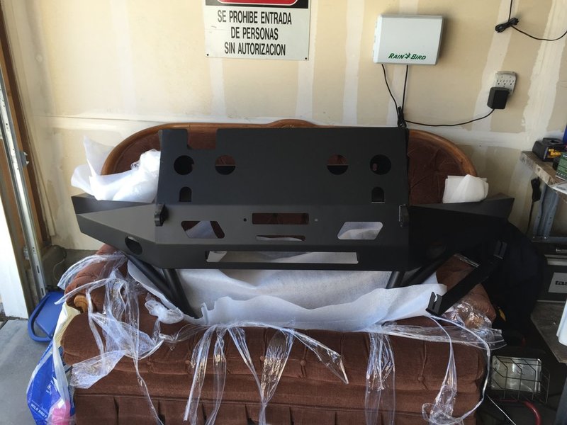

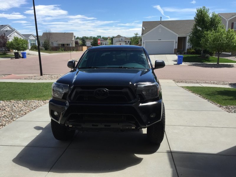

    Just got back from my deployment to all my goodies!
    886/nitrochargers/dakars and pelfreybilt plate bumper!image.jpgimage.jpgimage.jpg

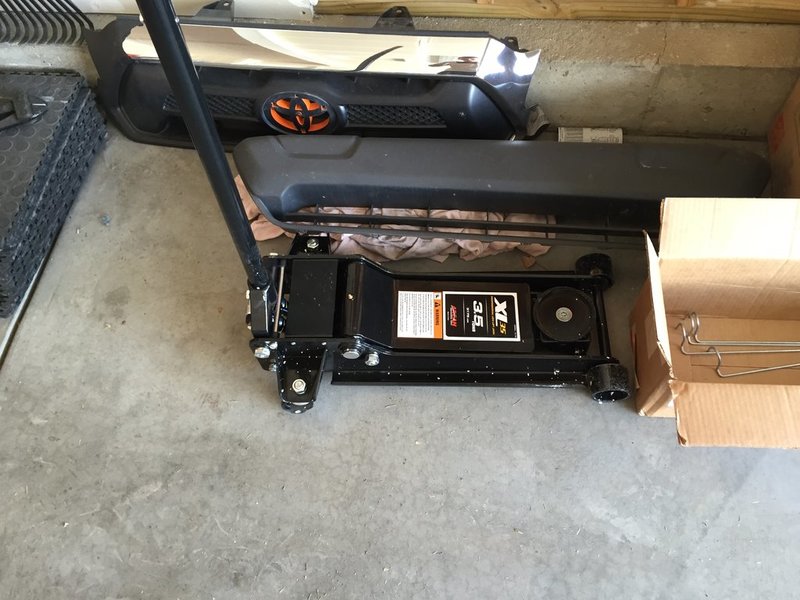

    image.jpg Oh yea, and I picked up an arcan xl35. Best built jack I've ever seen or used for under $500

    Yea I'll probably do the install next week. I have to do some stuff at work first, but then I have 2 weeks off. Install of the suspension will be easy by myself, but the bumper is gonna be fun to do by myself with an engine hoist lol

    This is literally the exact set up I'm looking at for 2015 DCSB. What made you go with the 886's? I'm looking at the 887's. Hopefully placing my order for all that stuff here soon.

    I got the 886 because of the bumper and I might add a winch eventually. If I recall correctly, the nitrocharger shocks don't work on the rear of a 2015

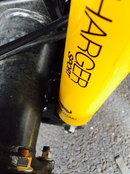

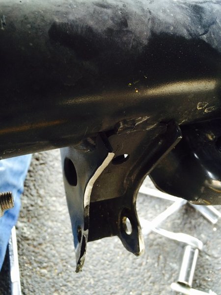

    There is some debate about that, some fit fine, others don't by a hair, and it may require grinding down the gusseted portion of the bottom shock mount to finesse them on so the very bottom of the shock tube does not hit them. I believe there are pics of this a few pages ago.

    Here ya go before and after. ;)
    I had to shave about 3/16 (both sides).

    ^^^ that's the stuff.
