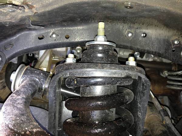

    Looks like the three nuts on top of the shock tower(not the long one in the middle) may not be torqued enough, its hard to tell on my phone tho. Im sure yout tightened them alot when you installed but did you double check to make sure they are tight once the truck was off jack stands and sitting on its own weight?

    Ya i see that gap also, doesnt look right. It looks like you can see part of the stud also, like the top plate isnt sitting against the underside of the shock tower correctly

    Exactly

    Trailtaco, how much thread is showing on the long middle bolt on the drivers side, does it look the same as the passanger side?

    oops thought that pic was after everything was tight. Just ran out side and snapped this pic.

    Ya that looks better, i was just about to say it looks like a nut is missing in the first picture of the drivers side. How did you do the install? Did you loosen the LCA cam bolts?

    No didnt loosen the cam bolts. Install was -> Remove sway->Ball joint bolts->remove shock->reverse.
