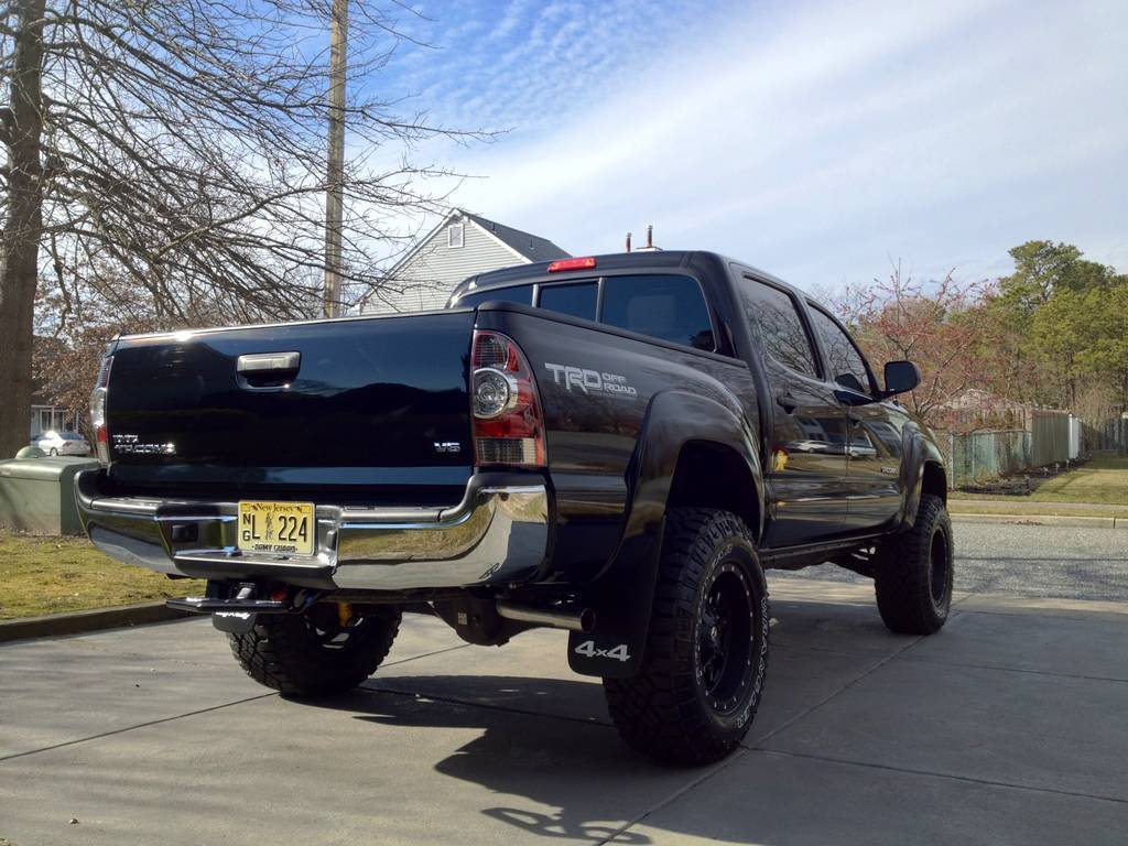

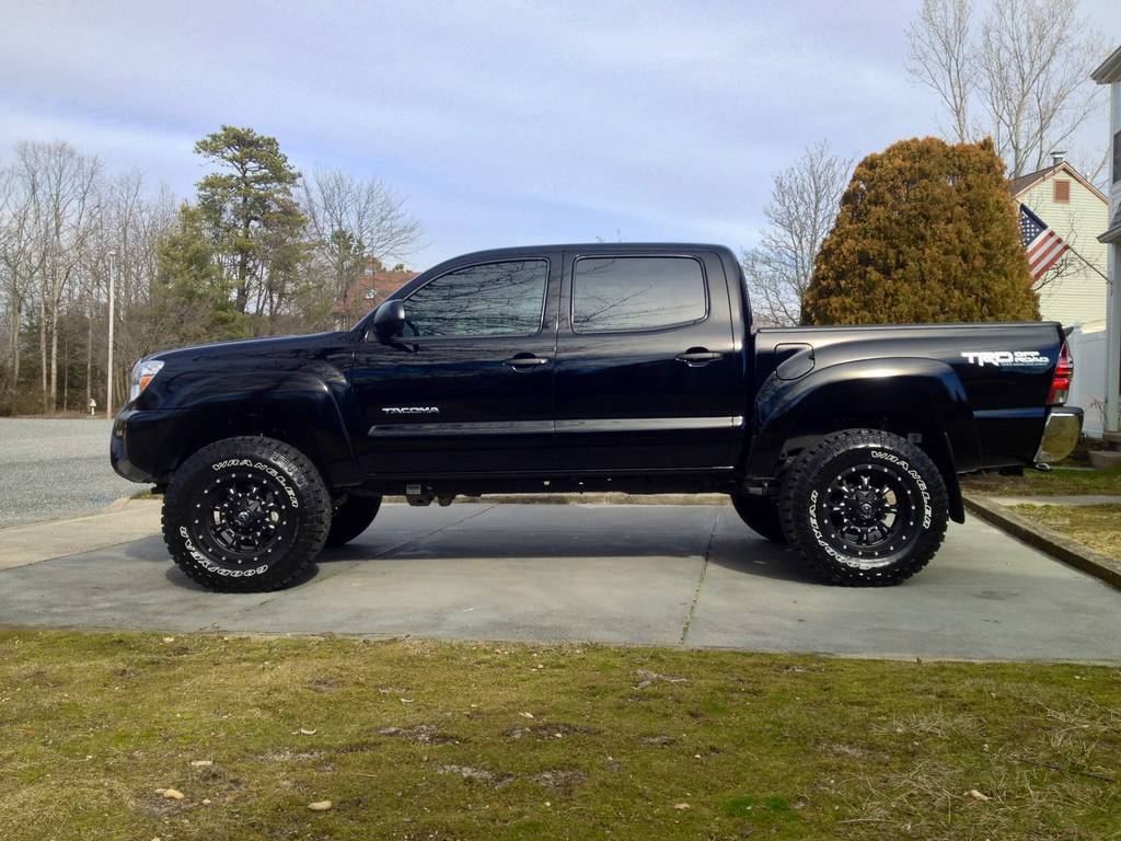

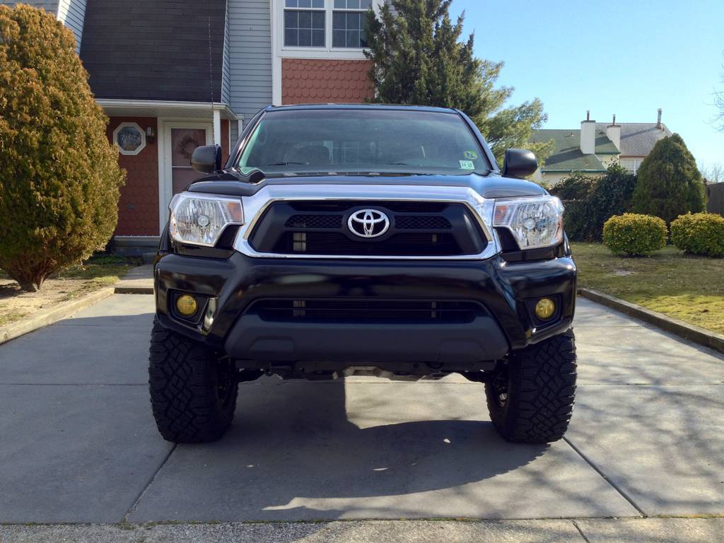

    parents driveway slopes down a little bit, but you get the idea. i think the truck is pretty level maybe 1/4 -3/8 higher higher in the rear

    that would help, sorry.
    885 w top plate spacer for full 3", 9000 shocks front and rear, dakar leaf packs, trim packer for taco lean. total chaos upper control arms
    17x9 4.5 back space -12mm wheels
    285-70-17 Goodyear Duratracs

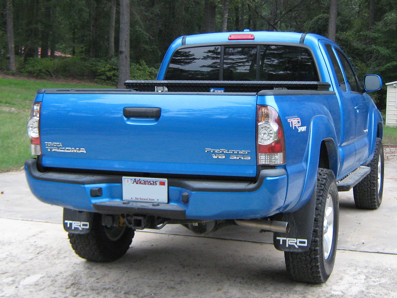

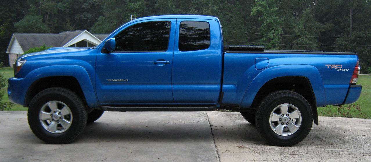

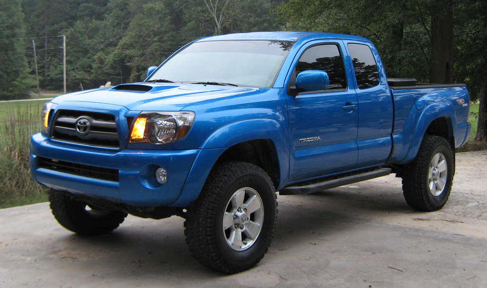

    If you have OME post a pic or two & tell us what you got.
    tons more pics in my build thread. :)
    What did you put up front & what did you get?
    > OME 90000 NitroCharger Sport FrontShocks
    > OME 885 Coils - no top plate spacer
    > Light Racing UCA
    slightly less than 3" but I didnt measure that close.
    What did you put in back & what did you get?
    > OME N182 NitroCharger Rear Shocks
    > OME CS047 Dakar Leaf Spring Set -coated with ez-slide
    > OME FK29 Driveline Carrier Bearing Drop
    somewhere around 3" but again, havent measured that close.
    also have a slight rake still, which I like.
    Are you running trail armor & how much lift did you loose or what did you do to regain/maintain lift?
    no armor.
    Tire & wheel specs & rub or what you did to eliminate rub.
    > Stock Sport Rims
    > LT 285/70R17 BFG AT T/A KO
    > 1.25" Spidertrax Hubcentric Spacers
    trimmed the plastic alot and removed the front flaps. skipped the cab mount chop. no rub 99% of the time on-road.
    Are you still running a sway bar?
    yes, with a relocate. felt weird with the bar off.
    if you have specific questions, pm me or ask in my build thread. :)

    i have very minor rubbing towards the rear of the front fender (near the cab mount) it only rubs in reverse, or if i go up my drive way on an angle too fast. no rubbing on the fender or wheel well towards the front of the truck. (my alignment specs are not what i want them to be at my caster is at 1.4 and will get them to move that up to 2.8+++ probably this coming weekend, that should alleviate some the rubbing issues near the cab mount in reverse.
    i trimmed very very very little to hold me over till i get my second alignment. trimmed small pieces off the fender and wheel well lining near cab mount so far
    havent wheeled it yet so i dunno whats gonna rub off roading
