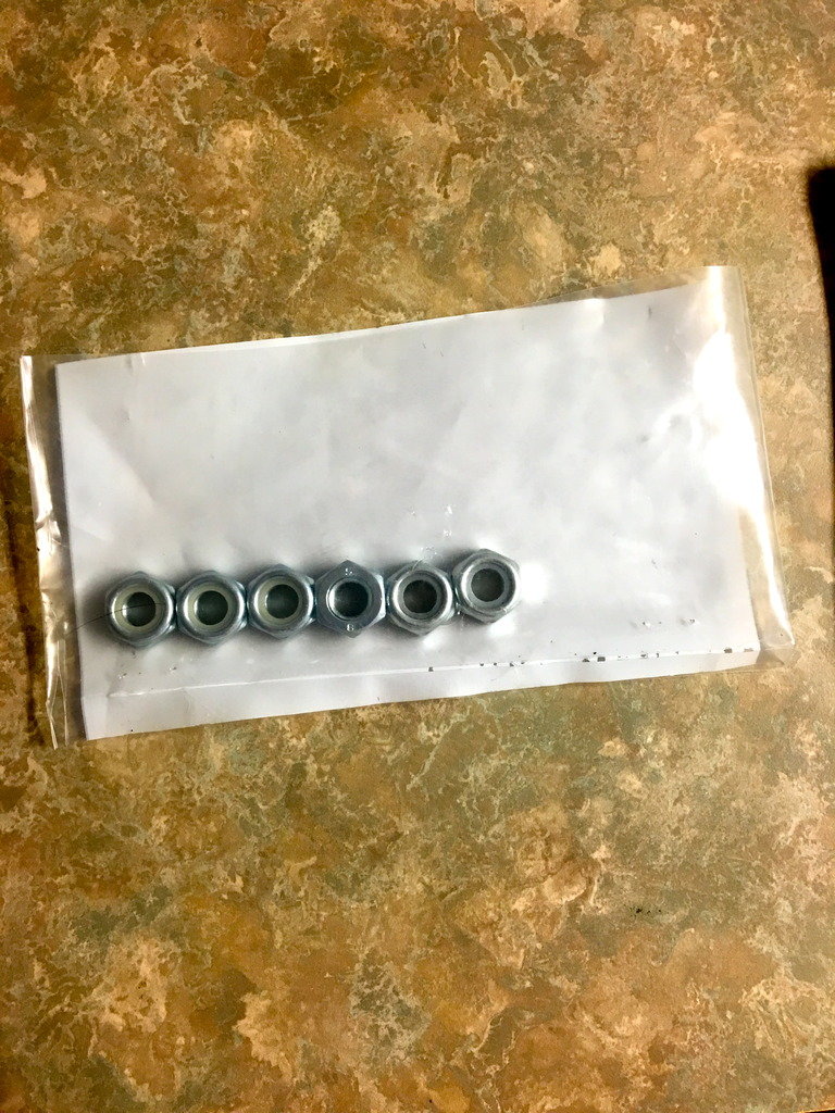

    Hey so I got the OME Lift Kit with Nitro Charger Sport struts and they had this random bag or 6 nuts... couldn't quite figure out where it played in the whole suspension swap process... any ideas?

    6 nuts, prob nuts for the top hat on front shocks

    Ah gotcha, thanks!
    Just re-used the old ones, figured it was fine since they only had 15k on them
