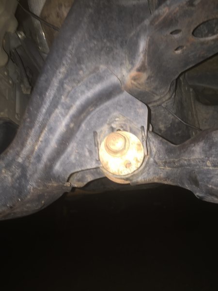

    after hearing about the body mount issues with over torquing, i wonder if the shop you used just hit the LCA bolt with a rattle gun. find somone with a torque wrench and have them do it right, it might be the cause of the issue.

    What should it be torqued to? I took it back and got the cam taps flipped up so they are no longer hanging down, and made him put a torque wrench on it. Which was wasn't going to do till I mentioned it. I told him to torque it to 130lbs, and watched him do it. This did not fix the problem however.
    Edit*
    Looks like that was a little much, this shows that it should have been to 100lbs?

    Possibly, but if you watched while the guy hit it with a torque wrench then im not sure.
