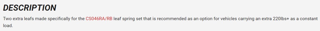

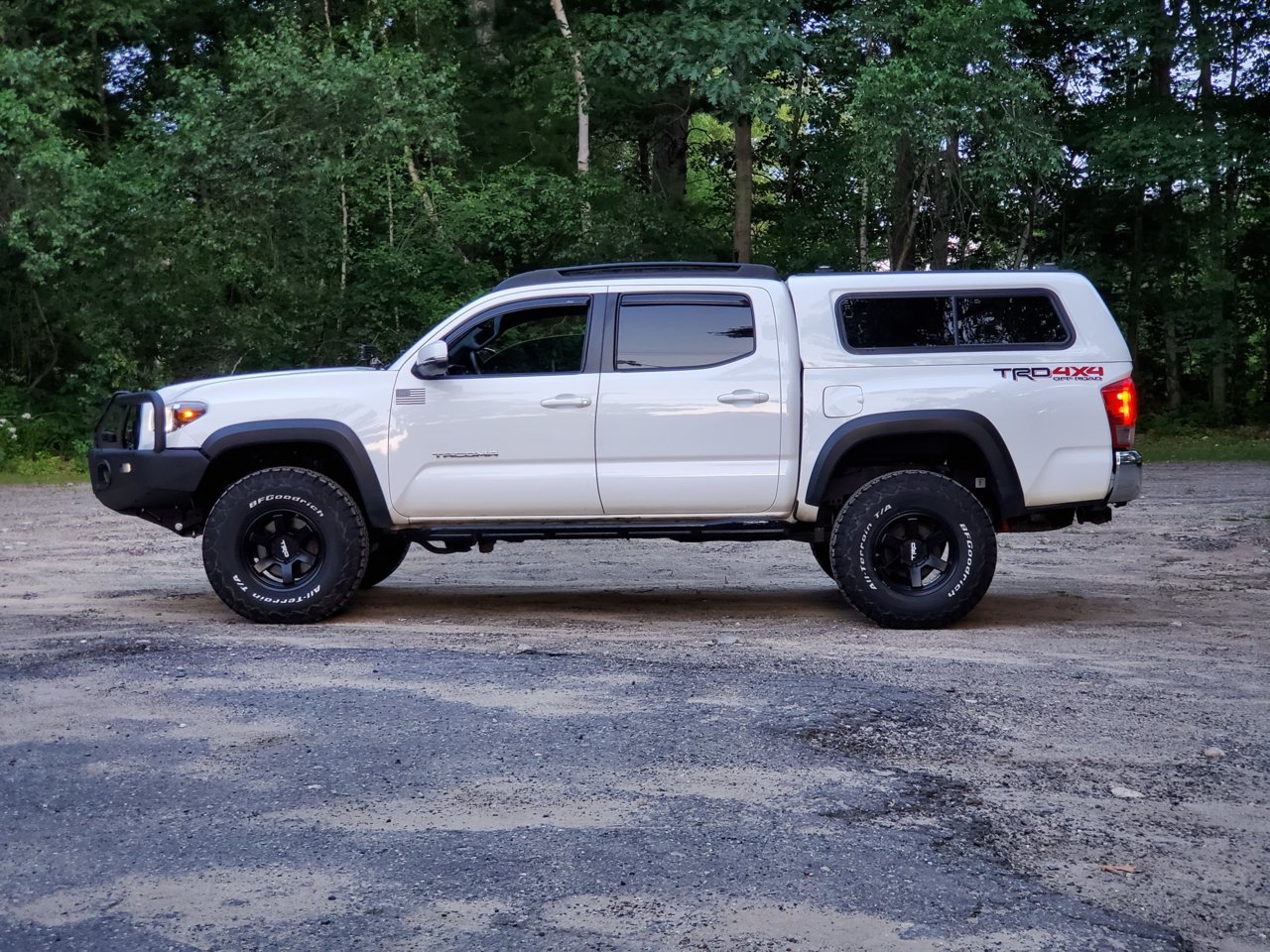

    Hi all. I have the medium duty Dakars installed in my rear and I'm about 23" in the rear hub center to fender with my bed rack and RTT. Originally I was going to live with that height, but I've noticed my leaf pack is in a 'W' shape and doesn't have a distinct arch to it. It's only been installed less than two weeks so it's only going to get worse. I'm thinking I will probably have to add a leaf to make my MD into a HD pack. Aside from from Wheeler's, what else do it need? Will I need to buy a longer center pin too? What about isolation pads? Lastly, can I install the AAL without taking the leaf completely off the truck?
  16. Aug 6, 2019 at 12:25 PM
    la0d0g
    Jan 25, 2011
    #49903
    19,910
    running for the hills
    For crawling not hauling
    Yes
    Yes
    Yes.
    kasnerd likes this.
