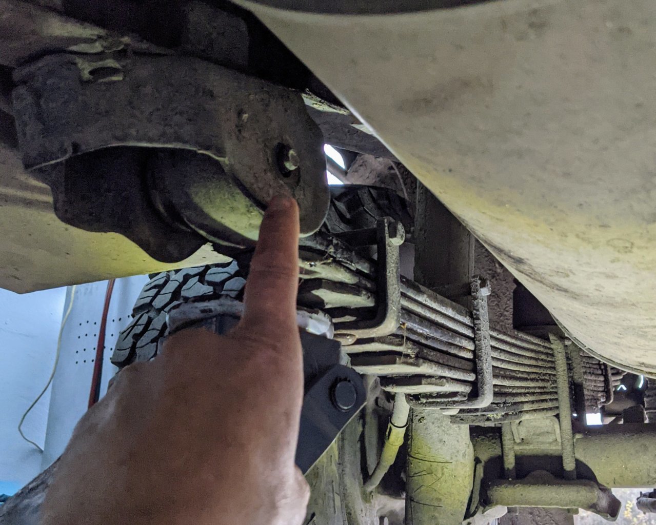

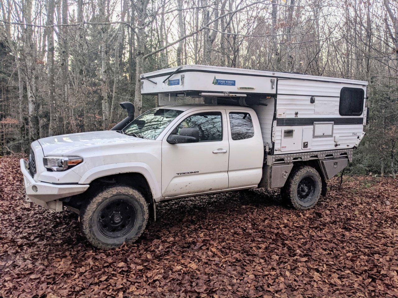

    I have a question for you all, we are running the OME BP-51s and was wondering what most appropriate compression/rebound setting would be. The passenger/driver preload is 16/19 mm. Right now both front and rear are set at the max of 10, is that the best? I'd estimate 90% of our driving is pavement, 9% graveled, and 1% off-road.
    Our truck is carrying a near-constant weight of around 7,200 lbs; 3,100 on the front and 4,100 on the rear. We have custom deaver springs on the rear as well as Hammer hanger shackles.
    The picture above shows the Deavers with a missing bolt!
    We're traveling in this full time, we're currently in Croatia
    Oh yeah, we're running 275/70/17 range E, BFG KO2 tires
    Thanks!

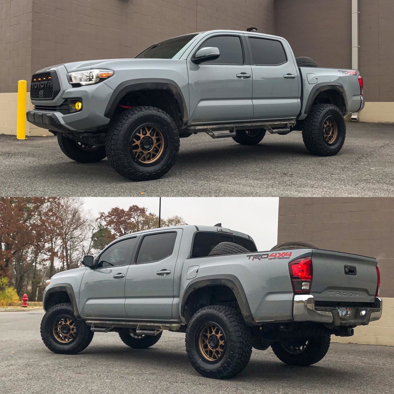

    Just a follow up on here for those interested. I went with the OME 886 front springs and EL096R leaf springs. The kit from Wheeler came with their poly bushings, carrier bearing drop, U bolts, and assembled struts. The OME UCAs were backordered until Feb 2022 so I went with JBA high caster UCAs instead (which I think was a good choice!). On stock 16" wheels and tires the front raised up 2 3/4" and the rear raised up 3 3/8". I had 285/70/17s and 17" wheels installed yesterday and the total lift with the full set up (suspension, wheels, and tires) was 4" in the front and 4 5/8" in the rear.
    For those not wanting a rake, do not get the heavy leaf springs. I plan on adding a good amount of constant weight over time so I went ahead and got the heavy leaf springs and honestly it looks fine to me. I didn't have to do any trimming or cutting in the fender well, but I most likely will find some problem areas when I take it off road.
    Very happy with the look!

    Looks great! Did you get a CMC? What were your caster numbers with the UCAs? You may want to look into hammering the pinch weld, that was a problem area for me with 285/70/17s.

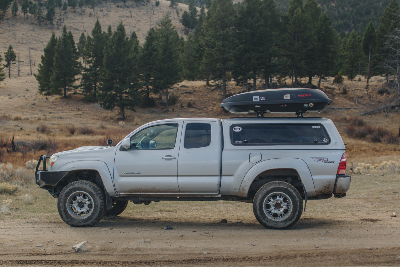

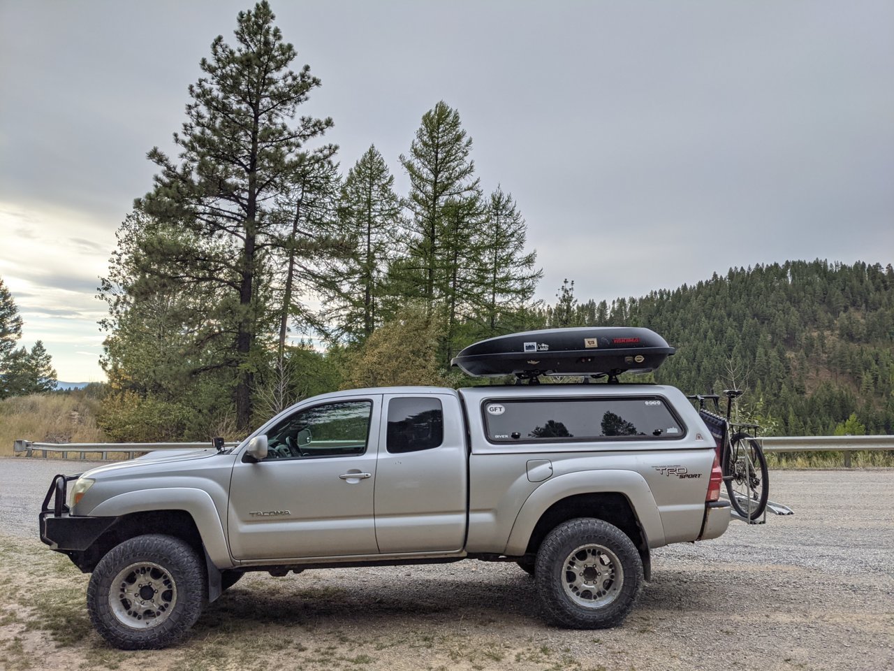

    Howdy folks!
    I have been running an OME heavy lift kit with an ARB bumper since 2016. I had initially planned on getting a winch at some point but I think that's pretty far off for me now.
    I am considering swapping out my 886 coils for 885s or 884s. Right now my truck sits pretty level with my daily driver-ish load but as soon as I toss a few bikes on the bike rack or start loading up my bed for an adventure it starts to sag quickly and I suddenly get the saggy diaper look going on so I would like to minimize that if I can. I also don't plan to run big tires any time soon so losing some lift isn't the end of the world and would probably actually improve my alignment specs and UCA angles a bit since I'm still running the stock UCAs.
    I was wondering if anyone else here had done a similar swap before?
    Pic of my truck for reference.
