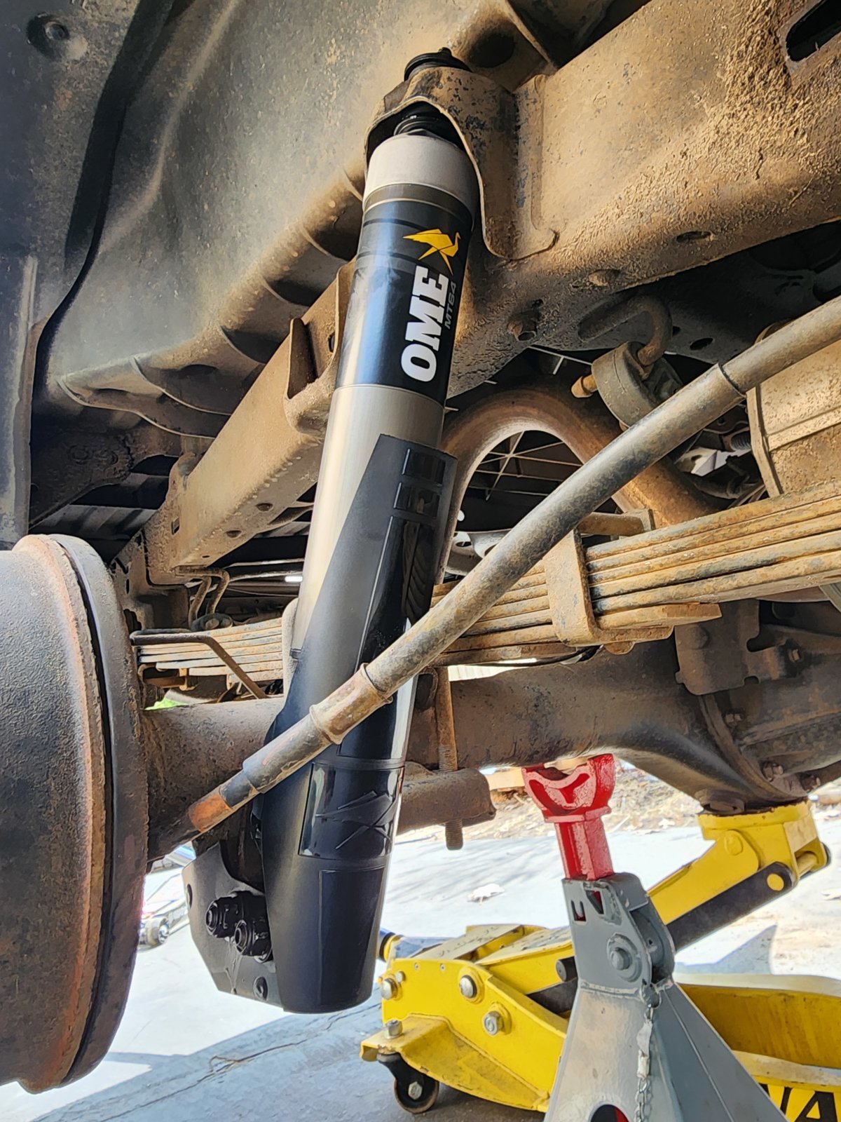

    Hey all, bumping this thread, I've seen many refer to the standard "OME clunk". Something to do with the shock internal valving? I discovered a clunk in the rear suspension when I push down on the rear bumper, or bounce on the rear bumper, of my 1st Gen. I think it's the shock, the sound appears to come from one of them, but don't know what this OME clunk is exactly...

    I’ve had a bad brand new ome rear shock that clunked. It was on the passenger rear. I switched it to the driver side rear and that side clunked. It was replaced under warranty.

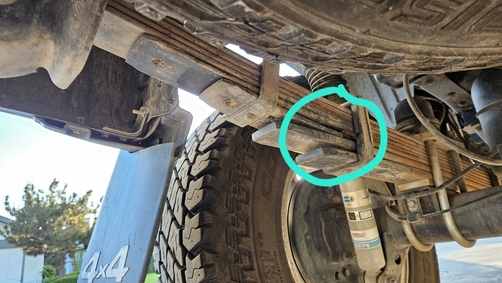

    A broken leaf...on an old pack.
    Probably replace with a new HD pack but confused about the part number, where to buy from, and how to ensure +, 0, - for the proper drivers and passenger side.
    Any information about this? Other threads aren't very current.

    The "Heavy Duty" leaf pack (EL112R)
    https://www.headstrongoffroad.com/store/p123/Old_Man_Emu_Dakar_Leaf_Packs_(PAIR)_-_ONLY_LEAF_PACKS_for_2005__Toyota_Tacoma.html
    "+" slightly higher spring rate
    "-" is for slightly lower spring rate
    "o" exactly at spec
    As the drivers side of a vehicle often has more weight, its common to use a "+" on the drivers side and a "o" or a "-" on the passenger side. Or, a "o" on the drivers side and a "-" on the passenger.
