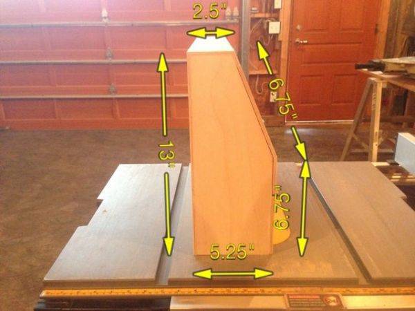

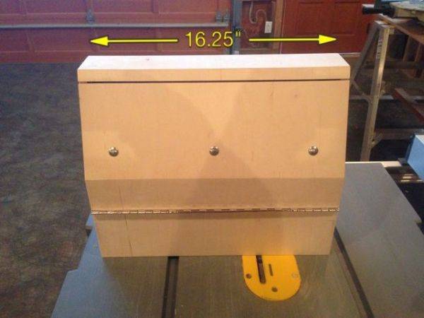

    The only reason I went with the width I did ( 16 1/4" ) was to allow enough room for the compact ARB recovery bag so that variable could change if you wanted
    Joints are half overlayed , you can see better here
    http://www.tacomaworld.com/forum/showthread.php?p=3097742#post3097742
