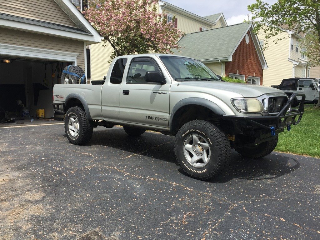

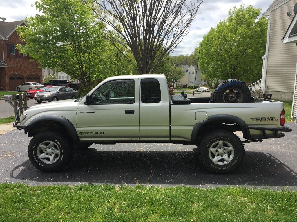

    Alright so I'm starting to look at Dakars for my rear right now. I've already got a greasable pin/bushing set running in my stock leafs (Had to press out stock bushings) and I am running the 1.25" Daystar shackle. Can I re-use those bushings? From what I am reading this combo with regular Dakars should be enough to get a good 2.5"-3" right? I've got a decent amount of weight in the rear with the spare and CO2 setup and my heavy ass tube bumper. I plan on hauling my bike every once in a while so I know when I do I will probably squat a bit but for daily use i should be a little ass high I hope.
    This is the current setup on stock leaves and 1.25" shackle.
    Front setup is 5100's with Eibach 625's.

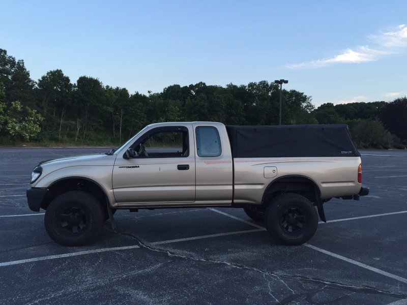

    @cynicalrider here's my truck on 33's with the Dakar springs and stock shackles. Bed is empty, no tailgate and a relatively light tube bumper.
    Front is 880s, with a3/4in spacer.
    It's definately rear end high. I can get measurements from hub to fender later is you want

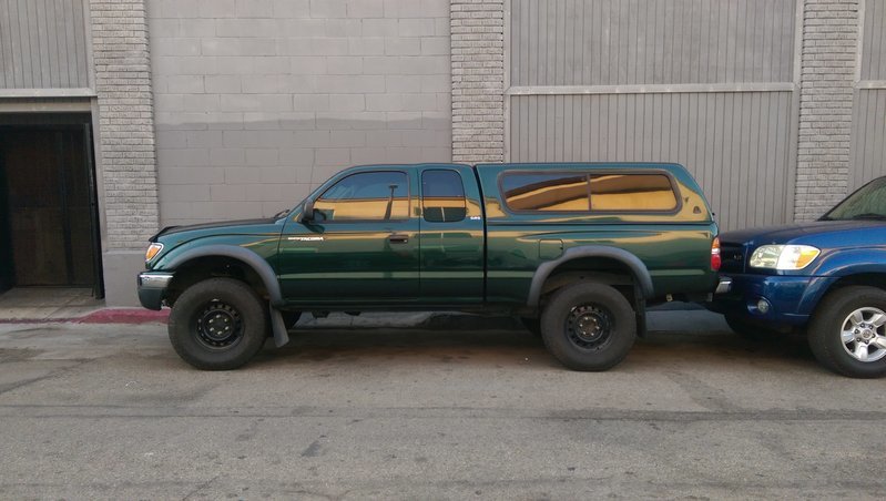

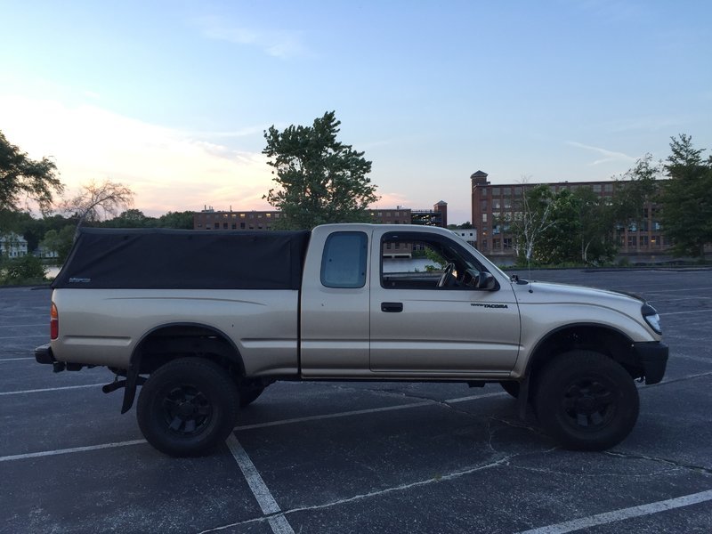

    I just got my OME setup installed. Definitely learned a lot for next time.
    Here's a few I took just after. Sitting at 2" in the front w 881 and 7" in the rear w CS019R (but probably really 4"-5" because my old sprigs were sagging like woah)
    I haven't installed my energy suspension bump stops yet. I'm planning to mount them to the frame above the leafs like some of you have mentioned a few pages back. I was about to do that yesterday but my drill wouldn't fit between the leaf springs and the frame. Guess I should've before I installed the leafs?!
    Am I going to need an angle drill?
    smirk, clickws and YotaDan like this.

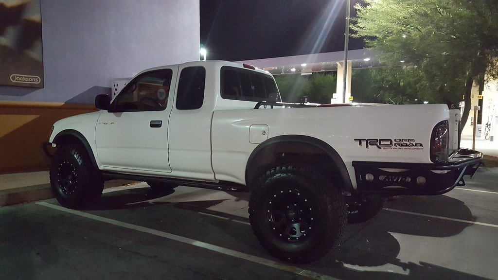

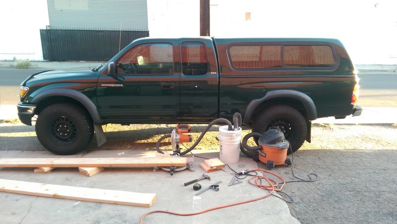

    I'll add these for the record. 2002 V6 with a full time topper, sitting on 265/70/r16 Toyo ATIIs.
    Took off stock suspension with 150k on it. Well overdue upgrade. Installed Nitrocharger sports on all corners, 881 springs, 5mm trim packer on the drivers side front, CS046R Dakar leaf packs, OME greasable shackles, extended rear brake line, exhaust hanger, and BPV relocator plate.
    Before:
    After:
    Now I'm trying not to spend more money on my truck for a little while. I'll probably upgrade to 265/75/R16s at some point. Funny thing is that my old stock suspension was so blown, that my stock size 265/70/r16 tires were rubbing the frame up front. ¯\_(ツ)_/¯ Made me much less weary about going up a size.
    Either way, I'm currently very happy with the setup. It is still breaking in, and getting better by the day. This thread was invaluable in helping me decide on what to get. Thanks!!
